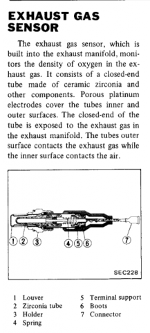

Milenko2121 Posted July 17, 2015 Author Share Posted July 17, 2015 (edited) On 7/16/2015 at 5:53 PM, NewZed said: For every person who says they get 29 there's another guy who gets 20. 20 is the most common number I've seen. That's combined city/highway though. You're running an ECU designed for a different engine, one that should have EGR, and O2 sensor feedback. Do you have an O2 sensor connected to the ECU or are you just using one for AFR readings? Is EGR functional? Are you getting any codes from the Z31 ECU? Have you checked CHTS readings to be sure they're correct? Are you using a stock FPR or adjustable or an FMU? What is fuel pressure? Did you put the system together or buy it that way? There are lots of tuning tricks you can do to increase MPG. A simple one is to reduce fuel pressure. But that will have other effects also. Engine was from an automatic so it has that cam. No EGR O2 is hooked up and functioning properly switches off at 3k rpm as well ECU Isn't throwing codes other than knock due to it not being connected. CHTS is working and functioning correctly. TPS is adjusted correctly Adjustable Aeromotive FPR set to 36 psi with hose disconnected 900rpm -19 vacuum idle. Timing set to 18btdc Cam timing is set to stock specs with a new chain(5k on it). MAF tested good and is metering air properly. Voltage sticks around 14.4v I put the entire system together. I posted tires before, 24.9 diameter inflated to 36psi all 4 corners(checked this yesterday). My speedometer is accurate +-1mph pacing my buddies 2011 Audi S4 at 65mph, GPS, and getting pulled over going 49 in a 45. Odometer I have not tested yet, but when I did my trip from Vegas to California it was around 330 miles, and my odometer was very close to this. I averaged 20mpg on the trip going 75@2800rpm for majority of the desert, and it was the same at 70@2600rpm. Let me know if you need more info. EDIT: fixed fuel pressure statement Edited July 17, 2015 by Milenko2121 Quote Link to comment Share on other sites More sharing options...

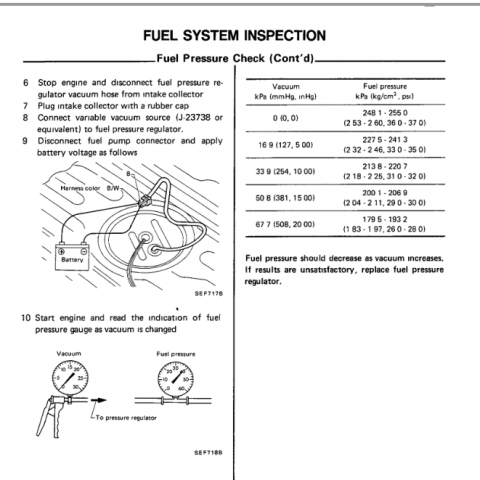

NewZed Posted July 17, 2015 Share Posted July 17, 2015 It's a start. A few observations: - 36 psi at 19 inches of vacuum is too high. Maybe you were reporting two separate things. Added a chart from the 1984 FSM. 36 is about right with the vacuum line to the FPR removed. - there are six years of Z31. Which year do you have? - You can check your odometer via mile markers on the freeway at any speed. - Extra resistance can make a difference on the CHTS circuit. "Functioning correctly" is not the same as optimized for efficiency. Always good to check the chart. Just some small things that might add up. There's also a test procedure for verifying that the O2 sensor is working right. I don't know how bad the sensor has to get before you get a code, with the early ECU's. Later ECU's like my 95 Pathfinder will tell you that the O2 sensor is bad. Might not be so in early 80's. But that's where you can lose a lot of efficiency, the ECU uses the O2 sensor to trim the fuel mixture as lean as possible. Sleeper can help you with the fine details of getting it running best since he has one. I only know generalities. Quote Link to comment Share on other sites More sharing options...

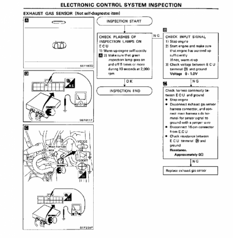

Milenko2121 Posted July 17, 2015 Author Share Posted July 17, 2015 (edited) Woops, I mean't to put -19 vacuum at idle on a separate line. Fuel pressure is 36psi with the hose disconnected. 1987 Z31 Turbo California Spec ECU (I have two, no difference swapping between either) ECU connectors are also cleaned. By functioning correctly, I meant that I had tested it according to the FSM, and it meets what FSM wants. My O2 sensor is 3 months old bosch brand OEM replacement. It passes the FSM test and my Innovate LC-2 reads ~14.5-15 under 3k RPM during cruising and ~12-11 under WOT. I'll see if I can get a better odometer test soon. Also, my method for determine MPG is I wait till near empty, fill up, write down odometer and how much gas was pumped. I use the best average over 4 fill ups (they're usually the same when I'm under similar driving) Wouldn't my engine run rich even after warmed up if my CHTS was indeed still somehow bad? Other than this MPG issue, the car runs perfect. Pulls hard (14.1@99mph with 10psi) and feels very smooth. Thanks for your help so far Edited July 17, 2015 by Milenko2121 Quote Link to comment Share on other sites More sharing options...
Milenko2121 Posted July 17, 2015 Author Share Posted July 17, 2015 Just a question, could increasing my timing to 20 or 22 btdc effect my MPG? I think I may try this. I'm running 12psi intercooled right now which based on what others on here have, seems safe. Quote Link to comment Share on other sites More sharing options...

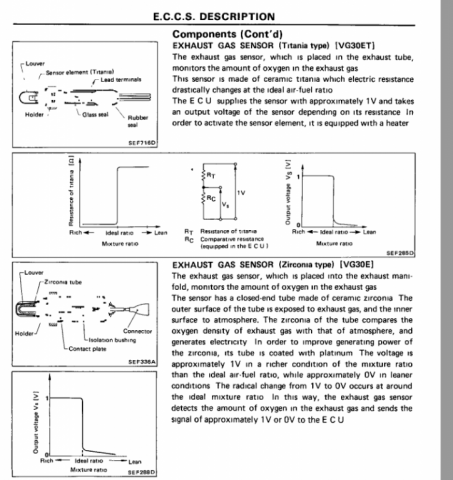

NewZed Posted July 17, 2015 Share Posted July 17, 2015 (edited) The O2 sensor still seems like the place to focus. Are you using the one for the L28ET, the VG30E, or the VG30ET? The VG30ET ECU expects a different type than the other two. Just asking. I never really know what people mean when they say they "did the test and it passed". Edited July 17, 2015 by NewZed Quote Link to comment Share on other sites More sharing options...
Milenko2121 Posted July 18, 2015 Author Share Posted July 18, 2015 (edited) On 7/17/2015 at 10:56 PM, NewZed said: The O2 sensor still seems like the place to focus. Are you using the one for the L28ET, the VG30E, or the VG30ET? The VG30ET ECU expects a different type than the other two. Just asking. I never really know what people mean when they say they "did the test and it passed". What I meant by "It passes the FSM test" I had meant the Factory Service Manual that I downloaded from xenonz31.com for my exact model car the ECU came from. This is further supported by the fact it stays around 14.5 AFR while cruising under 3k RPM(z31 ecu switches over to open loop at 3k), and goes 11-12 while under wide open throttle. The O2 sensor that I have installed in my car is the Bosch branded narrowband OEM replacement for a 1987 300zx Turbo installed at 12o'clock position. The Titania style O2 sensor. It uses a resistance rather than voltage to tell the ECU what the AFR should be. Not only does it pass the Factory Service Manual test, it also is keeping my AFR's at 14.5-15 according to my Innovate LC-2 Wideband O2 Sensor with a 2 month old Bosch O2 sensor that it came with as a kit direct from Innovate themselves. I installed O2 sensor 26" away from the turbo outlet(Innovate says 24" minimum), clocked it just before the 3 o'clock position as per Innovate's instructions, calibrated it properly according to Innovate's guide, and it has stayed consistent since I bought it. Let me know if you need more info, I tried to make it a little more clear so there's no confusion on my O2 sensors that I'm using. EDIT: I attached a copy of the test procedure from my FSM. Edited July 18, 2015 by Milenko2121 Quote Link to comment Share on other sites More sharing options...

NewZed Posted July 19, 2015 Share Posted July 19, 2015 bradyzq makes a good point. The ECI control conditions are described in the usual place, including O2. Quote Link to comment Share on other sites More sharing options...
