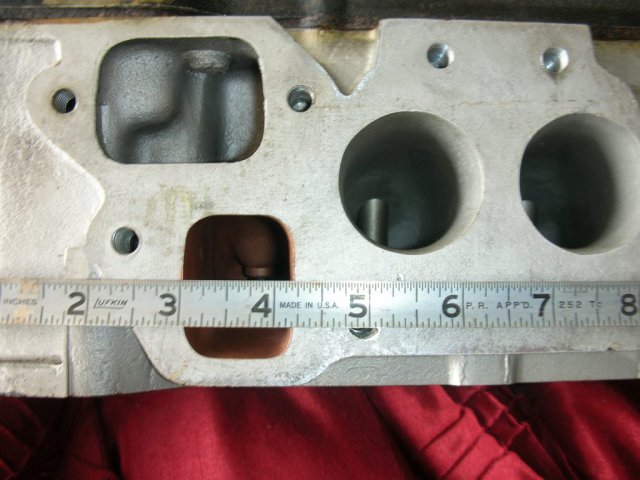

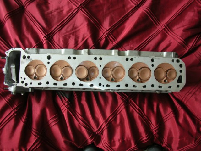

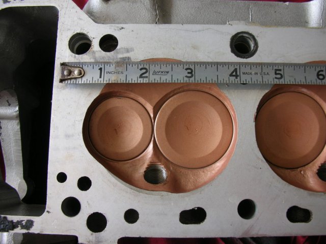

It's probably also worth mentioning I purchased a built N42 head from a member on here who claimed all the parts were kakimoto racing , and the purchased the head from Ron carter , I mean all of this could be true I really don't know anyways he wouldn't give me all the specifications on the cam or valve train , I guess that should have been enough red flags to not buy the head , anyways I did , when I passed it on to whitehead this is what they told me below about it .
Big valves have been installed. 38ex/46in . The seats and valve contact surface have been cut without a lot of margin so there's a sharp edge on the valve. This can create a hot spot that can promote detonation and it also reduces heat transfer from the valve to the seat, which can increase the chance of burning a valve. In normal use it should be okay.
There are erosion pockets in 2 of the chambers
The cam has .525" lift and likely close to 300 degrees duration. This is a full race cam and will not be street friendly.
The head has upgraded valve springs both outer and inner. We run just stiffer outer springs and stock inner springs as we find having both stiffer outer and inner tends to wipe out the cam lobes from too high seat pressure.
They have used stock lashpads and instead played with the valve installed heights to get the rocker arm geometry correct. This is not the best way to do this as changing out the cam may make selecting the correct lash pads difficult to set the new cam up with proper rocker arm geometry.
The combustion chambers spec out at 38.4cc's which is small. This will require a 2.5mm headgasket for 10.5:1 compression.
They tried fitting the head to the bottom end but got a lot of valve to piston interference so they told me its best not to use it which I didn't . So now the head is just sitting doing nothing so I'm thinking of just using the cam from it . Such a waste all the other parts .. Couple pics of the head below
