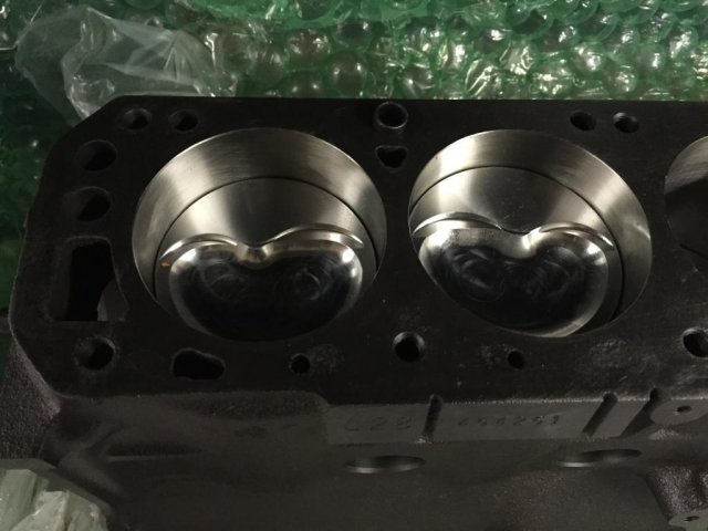

  6. Here are my nice little Rebello/JE forged turbo stroker P90 88mm pistons. The quench pads line up perfectly. According to Dave, he didn't do anything after they came from JE. I guess that if you had the design, JE would work with you on it. To give credit where credit is due, when I showed this to Jeff P, he showed me the piston design that he came up with and gave to Rebello that lead to this after some revisions. We stand on the shoulders of giants

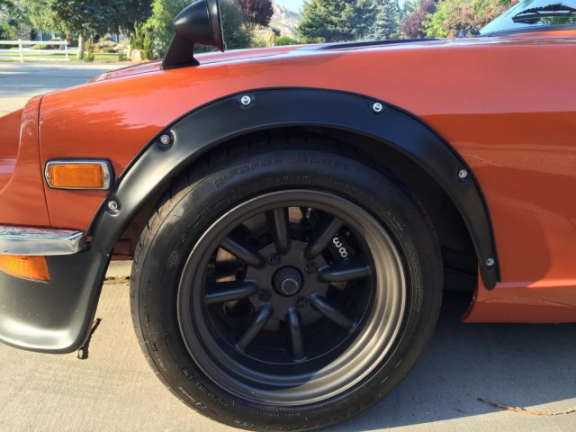

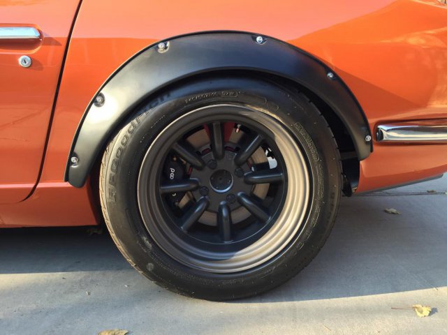

  13. Despite my previous comments of 14 months ago, I did end up spending twice the money on Wats and I have absolutely no regrets. I got 16x9 -13 front and 16x9.5 -19 rear, giving it a nice deep dish look that I love. With 225 front and 245 rear, I have about the same slight stretch as you see there. It is my opinion that those are 17" Rotas in that photo. I don't think that RKRs come in 16" but you can get a variety of offsets, and hey way more tire options for 17" rims.
