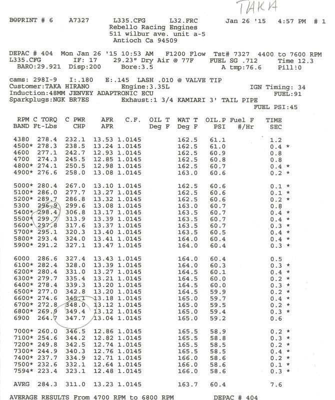

takayuki Posted November 10, 2015 Share Posted November 10, 2015 I just got the car street legal last month. Had the car for a week and had to put it away for winter. Still a work in progress but here are some video's I got of it. Sorry, none are from inside of the car... I will get that next year when the snow melts. https://www.youtube.com/watch?v=f6nu8j-ES_4 https://www.youtube.com/watch?v=cX8HypgviK0 https://www.youtube.com/watch?v=F6xe7gZPTSs Dave offered 2 different cams for this engine. One where the peak powerband is between 4400 rpms to about 7400rpms, and one that is higher... i think it was about 5000rpms to 7800rpms... I chose the 4400rpms to 7400rpms because this car will be a street machine. Dyno sheet for those that are interested. the rev limit is set at 8400rpms so it sings quite nicely. Quote Link to comment Share on other sites More sharing options...
inline6 Posted November 11, 2015 Author Share Posted November 11, 2015 (edited) I just got the car street legal last month. Had the car for a week and had to put it away for winter. Still a work in progress but here are some video's I got of it. Sorry, none are from inside of the car... I will get that next year when the snow melts. https://www.youtube.com/watch?v=f6nu8j-ES_4 https://www.youtube.com/watch?v=cX8HypgviK0 https://www.youtube.com/watch?v=F6xe7gZPTSs Dave offered 2 different cams for this engine. One where the peak powerband is between 4400 rpms to about 7400rpms, and one that is higher... i think it was about 5000rpms to 7800rpms... I chose the 4400rpms to 7400rpms because this car will be a street machine. Awesome amount of work (and money) you've got in that car of yours - I looked through a bunch of your pictures. Very nice! What kind of transmission are you running? With the standard deck height, I'm guessing you have about a 5.4 inch rod. The bore on the dyno sheet is listed at 3.5" (89 mm). So the stroke has to be 90 mm to get 3.359 L. Still looking for anyone out there with an LD28 "tall block" with similar bore and stroke but with a 6" rod... Edited November 12, 2015 by inline6 Quote Link to comment Share on other sites More sharing options...

budgy Posted November 13, 2015 Share Posted November 13, 2015 Are those #'s basically an old school bench dyno? Still impressive no matter what just curious how much this would actually put down to the tires. Quote Link to comment Share on other sites More sharing options...
