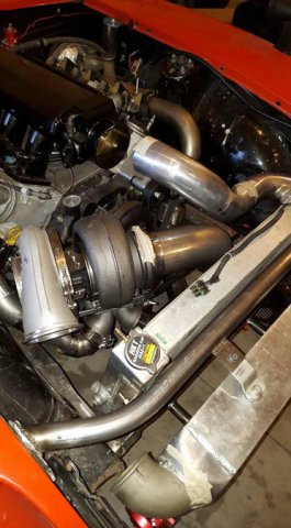

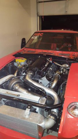

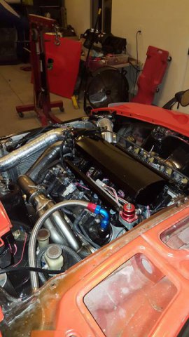

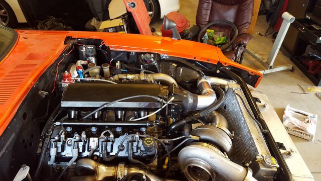

stony Posted January 16, 2016 Author Share Posted January 16, 2016 More progress. Quote Link to comment Share on other sites More sharing options...
1969honda Posted January 16, 2016 Share Posted January 16, 2016 Loving the look of the black manifold! One of these days I'm down in the SLC area I'm going to have to take a look at this monster. Nice build and please keep the pics coming. Quote Link to comment Share on other sites More sharing options...

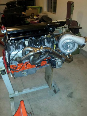

RB26powered74zcar Posted January 16, 2016 Share Posted January 16, 2016 That change up from RB to LS power is going to give you the giggles on the shake down run... Quote Link to comment Share on other sites More sharing options...

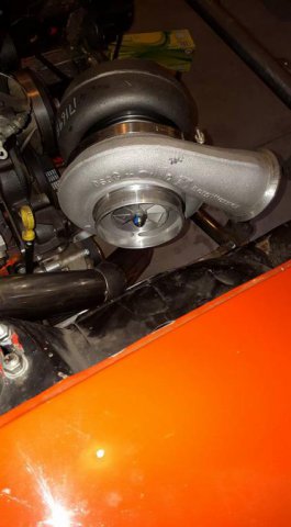

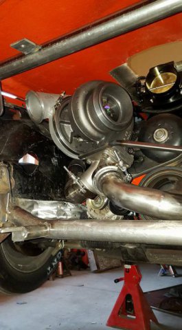

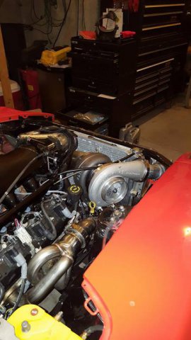

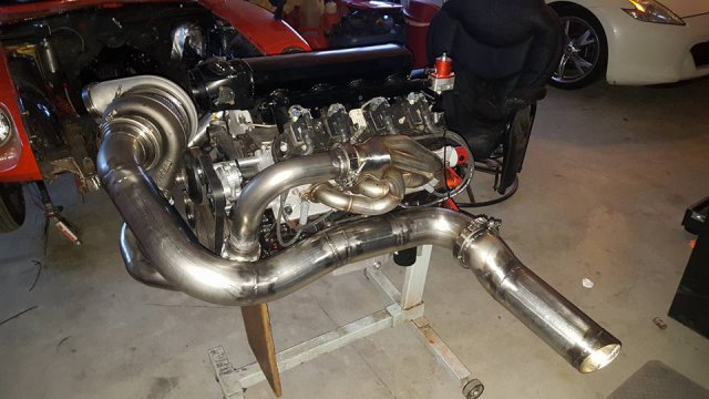

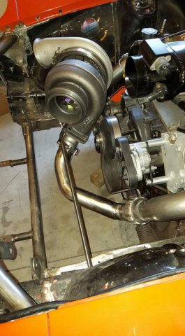

stony Posted January 22, 2016 Author Share Posted January 22, 2016 Cold side is done. now on the exhaust Quote Link to comment Share on other sites More sharing options...

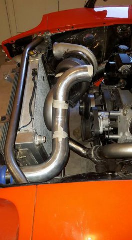

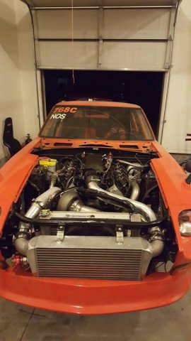

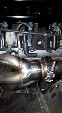

Ryan Merrill Posted February 7, 2016 Share Posted February 7, 2016 Looking great so far. I was think of doing the same thing. Who bent the bars for IC and rad support? Quote Link to comment Share on other sites More sharing options...
stony Posted February 7, 2016 Author Share Posted February 7, 2016 I did. Used a pipe bender barrowed from a friend. Quote Link to comment Share on other sites More sharing options...

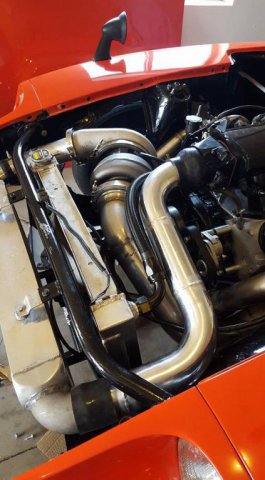

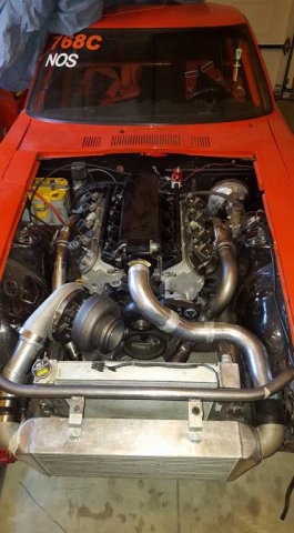

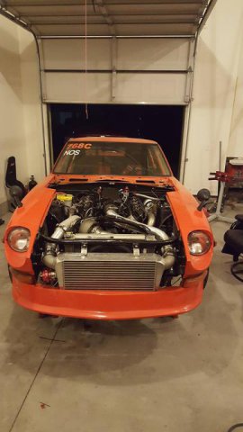

stony Posted March 2, 2016 Author Share Posted March 2, 2016 Getting there. Quote Link to comment Share on other sites More sharing options...

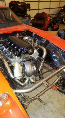

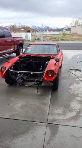

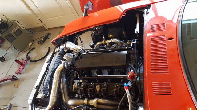

stony Posted March 25, 2016 Author Share Posted March 25, 2016 Hope to be the last time for a while with an empty engine bay. Going to scotch bright it and recoat with POR15 tomorrow. Then motor back in after I get the oil drain bung welded in the pan, hopefully for the last time for a while. Quote Link to comment Share on other sites More sharing options...

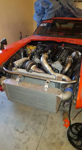

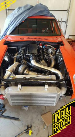

stony Posted April 9, 2016 Author Share Posted April 9, 2016 Motor and trans in for last fit checks and plumbing. engine bay painted. Quote Link to comment Share on other sites More sharing options...

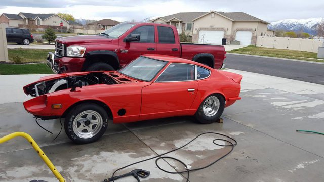

stony Posted April 28, 2016 Author Share Posted April 28, 2016 Pretty stoked. Weighed the z today and it came in at 2650 with me in it. That's exactly what it weighed wet with me in it last year. Once it's got fluids should be right around 2700. Thats with all steel and glass. I may go back to fiberglass hood and go with lexan rear window. Quote Link to comment Share on other sites More sharing options...

stony Posted May 7, 2016 Author Share Posted May 7, 2016 BTW car went 50/50 with the LS swap. It was like 52/48 with the rb setup. Quote Link to comment Share on other sites More sharing options...

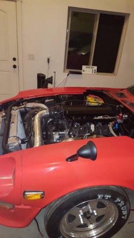

stony Posted June 21, 2016 Author Share Posted June 21, 2016 Cranked the car over and got oil pressure everywhere today. just need to team up with someone to help me with getting the infinity all setup. Other then a few clamps and bolts/hardware here the there she is back together and in final configuration, Quote Link to comment Share on other sites More sharing options...
