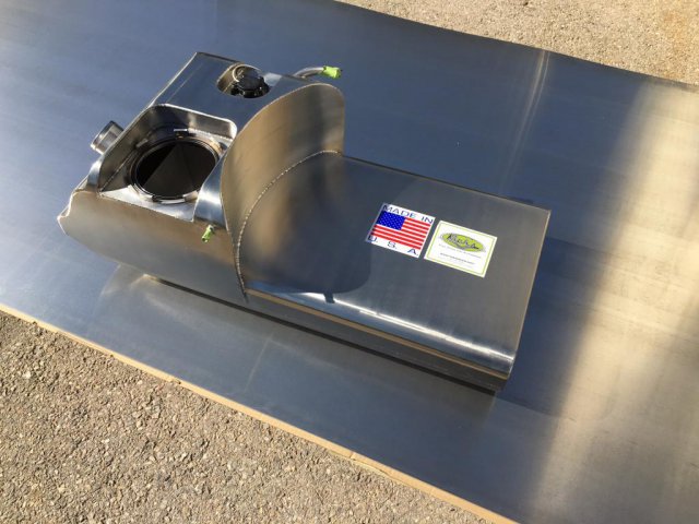

SoloRick Posted April 9, 2016 Author Share Posted April 9, 2016 Ended up going with Rick's Tanks stainless tank with in tank pump . Includes tank, choice of fuel pump, stainless straps, and tube style fuel level sender. Not cheap but it's for my baby, lol Quote Link to comment Share on other sites More sharing options...
BobsZTwins Posted May 24, 2016 Share Posted May 24, 2016 Wow! That's a great looking tank. I just modified my stock tank, installing a Airtex 99-02 F-body fuel module. Cost me about $400: module, retaining ring, AN fittings. Quote Link to comment Share on other sites More sharing options...
BobsZTwins Posted May 24, 2016 Share Posted May 24, 2016 I looked on Rick's Tanks website, didn't see anything for S30s. Is that tank intended for some other vehicle? Quote Link to comment Share on other sites More sharing options...
boyracer Posted July 16, 2016 Share Posted July 16, 2016 I looked on Rick's Tanks website, didn't see anything for S30s. Is that tank intended for some other vehicle? I called them, they want $1495 for the tank, pump, sender, straps, vents, fittings, etc. Looks beautiful and when you considered that price is for everything, really not too bad for a nice custom job. They're very friendly too Quote Link to comment Share on other sites More sharing options...
