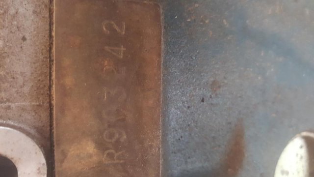

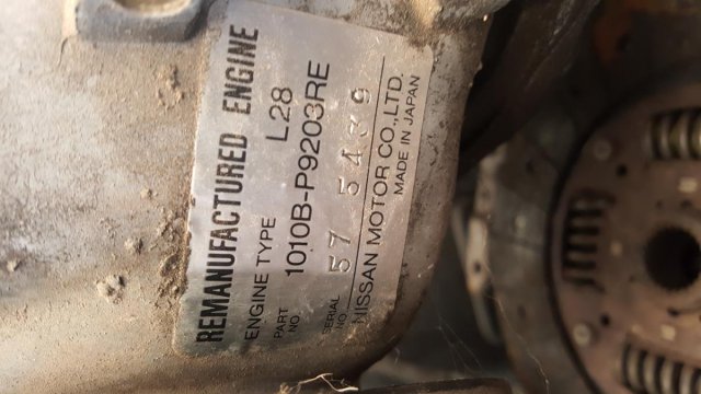

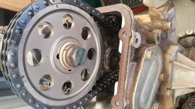

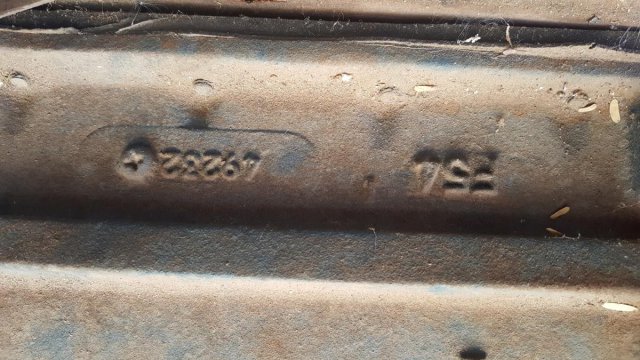

I need some help, I believe I own a time capsule. An L28 F54 block flat top pistons p79 head maybe 1981, Old new stock dealer replacement engine???? Has anyone heard of this? I have researched the engine and have only found various specification about the mechanical aspect of the engine but not any history.

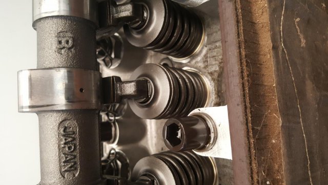

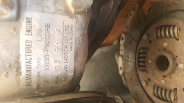

I acquired the engine from a local z collector in Tucson AZ, he explained to me that the Engine was only broken in by the manufacturer and has not been in a car. He also said that in the late 70's and early 80's Nissan dealerships sold factory engine replacements and that this engine was one of them. The engine has always sat on an engine stand indoors collecting dust, I opened up the valve cover, which revealed a pristine aluminum head with factory markings (red paint on the cam shaft ect), I presume the rest of the engine is just as clean and pristine. The man seemed very knowledgeable about Z cars and was very trustworthy, so i bought the engine (still a very nice clean L28 engine, even if it isnt a factory dealer replacement engine). I have no paper work from the dealer proving that it is a factory replacement Engine but at the front bottom of the block is a sticker which reads { REMANUFACTURED ENGINE }  and then lists identification numbers. any input would be great :) (sorry the picture is blurry, I will take better complete pictures later.)

Do you think who ever rebuilt the engine slapped on that sticker on the front of the engine?

I googled the part Number off the remanufactured sticker 1010B-P9203RE and came up with this website http://www.nissanpartsdeal.com/parts/nissan-reman-engine-as~1010b-p9203re.html I emailed the company and they told me they dont stock or have discontinued selling the engines. They had a complete Datsun Nissan dealership parts catalog uploaded onto their site. This proves that the sticker on the engine is a factory dealership part but there is no way to connect the relationship between the stcker and the engine unless i had the original dealership purchase paperwork which would have the Part serial number with the Serial number on the block. Im going to say its a Factory dealer replacement engine based on what ive found, but if not its still a great engine.
A quote from their site "Genuine Nissan Parts, the Right Choice
Your vehicle deserves only genuine Nissan parts. To ensure reliability, purchase Nissan 1010BP9203RE REMAN ENGINE AS. Our parts and accessories are shipped directly from authorized Nissan dealers and backed by the manufacturer's warranty. OEM parts are the best for restoring your vehicle to factory condition performance."
