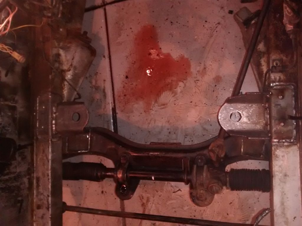

crapforum Posted August 2, 2016 Author Share Posted August 2, 2016 So things changed direction and I decided to weld in some custom mounts. Wanted to keep the stock AC compressor since when looking for one that fits my 240z LY6 swap has proven to be very pricey. I used biscuit style mounts and welded them to the frame rail, getting it as low and far back as I could. The motor is offset about 1/4" to the passenger side for a little better weight distribution. I had rebuilt the heads and swapped in an ls3 cam and valvetrain as well as an ls3 oil pan. If anyone was wondering the 07 Trailblazer had the AC compressor mount to the oil pan but luckily I had the AC compressor and mount from my LY6 handy (07 Silverado) and that bolts to the engine block. Also I have a decent bit of pan hanging below the crossmember, will try to measure it. But to the guy saying a Cadillac pan fits flush, f off, stop spreading lies. My F-Body pan is flush on my 240z and that pan is like an inch shallower than the Cadillac. In the process of working out that tranny crossmember. Think I will try to make a cradle type mount similar to what CX Racing did. Also was bummed that I cant use the CX racing headers (or so it seems). Eyeing it up on my 240z it hugs very close to the bellhousing and front of the tranny on the t56/TR6060, the 4l60e seems a bit fatter in these areas and then the tranny pan so seems it wont work. Will probably modify the stock exhaust manifolds. Quote Link to comment Share on other sites More sharing options...
