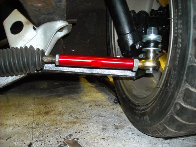

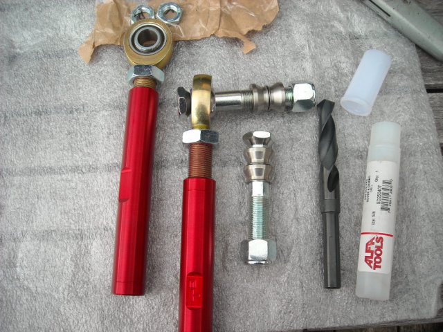

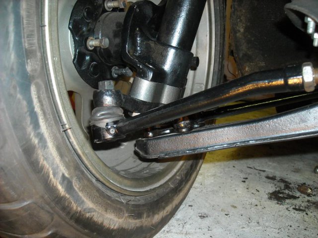

grannyknot Posted October 3, 2016 Share Posted October 3, 2016 What's up Hybrid family ! I was wondering if anyone of you guys tried Techno Toy Tuning Adjustable Tie Rod end in their 240z ? My Z will be a weekend warrior and a track car. I currently have a Mckinney coilover kit with non welding camber hats. T3 front control arms and TC rods. Im waiting to buy T3 NCR center adjusters. I tried doing some research on the T3 tie rod ends but didn't get much. Is it worth it ? I had to lower my steering rack to fit in the engine that I'm installing, without these- my bump steer was crazy, with the off set tie rods from TTT I have the bumpsteer down to couple of mm from normal driving height to fully bottomed out. Mine is an extreme case but all you are trying to do with the off set tie rods is make sure your lower control arms are parallel to the tie rods. And yes you do have to drill out the steering knuckle with the drill that comes with the tie rods. Not parallel, Parallel Quote Link to comment Share on other sites More sharing options...

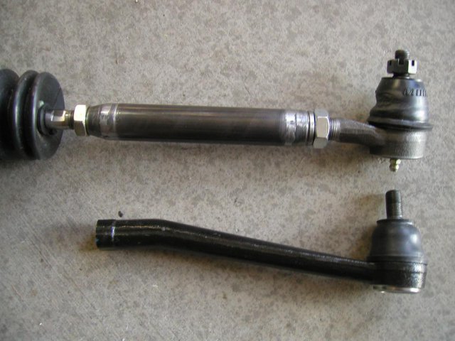

Mike Mileski Posted October 7, 2016 Share Posted October 7, 2016 I made a set of adjustable tie rods for my 240Z. Mine still had the stock, left hand and right hand threaded outer steering rack tie rods. I got two 14mm X 1.5 (LH and RH) threaded tube ends and two 5/8-18 (LH and RH) tube ends and welded them up. I found that Moog #ES323R and ES323L for 1963 - 1982 Corvettes have the same dimensionally tapered ball stud as the Datsun has, so that's why I used them (they have 5/8-18 RH and LH male threaded shanks). It's worked fine for several years. Mike Mileski Tucson, AZ Quote Link to comment Share on other sites More sharing options...

Mike Mileski Posted October 19, 2016 Share Posted October 19, 2016 Actually, I couldn't find them either so I bought two 1/2-20 tube ends and drilled them out with a 1/2" drill because, conveniently, that's the tap size for a 14mm X 1.5 thread. Then I just threaded them for whatever inner tie rod threads you have (in my case, one was LH and one was RH. If you've had your LH inner tie rod replaced on your steering rack with a RH one, then you would need two LH thread Corvette outer tie rods and two RH 14mm X 1.5 tube ends). Mike Mileski Tucson, AZ. Quote Link to comment Share on other sites More sharing options...
Mark N Posted November 24, 2016 Share Posted November 24, 2016 I had to lower my steering rack to fit in the engine that I'm installing, without these- my bump steer was crazy, with the off set tie rods from TTT I have the bumpsteer down to couple of mm from normal driving height to fully bottomed out. Mine is an extreme case but all you are trying to do with the off set tie rods is make sure your lower control arms are parallel to the tie rods. And yes you do have to drill out the steering knuckle with the drill that comes with the tie rods. DSCN0510.JPG Not parallel, DSCN0465.JPG Parallel DSCN0514.JPG I have a set of these waiting to be fitted and assumed that the machined spacers were fitted above and below the Heim/Rose joint, forming a continuation of the ball. Quote Link to comment Share on other sites More sharing options...
