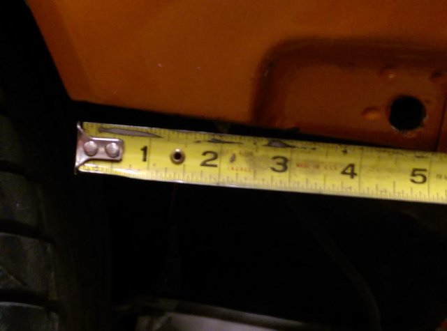

Hi fellow Z enthusiasts. So I messed up somewhere along the way, but the 3-piece valance set I bought a while back for my 73 240z is not fitting flush with the fenders (please see pictures attached). Were there different dimensions on these?? Maybe the guy who sold them to me said they were for a 240 but they are actually for a 260? Confused here. Just want to know what went wrong. Thanks in advance
Don't have dimensions on me. Wish I had them. The car is at a shop that is a bit far from me. I really can't put a finger on the explanation though..looks like the valence corner is not long enough but it clearly has the same form of an OEM 240 one. When I purchased it I removed it straight from a 240. I didn't study the donor car too much though..
My car is a 72 240z. The valance was obtained from another 240z built 12/70 (I took it straight off of the car, and it lined up perfectly with the fenders on that car). The fenders I got at another time from a different seller (no idea from which car). I understand ALL fenders among 240s, 260s, 280s are interchangeable.
So STILL confused here @_@

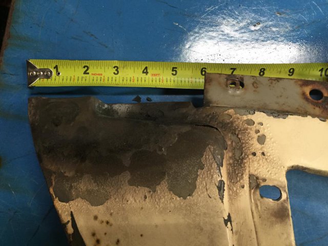

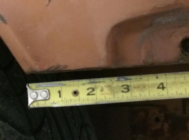

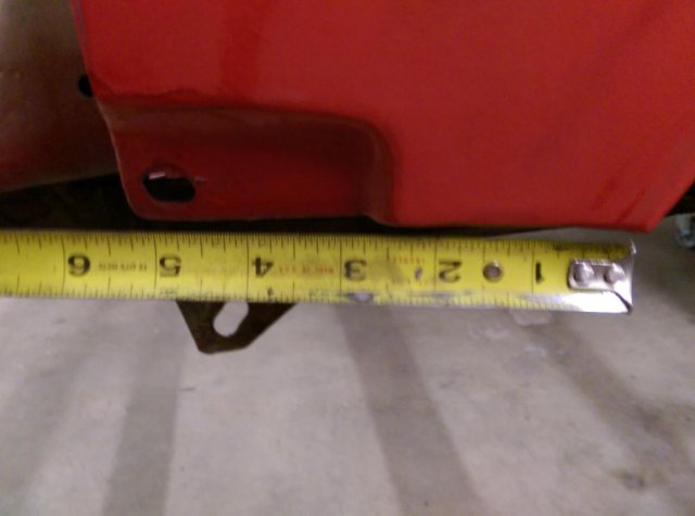

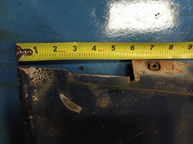

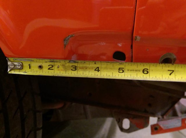

1976 (01/76) 280Z
1973 (07/73) 240Z
1971 240Z (this car is from Switzerland)
Series 1 - 1970 240Z
These are all cars I currently have in the shop and I am certain that the 1976 and 1973 fenders are original to the car.  I believe the 1971 (Swiss) is original to the car but I haven't verified.  The 1970 - I have no idea if that fender is original.  I also have a couple of 1972's here but I didn't bother taking pictures because the fenders are all the same.  I don't have any "late" Z's (77-78).
I also have several valences here - including the Swiss "no cutout for turn signal lense" pieces.  (Switzerland apparently didn't allow turn signals under the bumper.  The turn signals on this car were mounted on top of the front bumper.)
