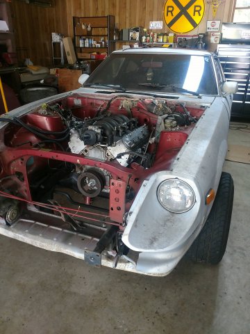

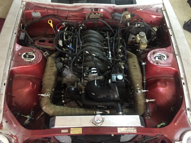

Hey guys/gals, I'm not new to hybridz or zcars I just haven't posted before.  This is my 1980 280zx.  It has recirculating ball steering (Ew), stock r200.  The Exhaust was run the way it is because I didn't want to make headers right now.  I also plan to boost the car later anyways.
Engine: genIV 5.3 iron block with flat top pistons, 243 heads, ls1 intake, arp head bolts, DOD delete etc.  The mounts are Jags That Run SBC mounts with SBC to LS adapters.  The oil pan is a mast motorsports low profile pan.  The car is now tuned for speed density so there's no MAF either.
Trans: Z32 5 speed, Gforce adapter plate/flywheel, southbend clutch rated for 450lb-ft, xcessive  short shifter bracket and short shifter.  Tranny mount is custom
Suspension: s13 BC Coilovers. S13 front knuckles, brakes, calipers, etc. Stock rear brakes.
Any questions feel free to ask and I'll answer the best I can!  Car now runs and drives, most of the pictures aren't up to date and I've tried to clean up a good bit of it.
