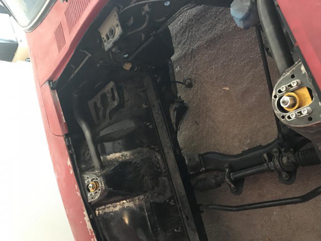

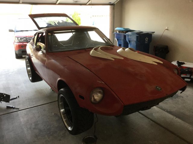

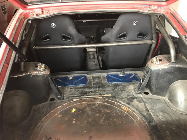

bigwillie67 Posted December 21, 2016 Share Posted December 21, 2016 Hey, I've been lurking at builds here and other sites and picked up great tips. Chassis is all done, full length connectors, seams welded 8 pt cage, T3 coilovers and suspension. Needs brakes, diff, ( I have the upgraded stub axles and companion flanges, and cv axles). What motor mount kits do you guys favor? CRX, Hokeperformance, Dirty Dingo, Hawk Motorsports or JTR? Quote Link to comment Share on other sites More sharing options...

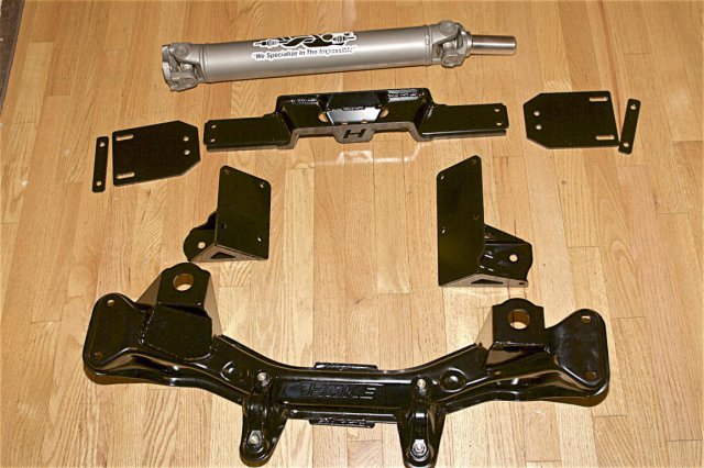

grretc Posted December 21, 2016 Share Posted December 21, 2016 I'm a huge fan of Hoke Performance. I don't have his LSx mounting kit, but if I were to do this swap, I would buy his kit. Hoke Performance has always been very professional in doing business, and I've only heard great things about his products. No doubt this would extend into his LSx kit. Quote Link to comment Share on other sites More sharing options...

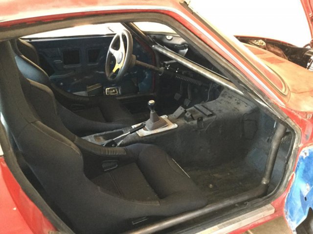

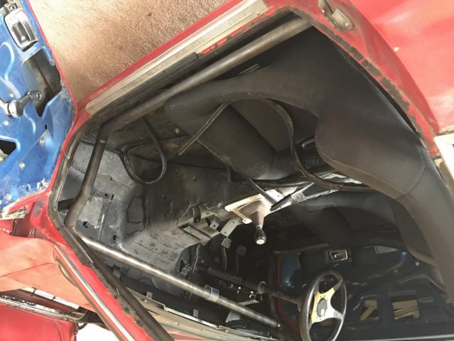

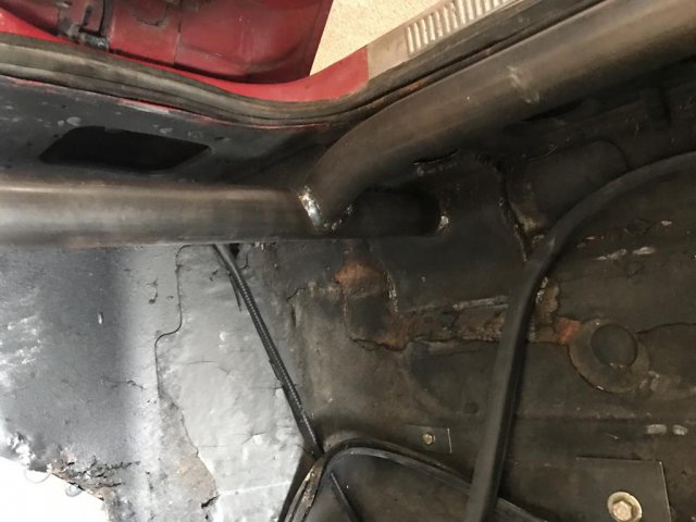

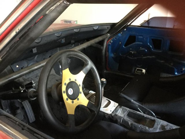

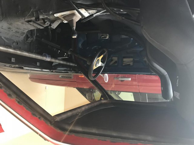

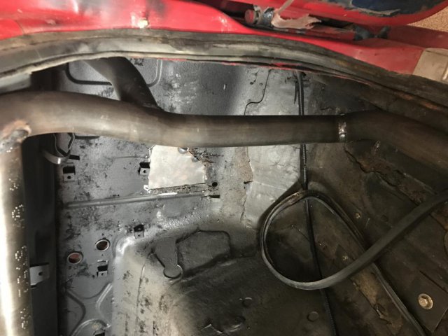

rturbo 930 Posted December 21, 2016 Share Posted December 21, 2016 I've never bought anything from Austin Hoke but having seen how he does things, I wouldn't hesitate to buy his product. As for your cage, I don't see any kind of triangulation. You'll need to do something about that. Quote Link to comment Share on other sites More sharing options...
bigwillie67 Posted December 21, 2016 Author Share Posted December 21, 2016 Turbo 930 you are correct, I needed to have the seats in first to check clearance. I love my seats but I'm going to have to go to a smaller JAZ seat. Hoke's look like quality pieces but I've yet to see a trans mount I'd call perfect. Most likely due to the variations in the S30 chassis through the years. Appears the CX long tubes are recommended by many, even other LS swap builders. Quote Link to comment Share on other sites More sharing options...

30 ounce Posted December 23, 2016 Share Posted December 23, 2016 Received my Hoke Performance mounts today. Very impressed! Definitely a no compromise way to install the LS1/T56. Quote Link to comment Share on other sites More sharing options...
bigwillie67 Posted December 23, 2016 Author Share Posted December 23, 2016 Received my Hoke Performance mounts today. Very impressed! Definitely a no compromise way to install the LS1/T56. Please give a review after your install. I'm curious about if any trans tunnel mods are required. What model S30 do you have? I have a 71 and noticed my factory transmission "wing" mounts are removable. Not sure if they were on all models. Quote Link to comment Share on other sites More sharing options...

Stock Car Mafia Posted December 27, 2016 Share Posted December 27, 2016 Do you mind sharing more pictures of your cage? This is one of the next steps on my to do list. Quote Link to comment Share on other sites More sharing options...

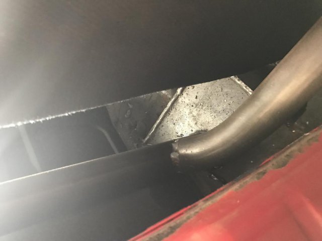

bigwillie67 Posted December 29, 2016 Author Share Posted December 29, 2016 Do you mind sharing more pictures of your cage? This is one of the next steps on my to do list. I definitely will once I get home I'll snap some pics. It's an 8 point cage tying the front and rear shock towers together. Stands had to be made on the floor pans as the metal is super thin. I also have full length frame connectors which I purchased but if I'd do it again I'd make my own. Quote Link to comment Share on other sites More sharing options...

Stock Car Mafia Posted December 29, 2016 Share Posted December 29, 2016 I definitely will once I get home I'll snap some pics. It's an 8 point cage tying the front and rear shock towers together. Stands had to be made on the floor pans as the metal is super thin. I also have full length frame connectors which I purchased but if I'd do it again I'd make my own. Thanks I definitely want to see what you did. Was it a prefabbed cage or did you bend and build it yourself? I went with the Hawk's motor and trans mount. Honestly, they are a solid piece, but it takes a lot of fabbing to get it to work. The motor mounts fit his Hawk's (American Racing) headers. I had to notch the frame to weld on the mounting plates, and then the mount that connects the crossmember to motor to frame had to be cut to make it look aesthetic. The trans mount was a chore. It had to be tacked to the thin trans tunnel but was fulled welded on the frame from below. I'm not sure what you want to spend, but if I did it again, I would have just made my own mounts. Most of the details are in my build thread. Quote Link to comment Share on other sites More sharing options...

bigwillie67 Posted January 2, 2017 Author Share Posted January 2, 2017 (edited) Do you mind sharing more pictures of your cage? This is one of the next steps on my to do list.The metal on these cars are super thin. I have no idea how any S30 survives 300ftlbs of torque and doesn't twist up like a soda can. Even the welds on the subframe to suspension attachment points look suspect. Any choice you make as far as a cage choose your seats first, get in a driving position and measure. If you drive on the streets without a helmet you don't want to bang up any body parts in the even of a accident or roll over. Door bars just won't work with the seats I have, not even swing outs. My car will be mostly street driven with some occasional auto cross or drags. Can't believe I've got 10k in this car already with no engine trans fuel system brakes or chassis harness. 2 years of pushing it around my small garage. Edited January 2, 2017 by bigwillie67 Quote Link to comment Share on other sites More sharing options...
