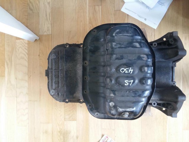

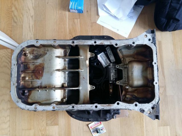

fila Posted May 14, 2017 Author Share Posted May 14, 2017 I finally manage to found rear sump but its from 3uz (LS 430). I have read somewhere that they are interchangeable with SC400 sumps. Can you please take a look and tell me if its the right one or should I continue searching? Quote Link to comment Share on other sites More sharing options...
CArFAn Posted May 14, 2017 Share Posted May 14, 2017 That appears to be the correct one. Remember the studs on the block will have to be changed ou,t you will see what i mean when you try to put the pan on the block. i will try to get some pictures of the motor mounts later tonight when i get home. I need to get back to working on mine its been awhile. Quote Link to comment Share on other sites More sharing options...

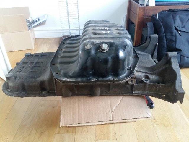

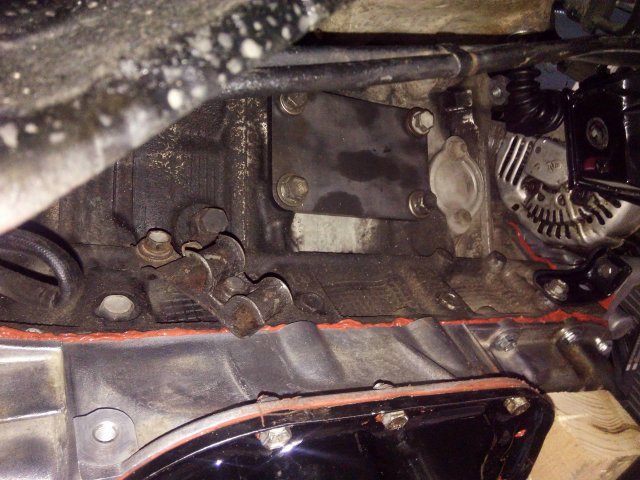

RUSSJZ-ZED Posted July 7, 2017 Share Posted July 7, 2017 (edited) Here's a couple of pic's of sumps that might help. first 2 are differences between a 1UZ and 3UZ (1UZ on left in first picture.) other 2 are comparing a front and rear from a 1UZ 3UZ is a much better engine , 4.3 litre Vvti (You will only need the "1uz stronger rods" if you are planning an all out race car with Nurnburg ring level power- 600HP plus, supercharged, turbos etc. etc. ) The rods are swappable into the 3UZ if you are really pedantic , 3UZ extra capacity was bigger bore. if you are not building an all out race/track car,Stick with the 3UZ Earlier 4.0 engines are getting harder to get parts for as well, dizzy being one of them. . I put a 3UZ into a 928 Porsche, brilliant engine, Better engine than Porsche used , makes same power as the 928GTS- but reliable plus economical, and don't have to talk to Mr. Porsche for parts. (Plan was to put one into a 280ZX , lost interest) The ECU you mention that was modified by "someone" in Russia, was probably done by George in Moscow, A wiring Genius, you can find posts by him on toymods site. an Australian Toyota modification site, search George 3UZ you will find him, ( I can't seem to post a link here)He is one of 3 people that really do know what they are doing with 1-3UZ ECU's. One here in Australia, (Sideshow,alias Dumbass on the Toymods site) and another guy in New Zealand George can also be found on LEXTREME a Toyota/Lexus V8 engine swap/modification site, Heaps of information there if you are planning a UZ conversion, site has been quiet for a few years, but all the information is there. Edited July 18, 2017 by RUSSJZ-ZED Quote Link to comment Share on other sites More sharing options...

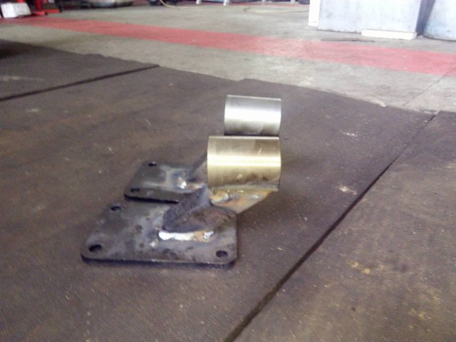

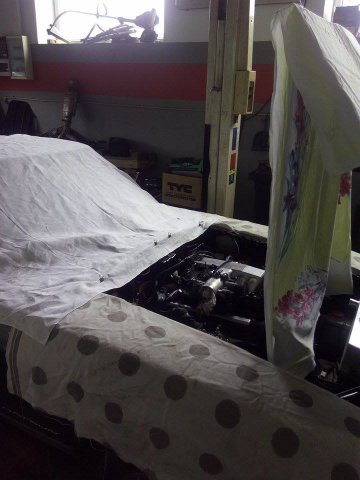

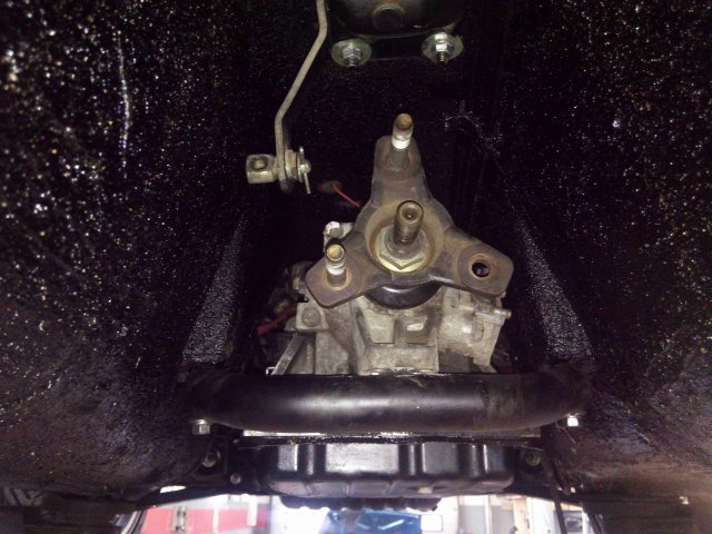

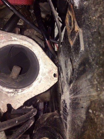

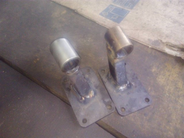

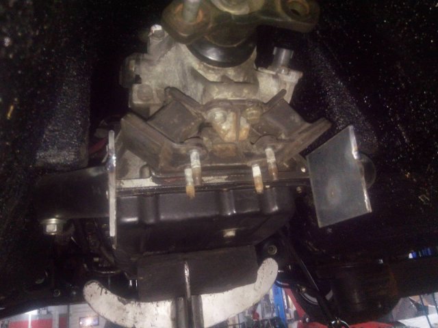

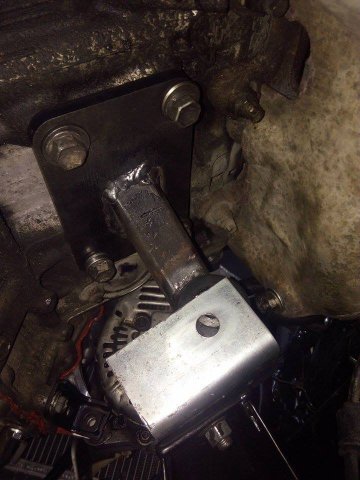

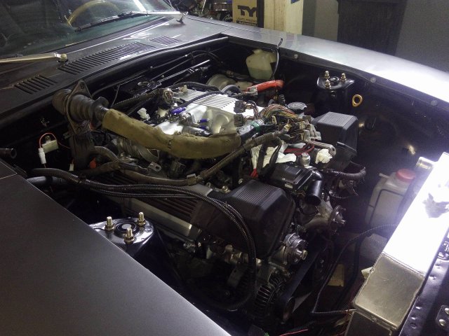

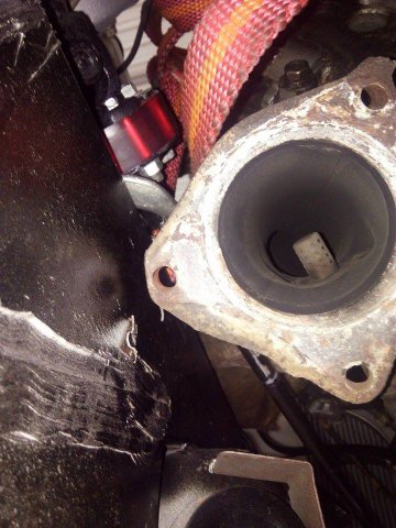

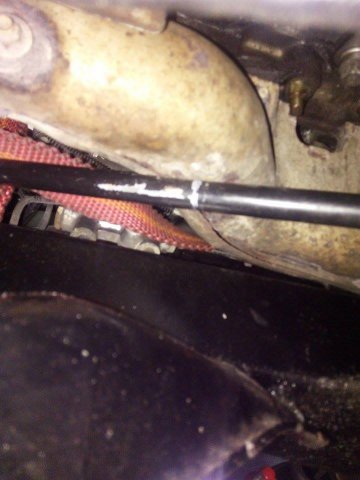

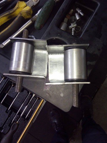

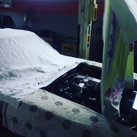

fila Posted October 27, 2017 Author Share Posted October 27, 2017 Here are some photos from my swap and of engine mountings. All is done by my colleges as I don't have enouh place in my garage. Quote Link to comment Share on other sites More sharing options...
