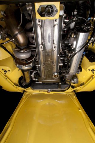

Casper0878 Posted April 18, 2017 Author Share Posted April 18, 2017 (edited) One is a complete kit, the other is just the mounts. I really didn't like the CX racing ones. They push the motor a good two inches to the passenger side and makes the motor sit tilted by a good inch and a half look really carefully at their pictures. Yeah my buddy sent me pics of his engine as it sits and you are right, it is a bit off to the passenger side. I saw pics of the yellow 240Z that Tech2 built for SEMA a few years ago and it seems to be perfectly centered, at least compared to the hood latch mechanism. Can't tell from the pic if it sits further back or not. Edited April 18, 2017 by Casper0878 Quote Link to comment Share on other sites More sharing options...

seattlejester Posted April 18, 2017 Share Posted April 18, 2017 Its hard to pick out, but yea you can definitely see it skewed once you start using frames of reference for the cx kit. The problem is that there isn't much room for the turbo and more importantly the exhaust when you offset the motor like that. I fabricated my exhaust so it isn't visible when you look under the car, with the engine sitting where it wants to sit and shifting over the transmission you loose a lot of real estate for exhaust. With it centered again I was able to reuse my exhaust. The breaking point purely on price is whether you have access to a drive shaft shop/fabrication shop. If you want a bolt in kit the tech2 kit is very comprehensive includes the drive shaft and shifter relocator if I'm not mistaken, Ryan will have to verify. On fitment I really don't think the CX kit is very good. With a few tweaks it could be much better. I will also say that I needed to hammer the mount to get it to even trial fit, and working with stainless is really difficult for your home mechanic, I blew through probably 4 or 5 bits trying to drill a new hole using oil and going really slow. Getting my mig setup to weld the stainless was also expensive ~$100. Quote Link to comment Share on other sites More sharing options...
Casper0878 Posted April 18, 2017 Author Share Posted April 18, 2017 Its hard to pick out, but yea you can definitely see it skewed once you start using frames of reference for the cx kit. The problem is that there isn't much room for the turbo and more importantly the exhaust when you offset the motor like that. I fabricated my exhaust so it isn't visible when you look under the car, with the engine sitting where it wants to sit and shifting over the transmission you loose a lot of real estate for exhaust. With it centered again I was able to reuse my exhaust. The breaking point purely on price is whether you have access to a drive shaft shop/fabrication shop. If you want a bolt in kit the tech2 kit is very comprehensive includes the drive shaft and shifter relocator if I'm not mistaken, Ryan will have to verify. On fitment I really don't think the CX kit is very good. With a few tweaks it could be much better. I will also say that I needed to hammer the mount to get it to even trial fit, and working with stainless is really difficult for your home mechanic, I blew through probably 4 or 5 bits trying to drill a new hole using oil and going really slow. Getting my mig setup to weld the stainless was also expensive ~$100. Yeah the Tech2 kit includes all of that but only if I decide to go with an R154 transmission. I was thinking of going with the Nissan 350z CD009 tranny instead so I would only need a partial kit from Tech2, just the stuff to mount the motor, which they quoted me at $1,250. Seems like it should be a bit cheaper since they are taking out the driveshaft along with the transmission mount. I thought more like half price but it is what it is. Quote Link to comment Share on other sites More sharing options...

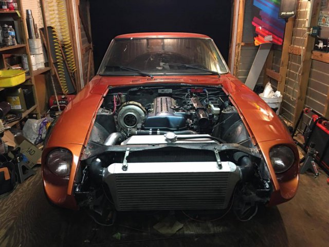

Nelsonian Posted April 19, 2017 Share Posted April 19, 2017 (edited) The offset of the engine favoring the passenger side from the CX mounts as mentioned, is a major consideration as exhaust manifold, turbo placement and down pipe all would be affected. I think there are few options as it stands for pre made exhaust manifolds that fit within the S30 engine bay space. A few pics of the previous owners (Whom I bought my Tech 2 kit from) car with the cross member in, as well as my complete kit with driveshaft, and lastly more Tech 2 shop car with Engine placement and kit in.... Edited April 19, 2017 by Nelsonian Quote Link to comment Share on other sites More sharing options...
Casper0878 Posted April 19, 2017 Author Share Posted April 19, 2017 The offset of the engine favoring the passenger side from the CX mounts as mentioned, is a major consideration as exhaust manifold, turbo placement and down pipe all would be affected. I think there are few options as it stands for pre made exhaust manifolds that fit within the S30 engine bay space. A few pics of the previous owners (Whom I bought my Tech 2 kit from) car with the cross member in, as well as my complete kit with driveshaft, and lastly more Tech 2 shop car with Engine placement and kit in.... Yeah even if only slightly, it still gives me less room to work with. Plus I have OCD and seeing the engine off centered would drive me nuts lol Quote Link to comment Share on other sites More sharing options...
