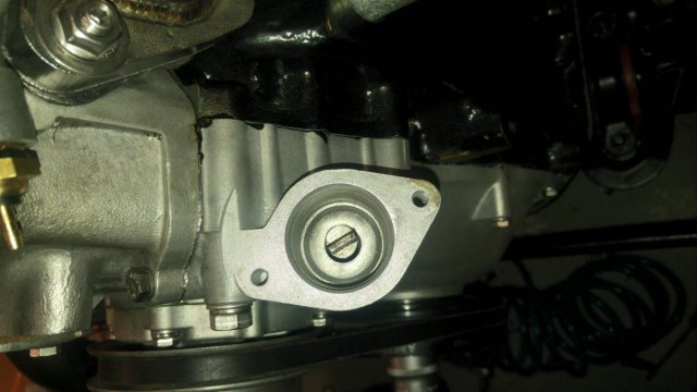

Ssaga Posted June 2, 2017 Share Posted June 2, 2017 (edited) I have almost same problem.Have double, trippelchecked everything. Cam and crank at TDC, distributor spindle at 11:25, can't reach within scale for timing. Also tried to change a notch on the spindle by lowering the oilpump. Still not possible to reach within scale. However the difference when changing notch on the spindle is that the timing goes from excesive retard to excessive advance. My next thought is that the mechanic advanced springs are old and worn, letting the weights spin out to easy. Pictures show the spindle positions I tried. Edited June 2, 2017 by Ssaga Quote Link to comment Share on other sites More sharing options...

Spooky_Intentions Posted June 2, 2017 Author Share Posted June 2, 2017 On 6/2/2017 at 10:25 PM, Ssaga said: I have almost same problem.Have double, trippelchecked everything. Cam and crank at TDC, distributor spindle at 11:25, can't reach within scale for timing. Also tried to change a notch on the spindle by lowering the oilpump. Still not possible to reach within scale. However the difference when changing notch on the spindle is that the timing goes from excesive regard to excessive advance. My next thought is that the mechanic advanced springs are old and worn, letting the weights spin out to easy. Sorry to hear that, this is a most frustrating experience. I went off of "pointing at the hole" by a friends recommendation so i think my oil pump may not be situated properly. I will be checking that as well. I wish you luck! Quote Link to comment Share on other sites More sharing options...

Spooky_Intentions Posted June 6, 2017 Author Share Posted June 6, 2017 Hey everyone, sorry that i have not updated this thread. The issue in the end was that my oil pump was in fact 1 tooth off! It looked to be more set to the 11 oclock position rather than the 11:25. Thank you all for your help! Quote Link to comment Share on other sites More sharing options...
