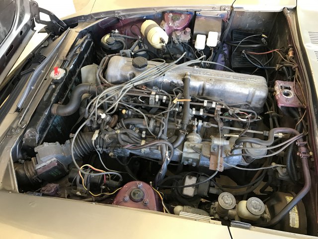

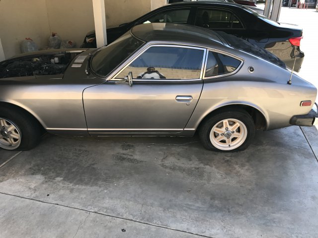

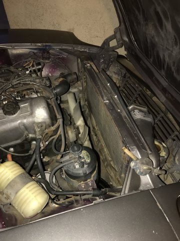

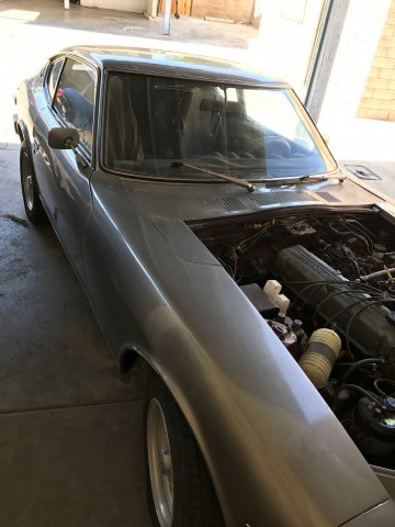

2reckliss Posted September 15, 2017 Share Posted September 15, 2017 MY FIRST BUILD! 1976 Datson 280z pictures of how it sits now are posted below. LOOKING TOO... * Install chevy performance shop connect and cruise LS376/480 with 4L70E *280Z LS3 Swap Kit for engine and transmission. SUGGESTIONS? Can I buy this online, if so where? *Install suspension that can handle 475 LB-FT... I NEED SUGGESTIONS?? [NOT looking to spend over $1,500] *disc brake conversion [rear] Does anyone sell simple bolt on kit for this, if so where? *cheap paint job [$1k - $2k] *Dyno mat the car *Install 225-50-15 tires *Install aluminum drive shaft. Can I buy this online, if so where? *cheap cold air intake [$500 - $1k] Suggestions??? *Aluminum radiator with high performance 11” fans [2x] I live in the desert lol *Add 20 gallon fuel cell without cutting into the trunk where the spear goes [if possible] can I use the OEM??? Also need fuel pump Suggestions? PLEASE DONT GET CRAAAZZZY WITH COAST [I'M NOT RICH LOL] SERIOUSLY THOUGH Quote Link to comment Share on other sites More sharing options...
