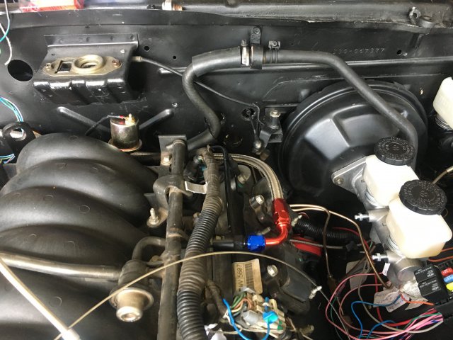

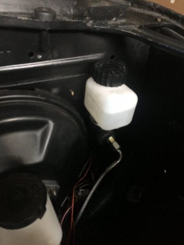

Mounted Tilton 7/8 master cylinder and bled the clutch. The remote bleeder made this job super easy! We just used the original Datsun clutch rod / fork in the new master to avoid welding on a new SAE nut or something.

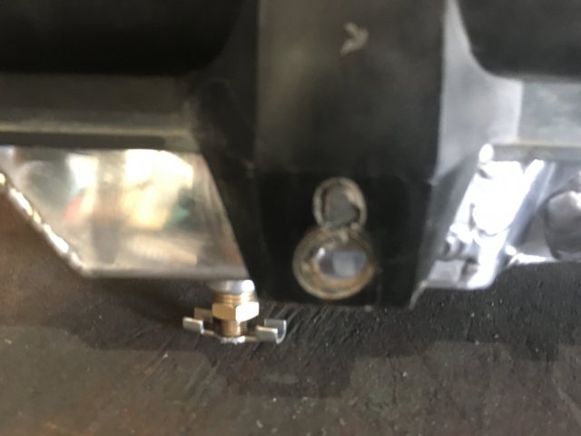

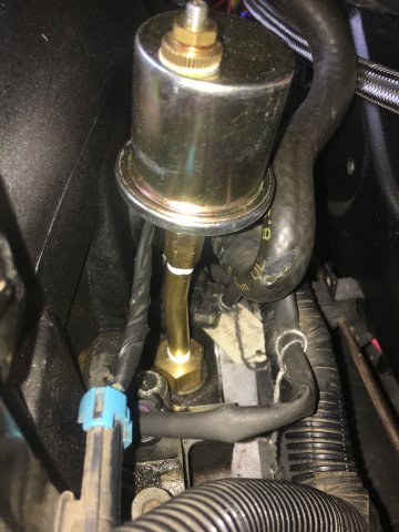

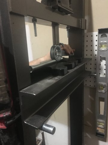

Installed an oil pressure sender for the autometer gauge. We decided to mount this in the original oil pressure sensor location so it wouldn't be down by the exhaust. With this intake most people use an AN line with a bunch of adapter but we just made an extended 1/8 npt tube and bent it on the press to give enough clearance.

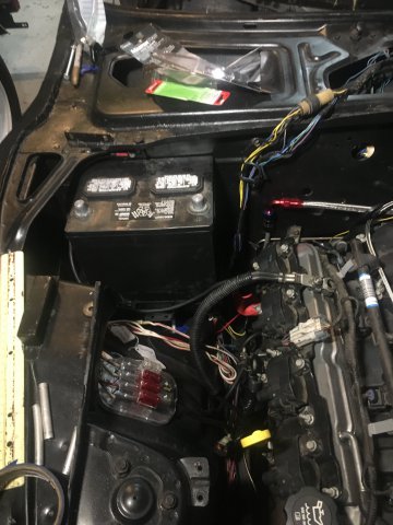

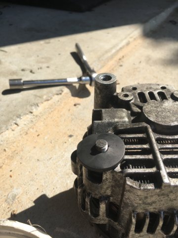

I also spent some more time making the electrical system a little safer. I added a big rubber washer to the alternator to avoid shorts.

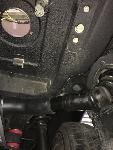

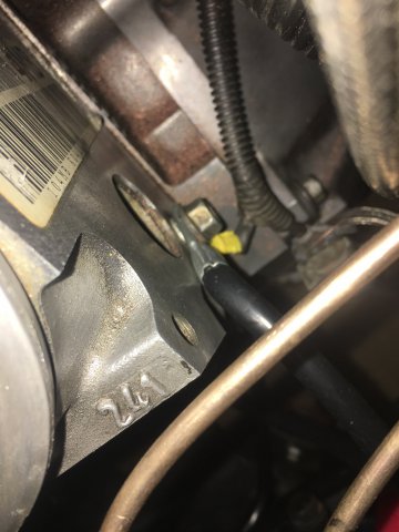

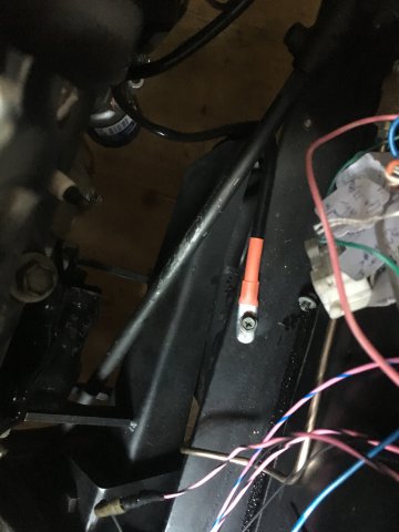

Ground the engine to the frame:

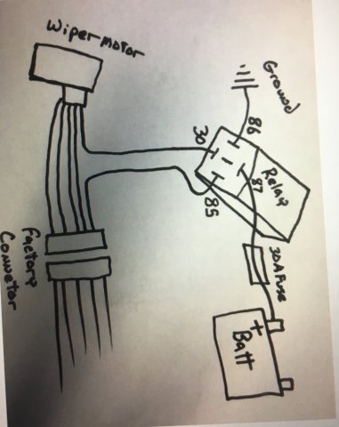

Finally, I also started researching windshield wiper options. The delay relay units for intermittent wipers didn't come with the car so I'll probably just bypass those. It looks like most people use a honda motor but I found this over on classiczcar and I think I'll give it a try.

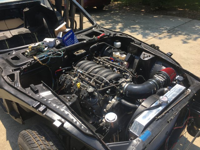

Here's the first start:

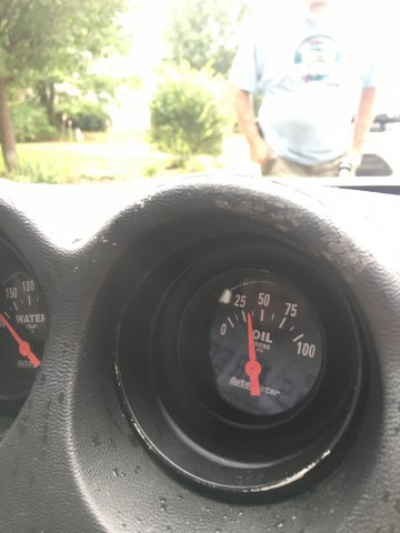

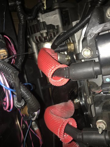

Started right up first try without any huge issues. It built oil pressure right away up to 35 psi at idle. The only problem is it started burning some wires but I had not even ziptied them out of the way or anything so this was honestly expected. I'll add another post with some details.

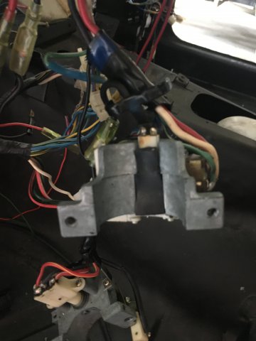

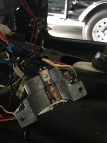

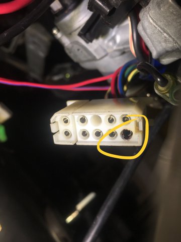

The first issue was no dash lights. I found out that the dash lights were not getting any power and traced this back to the combination switch.There was a burnt out connecter here that wasn't making a solid connection.
I punched that pin out and replaced it with a spare.

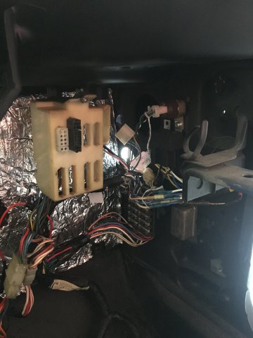

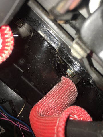

The car also had an issue where it would blow a fuse when the washer fluid button was pressed. I found that somehow the wires were grounding out on the steering column so a quick piece of rubber fixed that.
I found a few other shorts but they were all easy to fix.One issue I kept having during the trouble shooting process was intermittent grounding of all the interior circuits. Just to help other people out here, make sure the fuse block isn't just laying on the floor pan and grounding out all the circuits :) can be super frustrating.

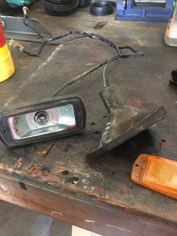

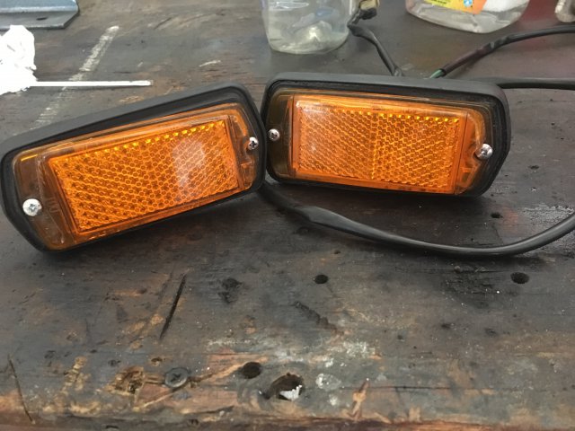

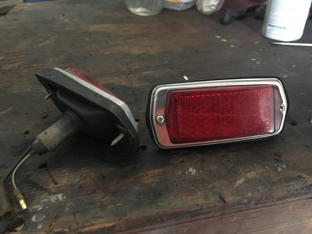

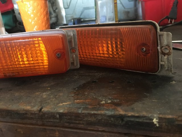

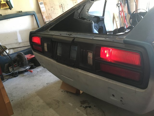

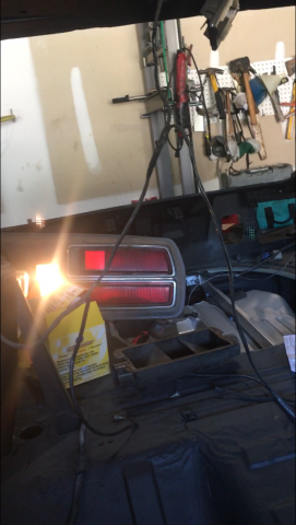

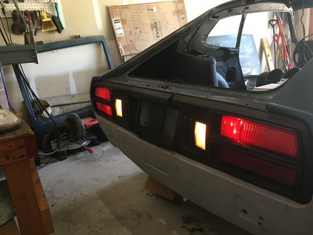

I spent one solid day restoring all the lights.
Before:
After:

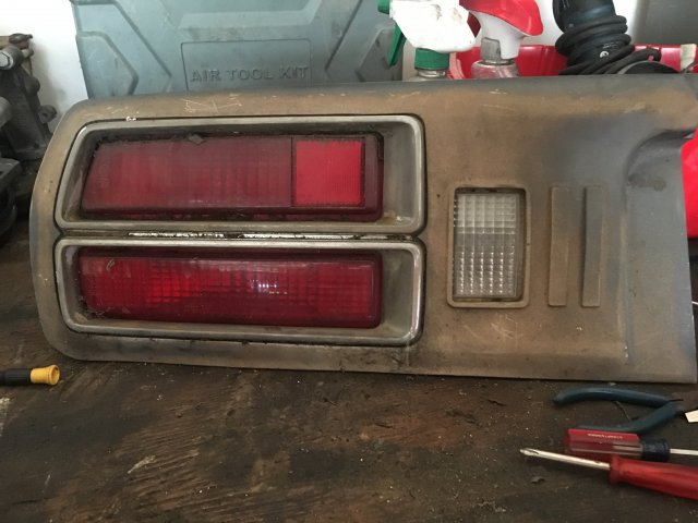

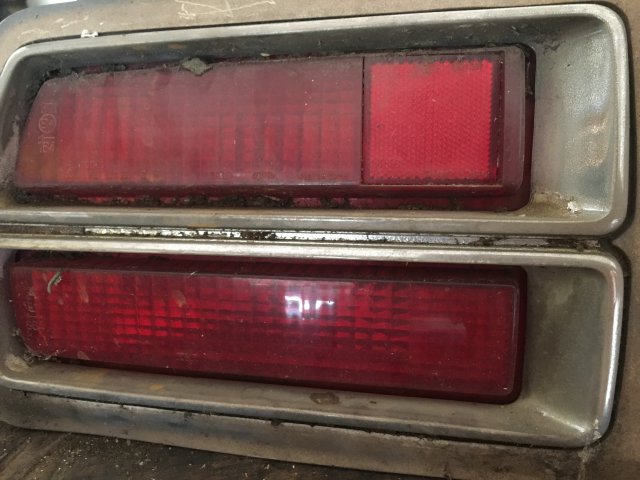

Before on the taillights:

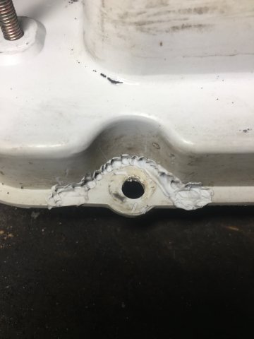

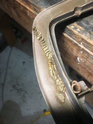

Some plastic welding with a soldering iron:
After:

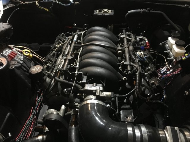

The Engine bay also got some attention to detail on the electronics.

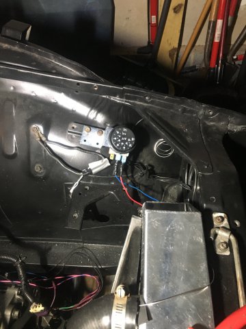

Adjustable fan controller:
This probe goes into the coolant engine discharge line to get the temperature

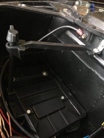

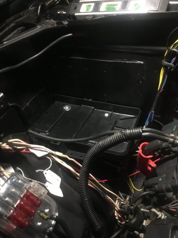

Also created a plastic battery tray... should prevent future rust
Now I need to figure out how to route the wires in the engine bay away from the exhaust and then just A/C and sound system wiring.

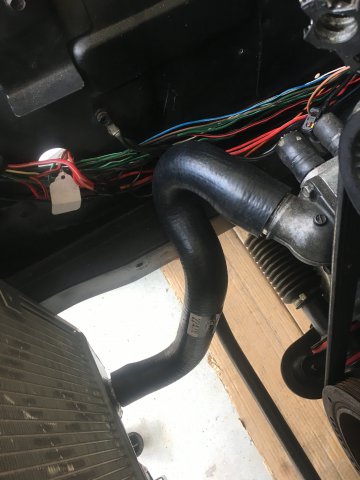

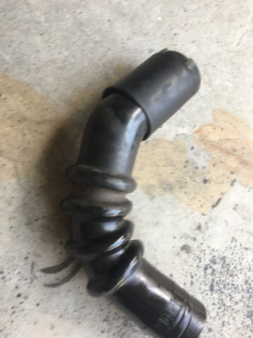

First we found some radiator hoses off of this site that were super cheap on amazon.
The upper hose with a T fitting for the steam vent.

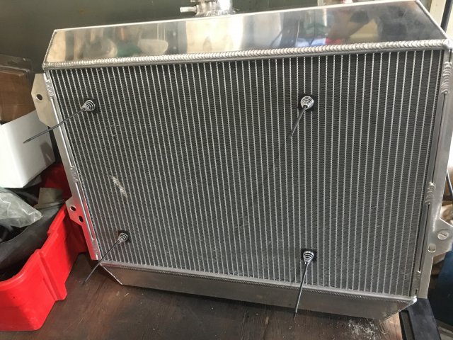

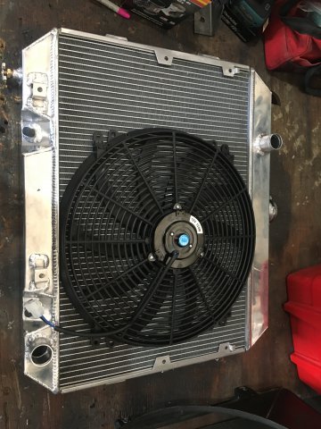

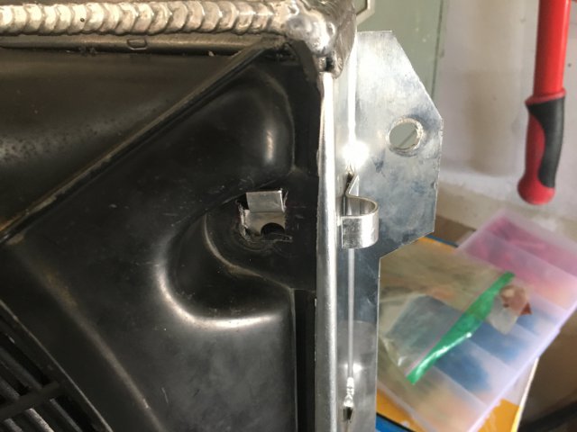

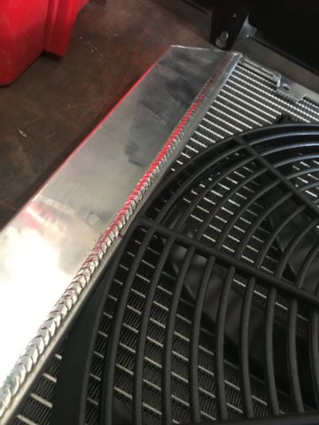

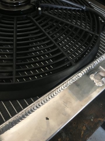

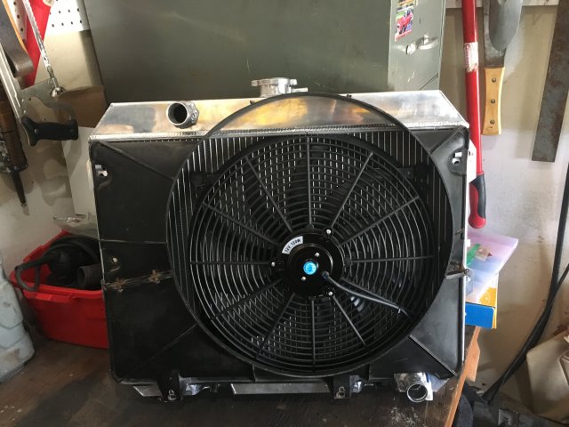

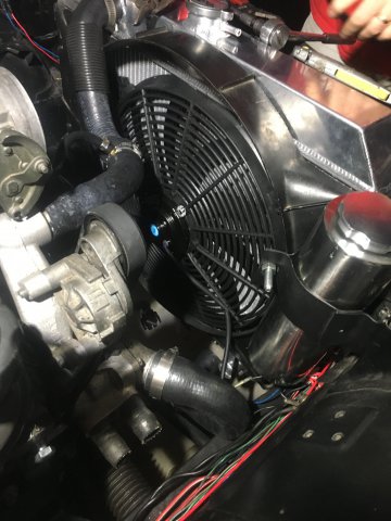

Next, we used a single 16 inch fan and the factory Datsun 280z fan shroud with some modifications. This fan fit perfectly in the radiator so we felt comfortable just mounting it with some radiator zip tie things:

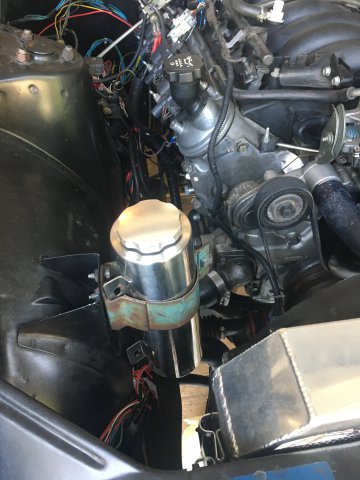

We also added a coolant overflow tank using the bracket from the original charcoal canister:

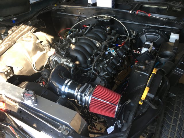

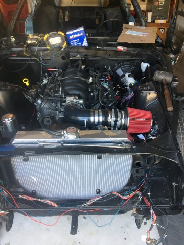

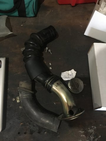

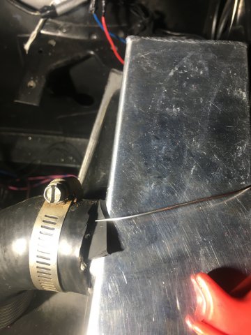

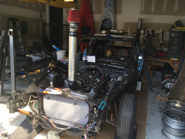

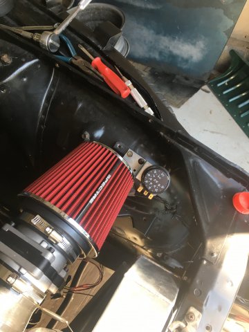

Cold Air intake:

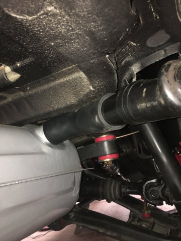

Finally, to finish off the update here's the throttle cable and exhaust.

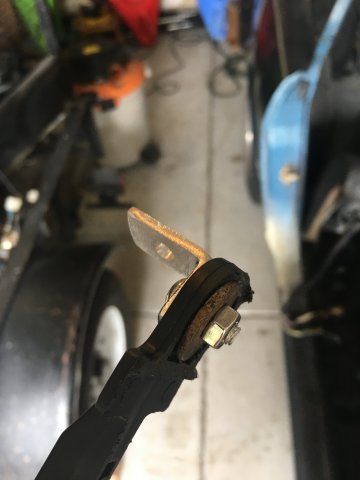

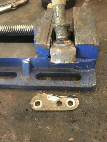

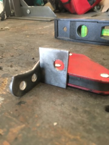

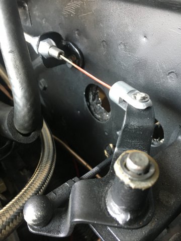

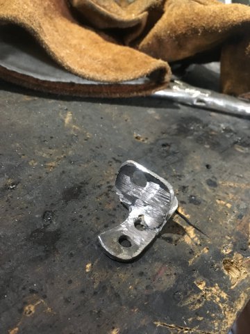

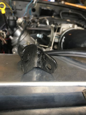

To use the original Datsun pedal I fabricated a bracket to house a lokar universal throttle cable.
I used a piece from the original throttle arm to get the correct firewall bolt pattern:
Installed with cable shortened to correct length.
I just drilled out this rotating arm:

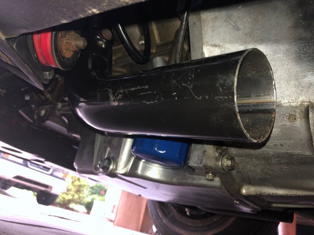

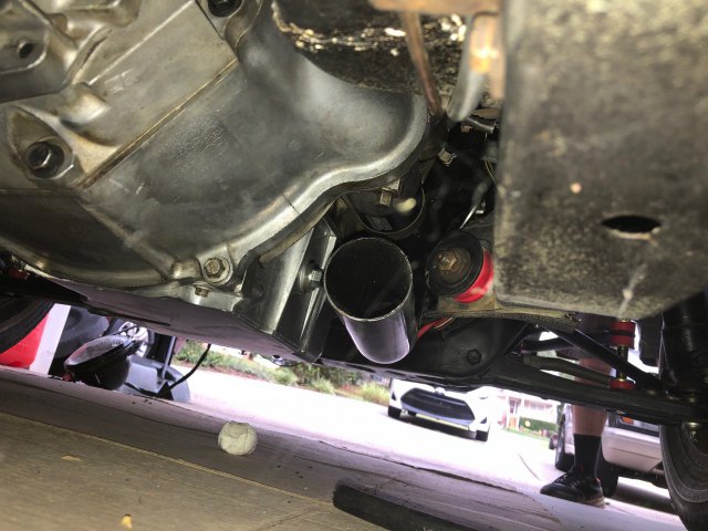

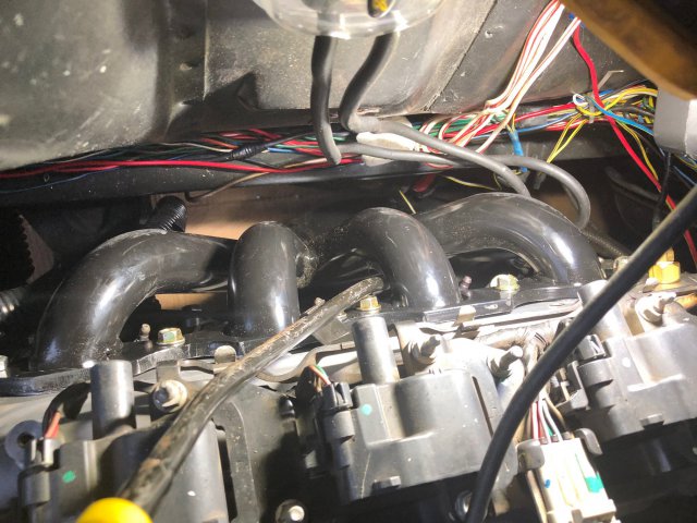

For exhaust headers we used JCI's new 1 3/4" headers which fit great! We were apparently the first customers to get this new design.

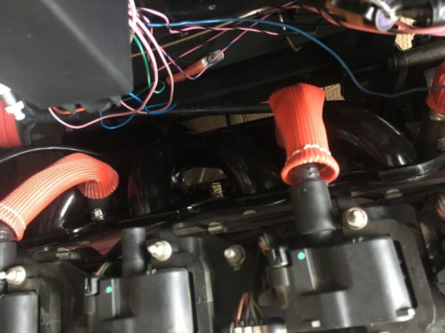

One of the center spark plug wires is difficult to install on each side but still manageable.

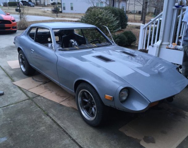

Just painted the car Dodge Destroyer Grey. Took many many hours (75+) and still haven't even cut and buffed it.

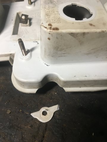

Now working on the wipers. The arms under the cowl panel were completely rusted frozen and I broke one of the swivel platforms trying to press out one of the spindles. Also, the wiring is a nightmare . . .thought I had it working but now it doesn't. None of the grounds that trigger high and low speeds are connecting and I already loomed the wiring in the cab. I'm sure i'll figure it out eventually but I would much rather wire another whole engine swap or paint it again than figure out these rusted wipers. Fun stuff . . . I want to be done and just drive the thing
