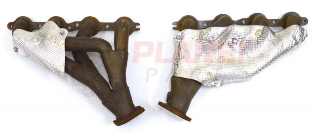

260DET Posted May 9, 2018 Author Share Posted May 9, 2018 Decided to play it safe, particularly as space is largely an unknown at present , so I've decided on a set of used HSV headers. They can always be replaced without losing much if power is not satisfactory. No luck on LS1 Tech, pic of HSV's.. Quote Link to comment Share on other sites More sharing options...
G-Tech Posted May 9, 2018 Share Posted May 9, 2018 i looked at using those headers cause they use them on newer z/28's so they must make power. i decided not to cause the primary tubes can be real small at different points(like 1-1/2in). i went with these billy boat c5 shorty headers (1-5/8 primaries). im supposed to be around 440whp but ended up at 405whp. my tuner said if i had 1 3/4in or even 1-7/8 primaries and long tubes that i could do alot better. i just dont have the room in my s130. basically with my ls6 intake and dart heads, im getting air in, just not getting it out. every winter i think i need to do something about it, then spring comes and i take it for a rip and realize its got plenty of power..i think you will be happy with those, they have to flow really good if they run them on z/28's Quote Link to comment Share on other sites More sharing options...
260DET Posted May 11, 2018 Author Share Posted May 11, 2018 Be interesting to know why the HSV/Z28 headers went with a more complex 1-3 2-4 plumbing arrangement, it would be more expensive to make than the usual 1-2 3-4. Quote Link to comment Share on other sites More sharing options...
