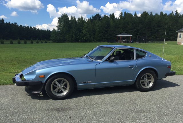

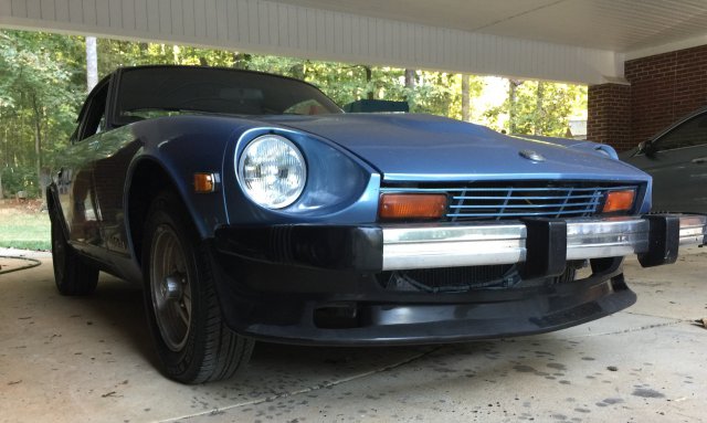

I have a 78 280Z, I found a 82 ZXT on craigslist and bought it. My goal here is to make a drivable stock looking 280Z with some a$$
I have no illusions of out running a modern Camaro or Mustang, but I'd like to make them earn it.
so here we go
As bought almost two years ago.

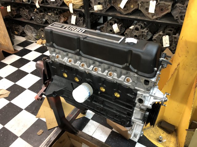

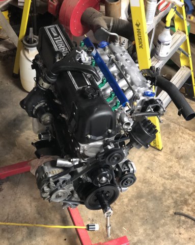

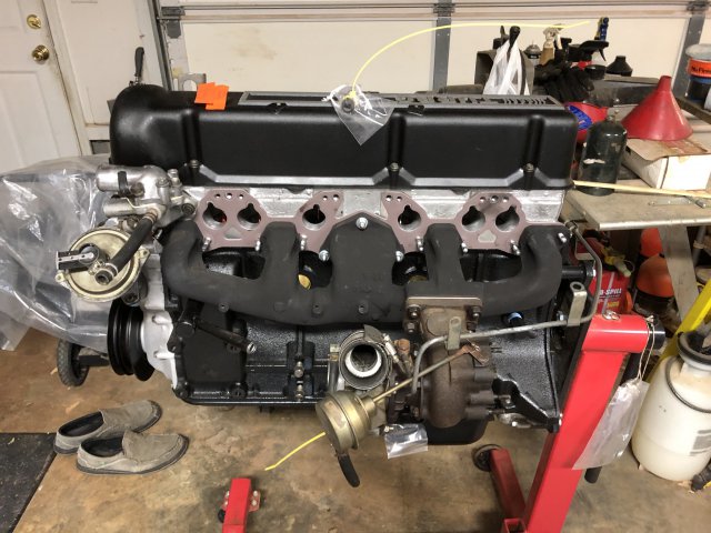

The machine shop had it for 10 months so I'm getting pretty excited to move forward.
It has come a long way
Edited by D9inger
Share this post
9 hours ago, Jboogsthethug said:
I'd say so, like night and day! 10 months is dang long, why did it take so long?
He had some medical issues, his main assembler had a hernia operation right in the middle of it, the pistons had to be custom made, it was a long wait but it's right.

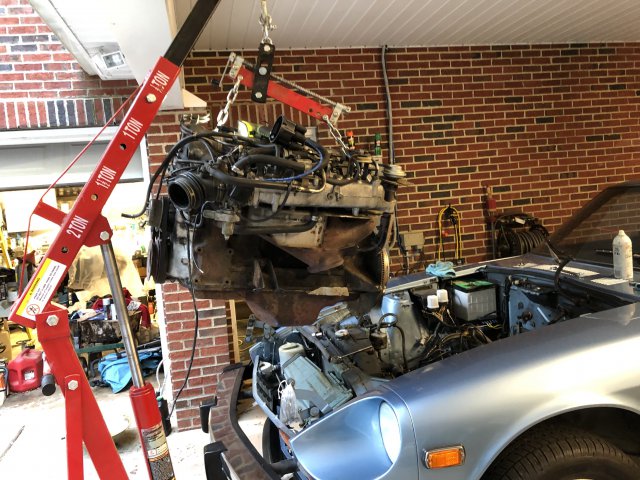

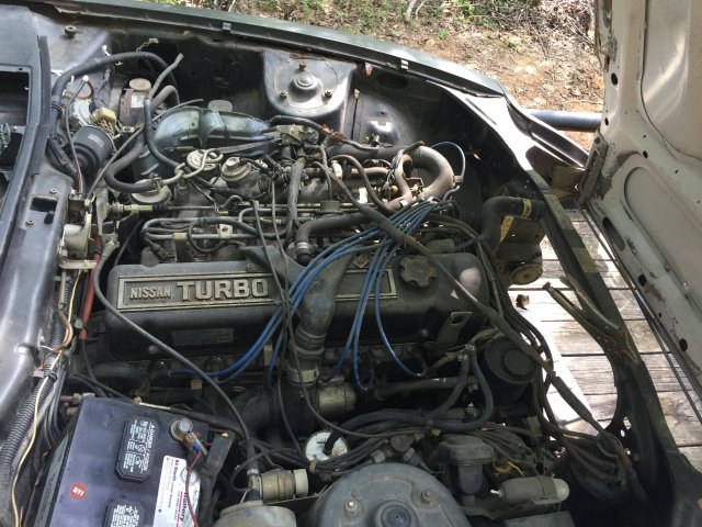

I got the 78 L28E pulled today.

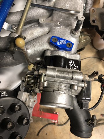

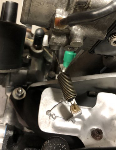

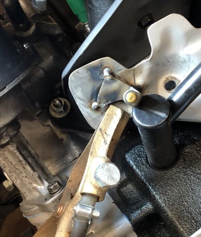

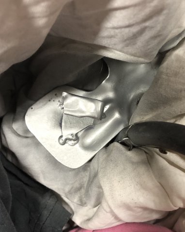

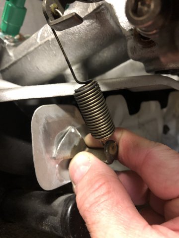

I finally got my throttle body back. The original spring broke after bending it multiple times trying to make it fit and I didn't really like the way it was attaching to the 240 TB per the instructions I found at http://www.graytechsoftware.com/garage/tbs_linkage.asp  I ended it adding a secondary spring from the 1982 turbo throttle body.

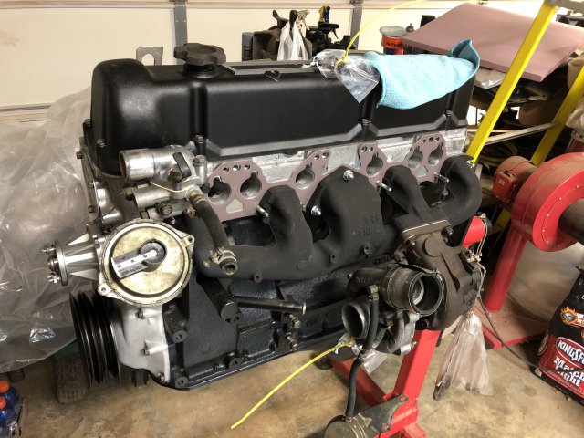

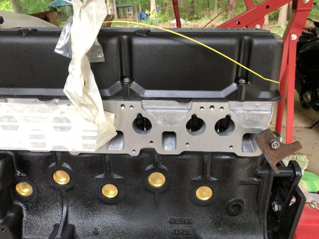

hey d9inger, you have more pictures to share of the p&p? intake, exhaust? thanks.
Share this post
I'll look, I don't know if I'd call it a polish but my idea of polish might be different than David Vizards'.
It's smooth but not "polished".
Share this post
He wrote the book, so I think most will defer to his interpretation. :)  I'm curious to see the contouring and transition he has done/directed. Any pix will be nice.
Share this post
I found a few, I should have taken some more pictures before I installed the manifolds.
I'm going with the stock turbo for now, it's an easy R&R even after installation. I've read the stock turbo will do for up to 12psi, anyway that's an easy swap later.
