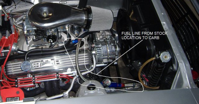

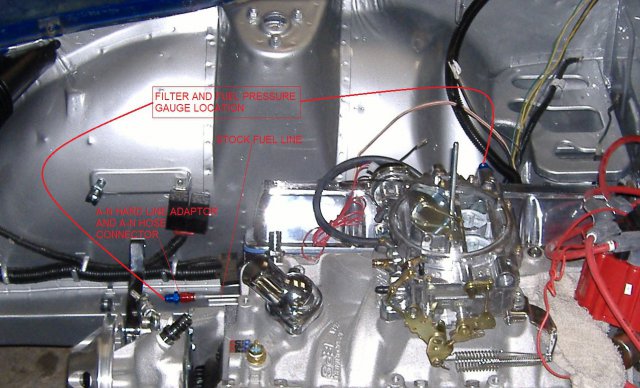

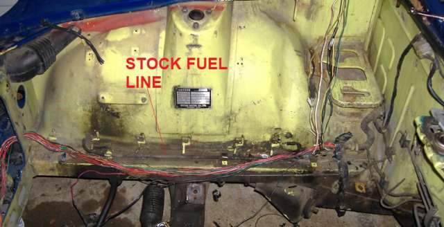

Miles Posted September 13, 2019 Share Posted September 13, 2019 (edited) Captainkim There are several solutions to your problem. None of them include a rubber hose (they crack and leak), cutting a hole, or putting weld goop on a fuel fitting. The solutions do include relocating where the fuel line ends up in the engine bay, proper fuel lines and fittings that make for a safe and reliable fuel system. The previous owner of my first 240Z V8 also cut the fuel line just behind the firewall and then ran a rubber hose to the carb. The hose cracked and leaked. I replaced the hose once and it also cracked and leaked. The cut portion of the fuel line was down in the trans tunnel like yours and impossible to get to. What to do? I ran a new fuel line all the way from the tank to the original stock location on the passenger frame rail, added a filter and pressure gauge and all was well. On my second 240Z V8 project I kept the stock fuel line location on the passenger side frame rail, added a filter and pressure gauge. See pictures below. Options: 1. Cut the collection of brass fittings off the fuel hard line and install a A-N to hardline adapter into which you screw in a A-N hose fitting. Then you run a flex line along the passenger side frame rail with A-N hose fittings on each end to the approx location of the original stock fuel line. This line will connect to your regulator and pressure gauge and then to the carb. The flex line must be anchored to the car with rubber clamps along its route to the carb. When you cut the fuel line where the fittings are, use a tubing cutter and make sure that the cut is perfectly square with the tubing i.e., not an angle. De-burr the cut with a fine file and then slide on the A-N hose to hard line adapter. To do this fix you will need to learn how to select and install A-N fittings. There are many videos available that show how to cut SS flex hose and install A-N fittings. This is expensive, but you fuel system will be leak free and will out live you. 2. You could run a new hard line all the way from the fuel pump to the stock location on the passenger side frame rail. From the hard line run a SS flex line with A-N fittings to the carb. Note: if you are not comfortable with A-N fittings you can use standard hose clamps on the SS flex line. In this case you would use push on type nipples on each device that needs a hose connected to it. Recommendation: Take some time and look at all of the options before cutting or modifying your car. At a minimum, to do the job correctly, you will need to secure your car on jack stands and pull the transmission and driveline in order to re-work the kluge* the previous owner created. * kluge = a mass of IL-fitting parts forming a disgusting whole. Edited September 13, 2019 by Miles Add picture Quote Link to comment Share on other sites More sharing options...
