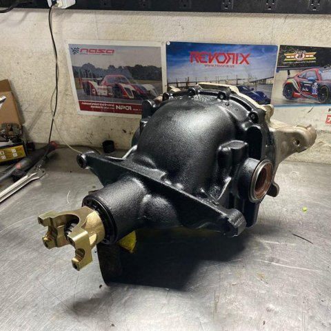

Invincibleextremes Posted October 28, 2019 Share Posted October 28, 2019 (edited) Swap kit for s30 datsuns to swap the super 8.8 off a 2015 and up mustang into the 240z, 260z, 280z Comes with uprights that bolt up to off the shelf 2004 neon srt4 coilovers and a cradle kit for the super 8.8 diff. Brakes, bolt on hub, donor cv axle parts and diff all off a 2015 mustang. 5x114.3 bolt pattern. 2014 brakes will work for some 15 inch wheels and will bolt up with 5/16 caliper spacers that can be ordered extra or can make your own. Kit is currently in many many cars. If you have questions i would be happy to answer them. Fully welded kit is all I'm currently selling. 1600 plus shipping. Complete assembled axles are 1100 plus shipping. Feel free to ask questions, also can accommodate special requests within reason. Edited April 21, 2022 by Invincibleextremes Add pics Quote Link to comment Share on other sites More sharing options...

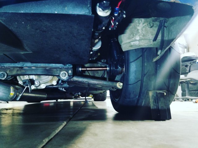

Invincibleextremes Posted February 7, 2021 Author Share Posted February 7, 2021 Version 6 incoming but here are a couple pictures of version 5. Quote Link to comment Share on other sites More sharing options...

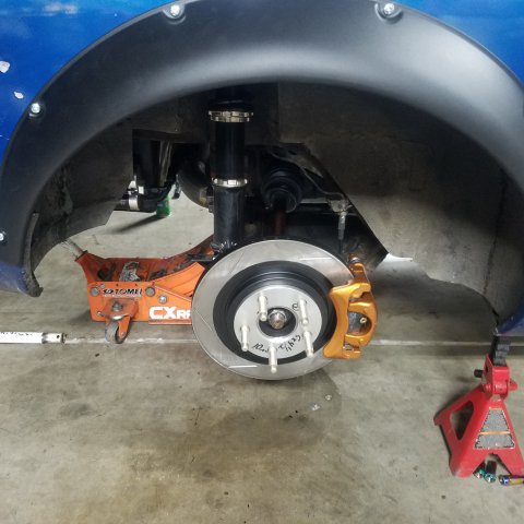

Invincibleextremes Posted April 24, 2021 Author Share Posted April 24, 2021 I'm on version 8 now, as version 7 is completely sold out and I'm welding 6 days a week to catch up with everyone. Here's some pictures of version 7 for reference. Quote Link to comment Share on other sites More sharing options...
