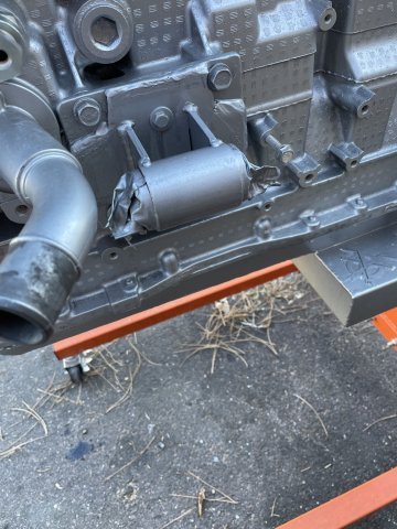

A to Z Posted October 29, 2025 Author Share Posted October 29, 2025 Today I began making my own alternator relocation bracket. Quote Link to comment Share on other sites More sharing options...

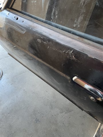

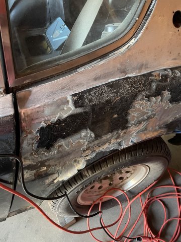

A to Z Posted November 1, 2025 Author Share Posted November 1, 2025 260Z Rust Repair Day. I had "The Floor Pan Man" from Denver come over and got all the rust cut out and welded up. In the process of doing that we found damage and THICK Bondo in the rusty area behind the passenger rear wheel. Through sheer luck the Klassic Fab Vintage JDM patch panel was high.....high enough to remove all the thick bondo, and the rust. Once removed, we found a vertical welded section that the original body man had made to straighten everything out. So, Corey was able to cut that open again, and get it all straightened out correctly AND replace the inner panel that was rotted away also. While he was doing that I tore drivers door window and mechanism out, and replaced it with a refurbished part from Adam Sylvester at Datsun Rescue. The window had been held up with duct tape for over 10 years, and getting that "goo" off the window frame took quite a long time with steel wool....the glass I was able to use a razor blade to get it 90% done.....more will have to be done later.....but the PITA job I was dreading is now finished. When the bondo was found, I took my angle grinder and flap wheel and started looking for other areas it might be hiding.....luckily their isn't any.....but the thick paint on the car is in such a condition, that I need to use the flap wheel to remove it all, and then step it out with finer and finer paper to remedy it. I also put the glaze on the places needed in the engine compartment....doesn't look good. Why? Because the Dolphin Glaze I decided to use is "self leveling"....on vertical surfaces it "self levels" it's self down the panels! Not a biggie, it will sand smooth, but I don't want any more self leveling glaze! LONG DAY! Pics. Quote Link to comment Share on other sites More sharing options...

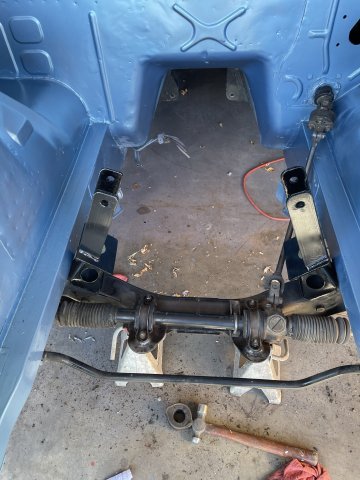

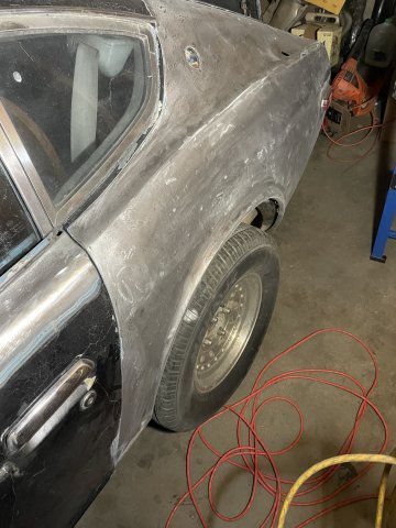

A to Z Posted November 2, 2025 Author Share Posted November 2, 2025 11-01-2025. 260Z work. I got the engine compartment sanded down after the glaze and then cleaned up the crossmember and rack with cleaning solution "g@s" and a toothbrush, and then steel wool, etc. Then I vacuumed out the cowl and primed it with rustoleum rust primerand top coated it with gloss black paint, then painted the engine bay with filler primer. Once dry I will use some spot putty I picked up on the areas that need it, hand sand it smooth and filler primer over that. Once it is good, then I will progress to color and then clear. Busy day! Pics: 3 Quote Link to comment Share on other sites More sharing options...

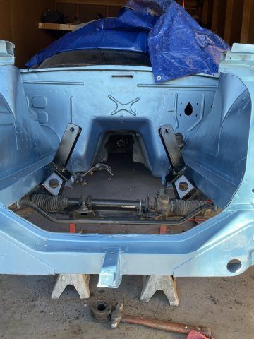

A to Z Posted November 4, 2025 Author Share Posted November 4, 2025 11-04-2025. I did a little bit of spot putty work this morning, have a few spots a couple thick coats of filler primer then went ahead and painted the engine compartment and cleared it. Yep, the work isn't very good.......I did what I could. PICS. 1 Quote Link to comment Share on other sites More sharing options...

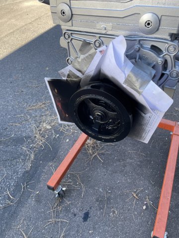

A to Z Posted November 6, 2025 Author Share Posted November 6, 2025 Today I cleaned up the motor mounts and alternator bracket and gave them a coat of paint. I also drilled out the holes in the motor mount pads on the crossmember and painted the visible spots. Lastly the wheels came in....16x8 in the front, 16X9 -15 in the rear. Tires are 205/55R16 and 225/50R16. have to slot a couple holes ont he alternator bracket still and a couple holes on the motor mounts needs some time with a burr bit but almost ready to drop the engine into the Z. 1 Quote Link to comment Share on other sites More sharing options...

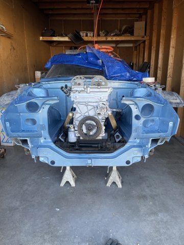

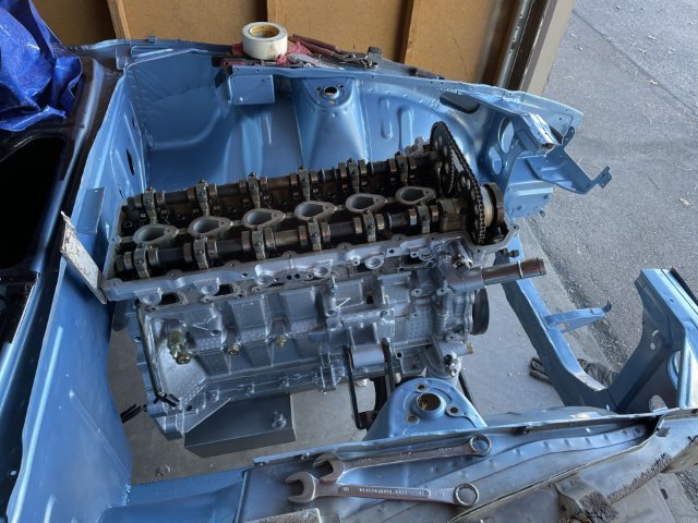

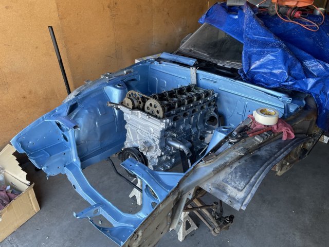

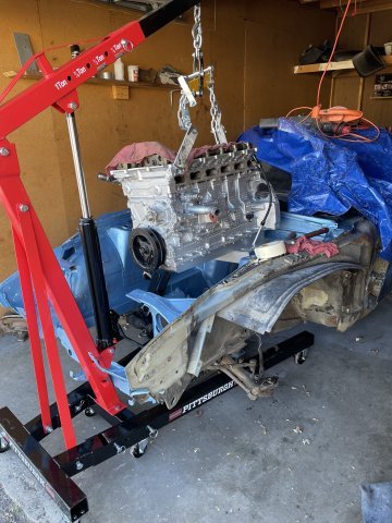

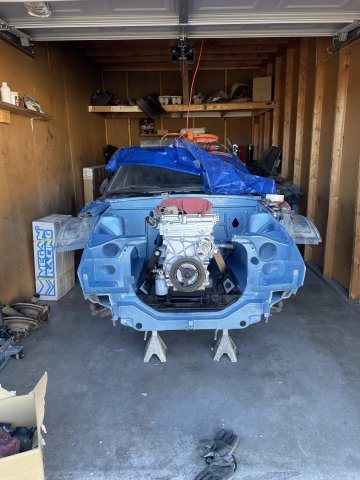

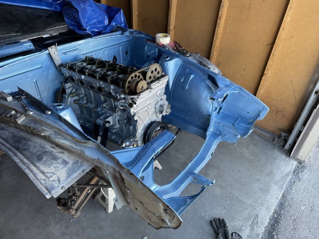

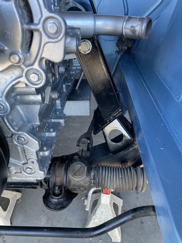

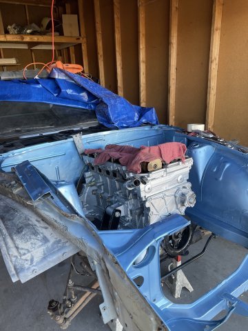

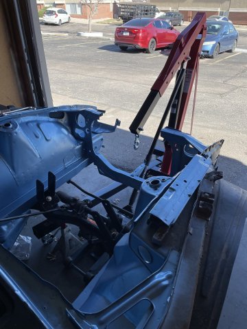

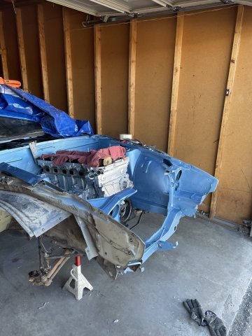

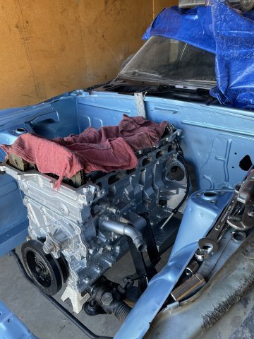

A to Z Posted November 9, 2025 Author Share Posted November 9, 2025 11-08-2025. VERY busy day. running around trying to finish all the little things keeping me from being able to drop the 4.2 into the Z. Then I dropped it in. Feels great to have gotten it done, at least this far. I also was able to do some old paint removal.....the paint on this car is SO THICK.........anyway, pics. Quote Link to comment Share on other sites More sharing options...

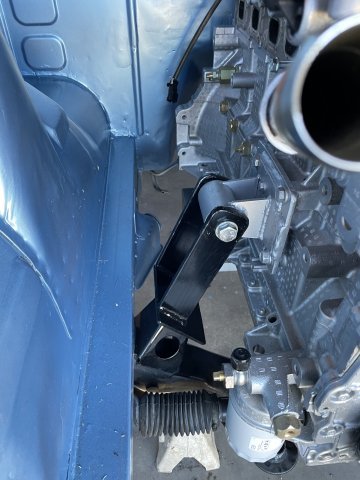

NewZed Posted November 9, 2025 Share Posted November 9, 2025 (edited) I'm sure that you've considered it and I don't know what you would do to cure it if it is a problem but those engine mounts are very long lever arms. What happens if you grab the top of the engine and pull it side to side? Probably best to test it now than to wait. Even the mass of the engine in a turn will place a lot of force on them. Just something that grabs the eye from the pictures. Unusual engine mounting. Edit - fore and aft also. Much lifting force on the rear mount under braking. Fatiguing of the front crossmember engine mounting points might be a problem. It wasn't designed for that type of twisting force. And you've moved the elastic portion up to the engine at the top of the lever arm. The attachment to the crossmember is all metal. Hate to be a Debby Downer but you have access now to work on it, rather than later. Edited November 9, 2025 by NewZed 1 Quote Link to comment Share on other sites More sharing options...
Mitchel0407 Posted November 10, 2025 Share Posted November 10, 2025 My god, seeing that engine finally inside the car truly gives some perspective just how massive that engine is. The L series looks small in comparison! 1 Quote Link to comment Share on other sites More sharing options...
74_5.0L_Z Posted November 10, 2025 Share Posted November 10, 2025 I don't know how you have the engine placed, but I would offset the engine about 1 inch toward the passenger side. The drive shaft angle is easier to minimize with the engine shifted in-line with the pinion. This also makes the weight distribution a little better when you are in the car. 2 Quote Link to comment Share on other sites More sharing options...
