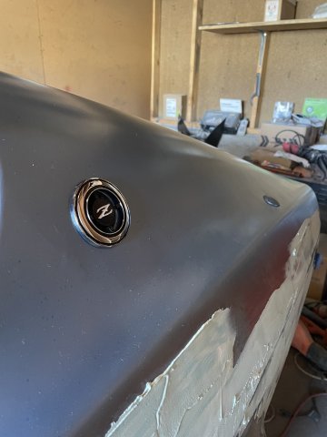

A to Z Posted November 29 Author Share Posted November 29 11-28-2025. I started today by sanding out and using some filler glaze on the left headlight bucket, and then sanded down both front fenders. Then I finished scribing out the hole on the hood and cut it. After that, I went ahead and primed and painted the front fenders and the one headlight bucket I currently have. There are 5-6 spots I will have to fix / paint correct, but progress is made. Pics: Quote Link to comment Share on other sites More sharing options...

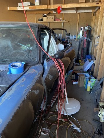

A to Z Posted December 4 Author Share Posted December 4 12-03-2025. At home, and it is COLD (20 degrees) and snowy. I put on 3 layers of clothes and went out to remove some more old paint off the 260Z. Hands and feet got cold, otherwise not bad. had to stop twice and use my leaf blower to blow all the paint dust out of the garage. amazing how much is created....and as usual this paint is VERY hard to remove. 60 grit flap disc on an angle grinder. I will have to go over all panels with a DA sander and 80 grit to get it smooth......way too cold to put filler on it, but I will start blocking it out once the weather gets warmer. Quote Link to comment Share on other sites More sharing options...
