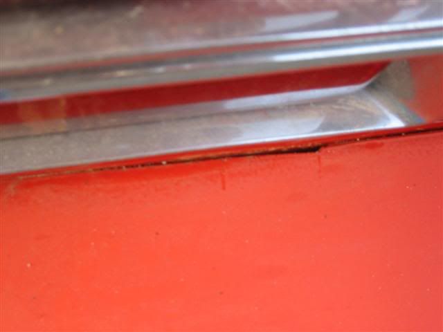

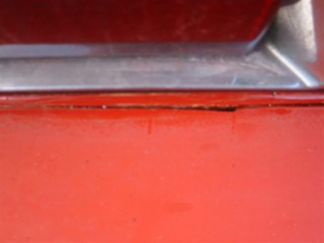

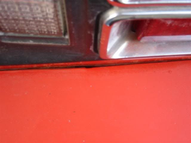

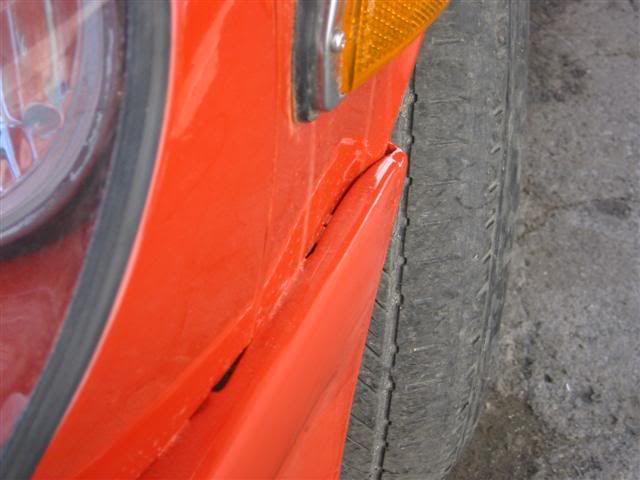

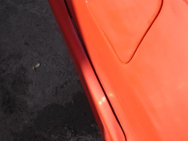

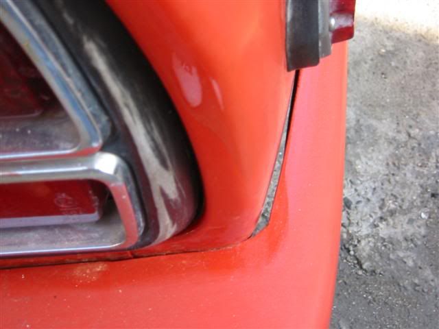

Guest PBooty Posted January 22, 2005 Share Posted January 22, 2005 Rear corner... I love how the rounds match up Airial Shot of the rear bumper.. look at the fatty gap another shot of the same side rear bumper..look at that edge!!! Quote Link to comment Share on other sites More sharing options...

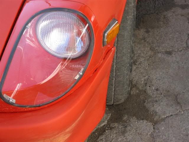

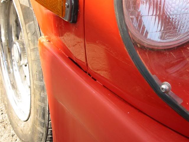

Guest PBooty Posted January 22, 2005 Share Posted January 22, 2005 another shot of the rear front passenger side another shot of the front passenger airial shot of the front passenger Quote Link to comment Share on other sites More sharing options...

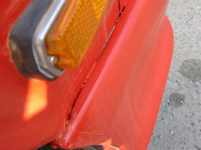

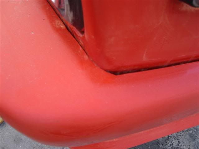

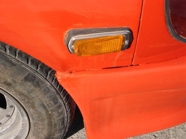

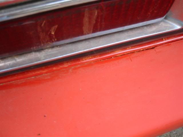

Guest PBooty Posted January 22, 2005 Share Posted January 22, 2005 front driverside and another another shot of the rear and another... i don't know what the hell they gonna do... i have no idea when i'll get this car back... Quote Link to comment Share on other sites More sharing options...
Jason Jarvis Posted January 22, 2005 Share Posted January 22, 2005 It's hard to tell from the pictures, but if that is indeed PAINT running between the metal and fiberglass in places, the first thing to do is have them pull the kit off and clean up the sheet metal and put a decent coat of paint on there. If it is as bad as it looks, you'll be distracted from the poor fit of the kit by the paint peeling off the car in a few months..... Quote Link to comment Share on other sites More sharing options...
Guest PBooty Posted January 22, 2005 Share Posted January 22, 2005 well..this WAS the paint...its been sanded down a lot since I last saw it. the shop agree to install a new weatherstrip kit (that I provided), but they decided to paint THEN install the weatherstrip. After painting there was A LOT of overspray onto the rubbers, so when it came time to remove the old weatherstrip a lot of the paint was damaged. So i guess they decided to resand the entire car and start over..i dunno the point of my pictures was to "show off" all the uneven edges, and huge ass gaps... Quote Link to comment Share on other sites More sharing options...
Guest Magnum Rockwilder Posted January 22, 2005 Share Posted January 22, 2005 That looks like they gave themselves paint enemas and sprayed it on the car from their asses. What "body shop" was this? Quote Link to comment Share on other sites More sharing options...
