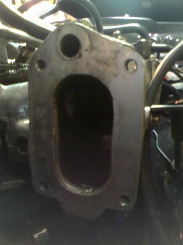

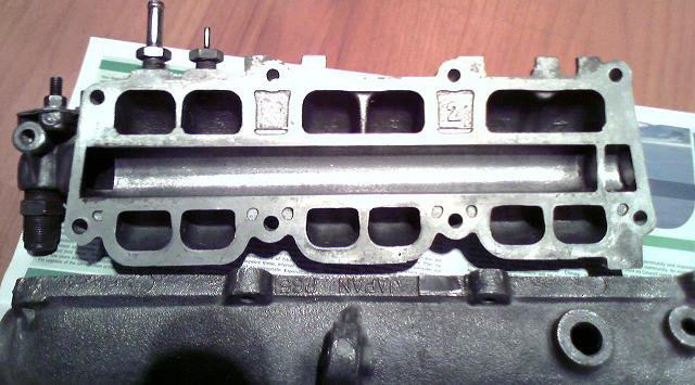

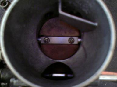

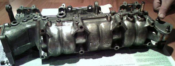

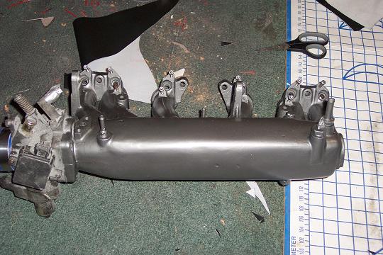

Hey NZeder, I have that same Intake on my '79 Fairlady Z, and it has the dual throttle butterfly - one smaller and one bigger. I'll also share some pictures for those interested. The diameter of the head-side runners are 27mm compared to 30mm on a normal manifold.

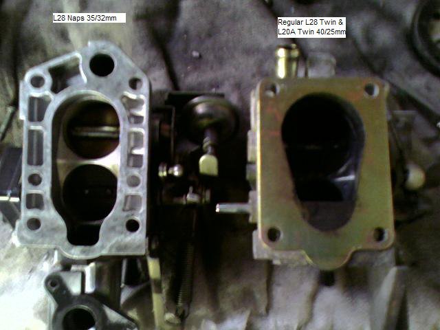

There are two versions of that manifold, one for L20E and one for L28E, the head side is larger for the L28, and it takes the Throttle Body pictured on the right, I believe. One has a primary the size of an American Dime, the other about the size of an American Nickel, with corresponding secondary throttle plate differences as well.
The primary will run you to about 3500rpms and there is a definate 'point' in the throttle pedal play where you end up resting your foot (like GM did on the Suburbans with a big block)---keeps you on the primary even at high-speed cruise (in my 260, 3500 is citation speed in 5th gear!) with what feels like phenomenal throttle response when that secondary kicks in and travels faster in the last 1/4 pedal than the little plate did in the first 3/4 of travel! BuuuuWAAAAH!

I just received my P65 intake. Tony, you mention that one is for the L20 and the other is for the L28...are they both called P65? What other differences do they have? You mentioned throttle body, mine has the twin throttle plate setup and both are about the same size. The runners to the head are 28mm's. Do you think this is a 2.0 or 2.8 version? Anyone can chime in if they like. :)
