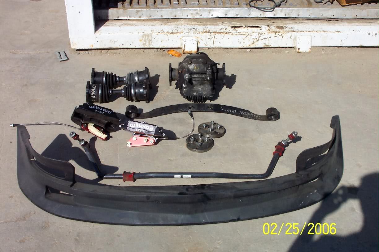

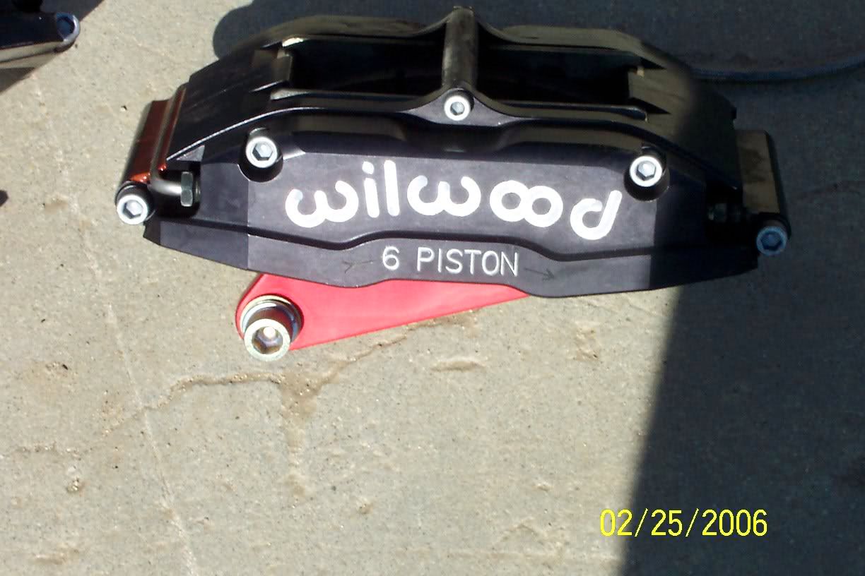

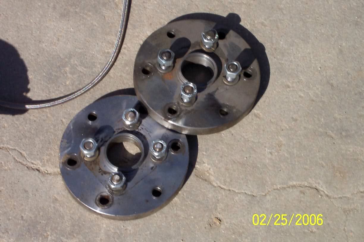

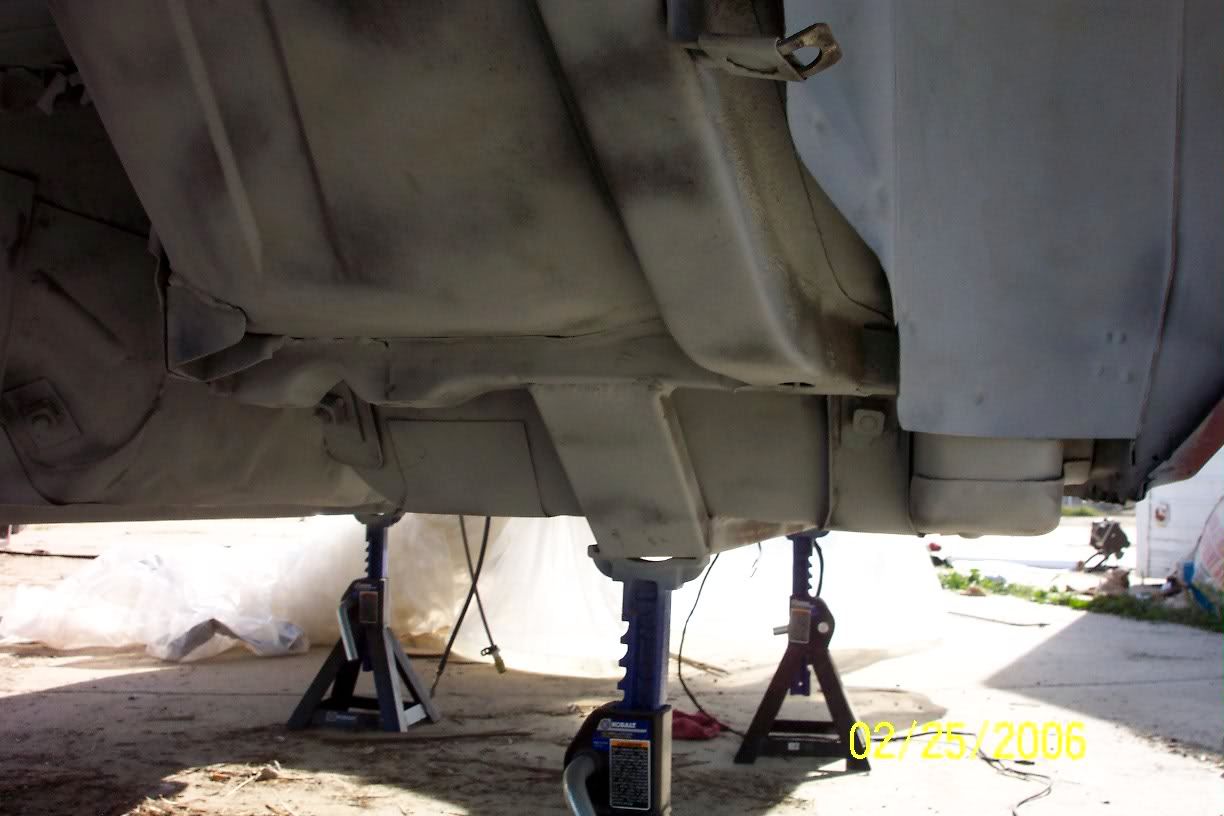

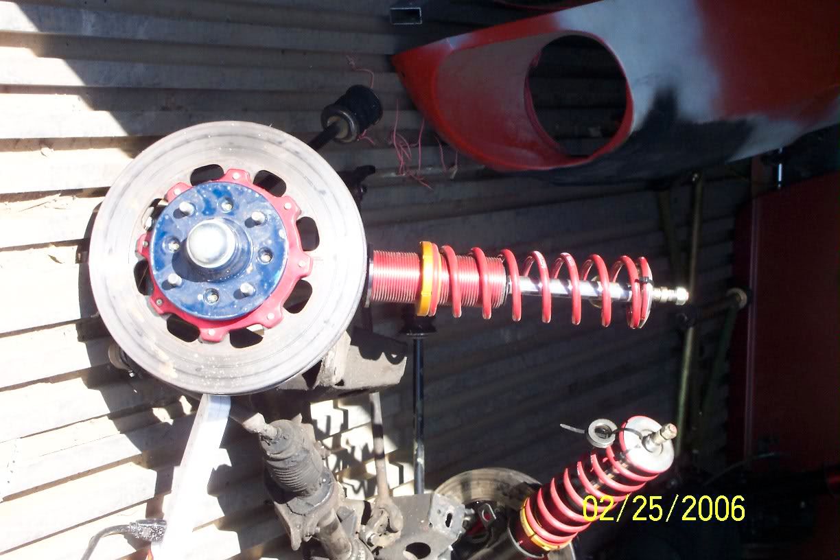

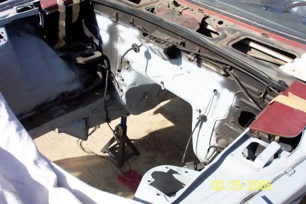

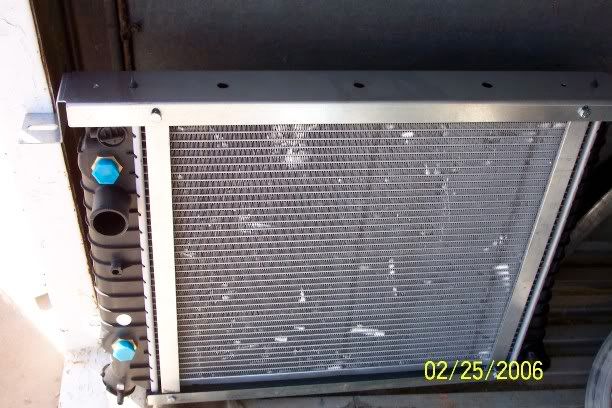

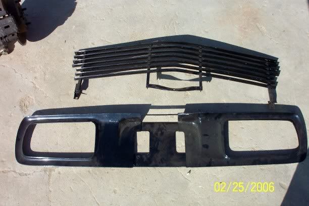

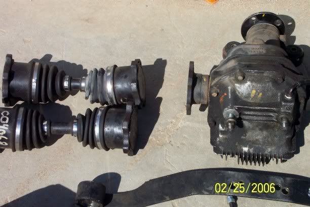

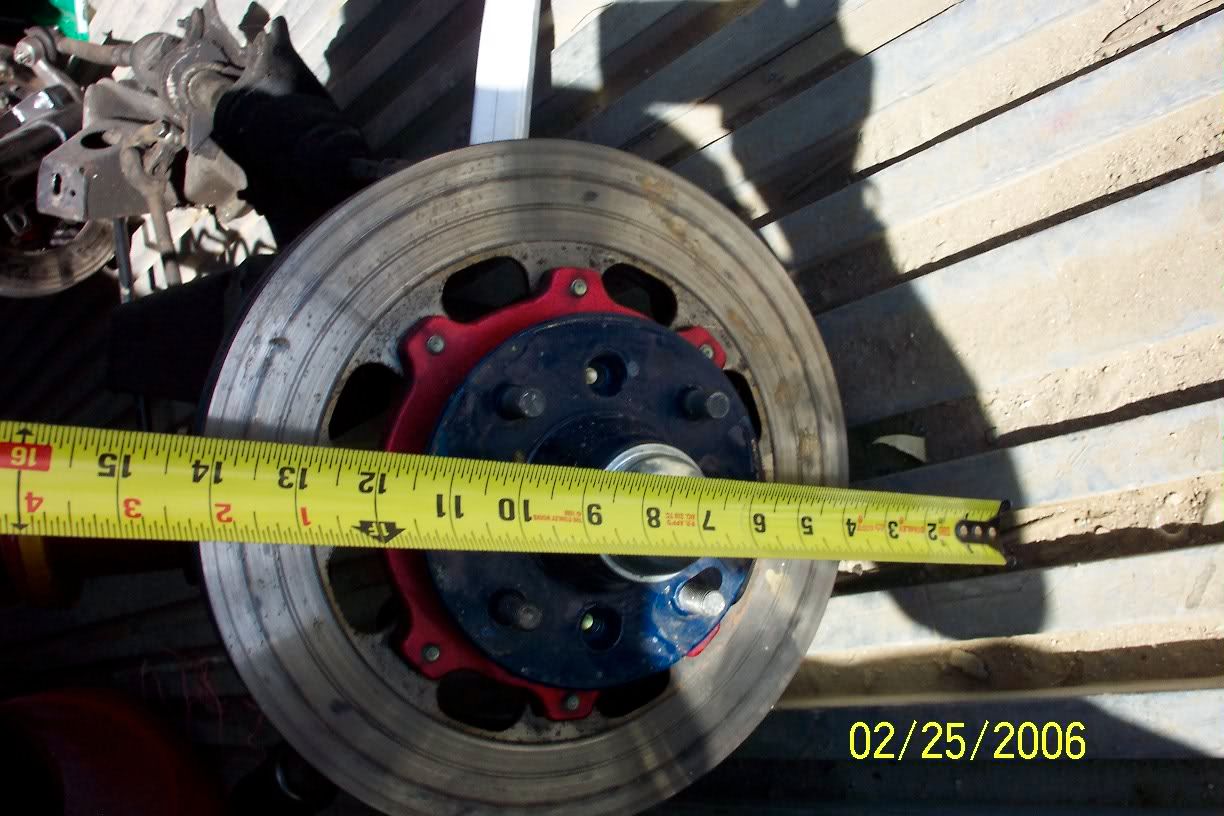

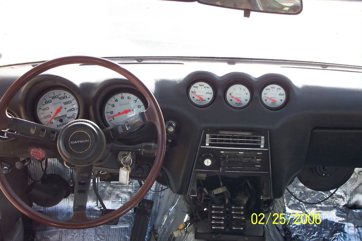

tfreer85 Posted February 26, 2006 Share Posted February 26, 2006 Okay, so I've been searching for a Z since the age of 15 (now 20), I've let more than a number of great deals slip out from under me for whatever odd ball reason. However I must say the 5 year wait, anger of lost oppurtunities, butting head with my parents, has finally paid off. This is now my current 1972 240z. Which I paid a very happy 4k for. You'll notice I don't have very many body shots, because it is in the body shop getting painted just a shade subaru blue with gloss black ZG Flairs, Air dam, and the wheels will be gloss black as well with a chrome lip. Okay so onto the parts list and pics. PARTS: R-200 from a q45 with 3.54 gears and modified Mustache Bar Coilovers Rear Adjustable Control Arms Front Wilwood 6 Piston Brakes Rear Disc Brakes Front Sway bar MSA Urethane Air Dam Gapless Fender to Headlight bucket Mazda Miata Seats Custom Center Console Guage holder Powdercoated Rear Tail-light housing and Grill Bigger Brake Booster New Radiator LS1 Fuel Tank New Upholestry All new weather stripping Autometer Phantom Guages NRHA 10-sec Certified Roll Cage Racing Harness New Front and Rear chrome bumpers Mas28O's CV Adapters Removed Spare Tire Well Pics: Quote Link to comment Share on other sites More sharing options...
tfreer85 Posted February 26, 2006 Author Share Posted February 26, 2006 Sorry for the Large Sized Pics. The primer was just quickly shot on there when it sat outside for one day its all been/going to be removed and cleaned up. The motor I've narrowed down to KA24DE-T or an LS1 and yes I know they are two different ball games. So I'm sitting on the engine choice for a while. Tyson Quote Link to comment Share on other sites More sharing options...

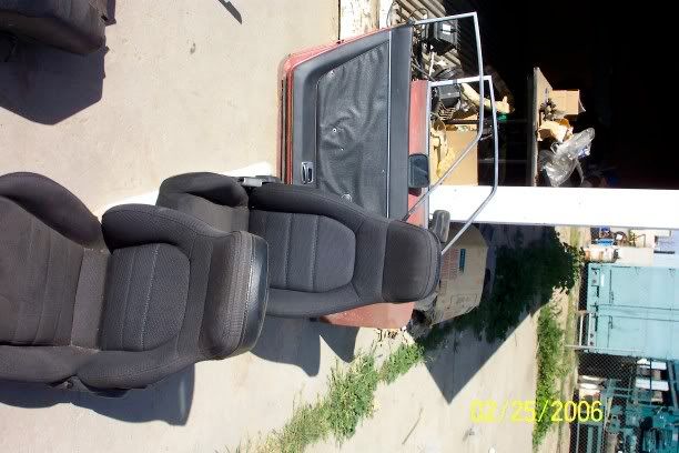

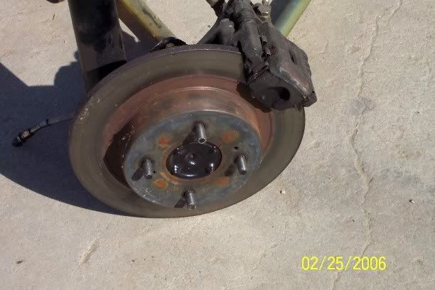

Boobala Posted February 27, 2006 Share Posted February 27, 2006 Nice stuff. A question and a request. Q: How do you mount a rear sway bar with those chrom-moly control arms? I see no attach point. R: PLEASE post a good write-up with pictures on how you mount those Miata seats! Quote Link to comment Share on other sites More sharing options...

Clifton Posted March 5, 2006 Share Posted March 5, 2006 . Q: How do you mount a rear sway bar with those chrom-moly control arms? I see no attach point. On the back side of the toe adjustment, the point of the triangle, there is a female threaded hole to attach a rod end with a bolt. I thought he includes them with the arms but could be wrong. Quote Link to comment Share on other sites More sharing options...

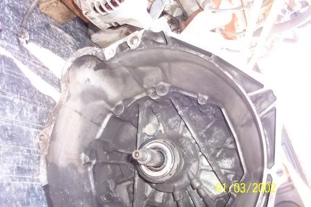

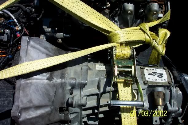

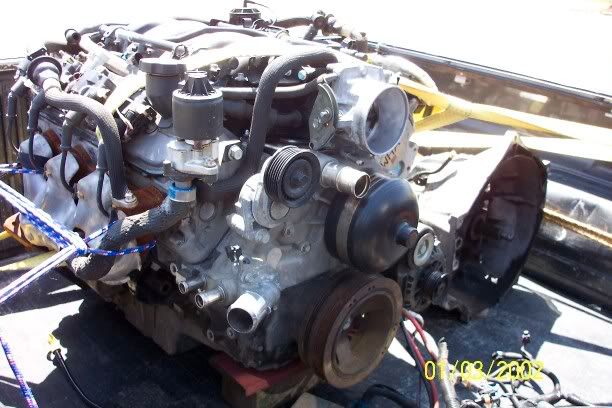

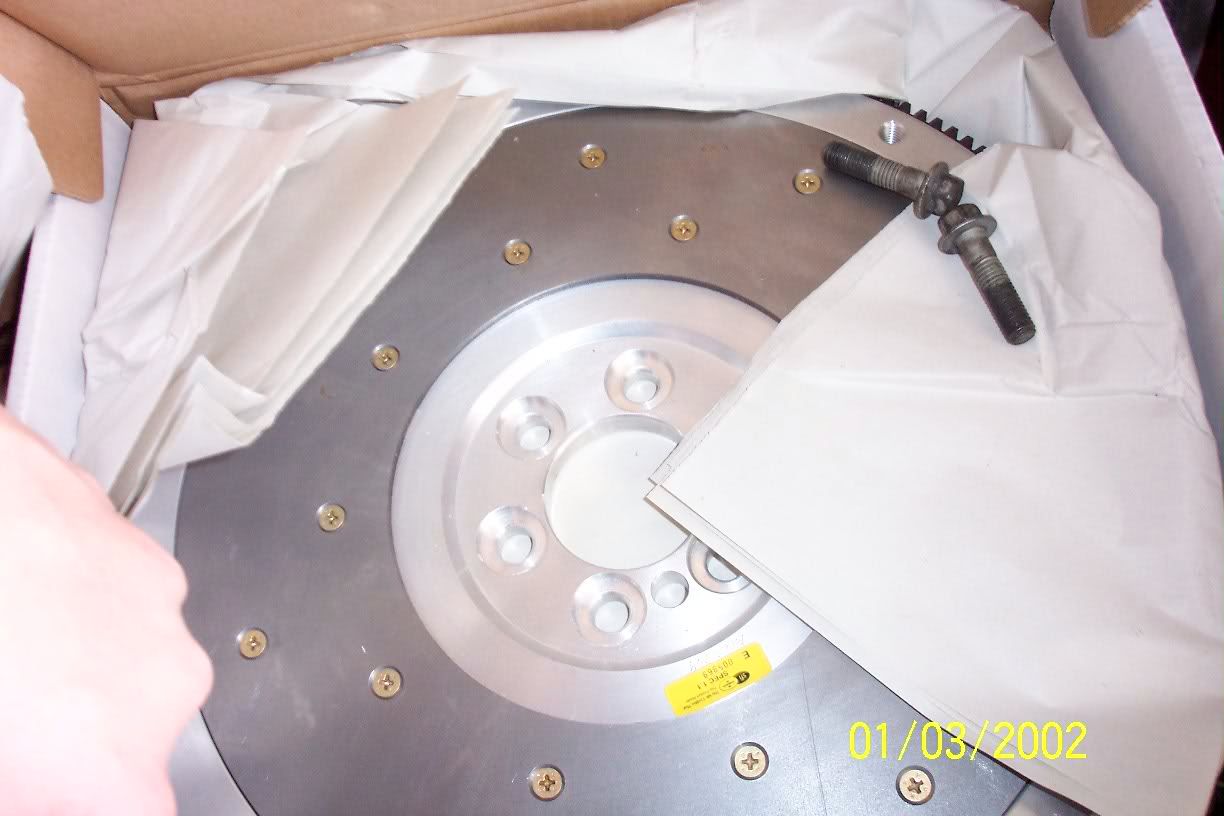

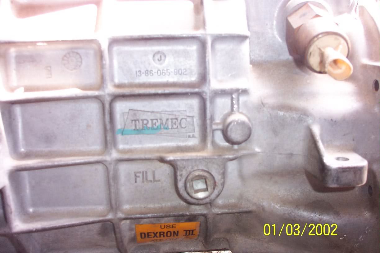

tfreer85 Posted April 19, 2006 Author Share Posted April 19, 2006 So a little while later and here is an update finally. An 2001 41k Mile LS1/T56 engine/transmission combo, complete with ECU, uncut wiring harness, all other normal parts, a brand new Fidanza lightweight flywheel, and new Sanderson Block huggers (idk if they will work with Johns Cars' Kit). Here are the pics: This also means a have a fully rebuilt 350 SBC now for sale. (PM me if interested). Tyson Quote Link to comment Share on other sites More sharing options...

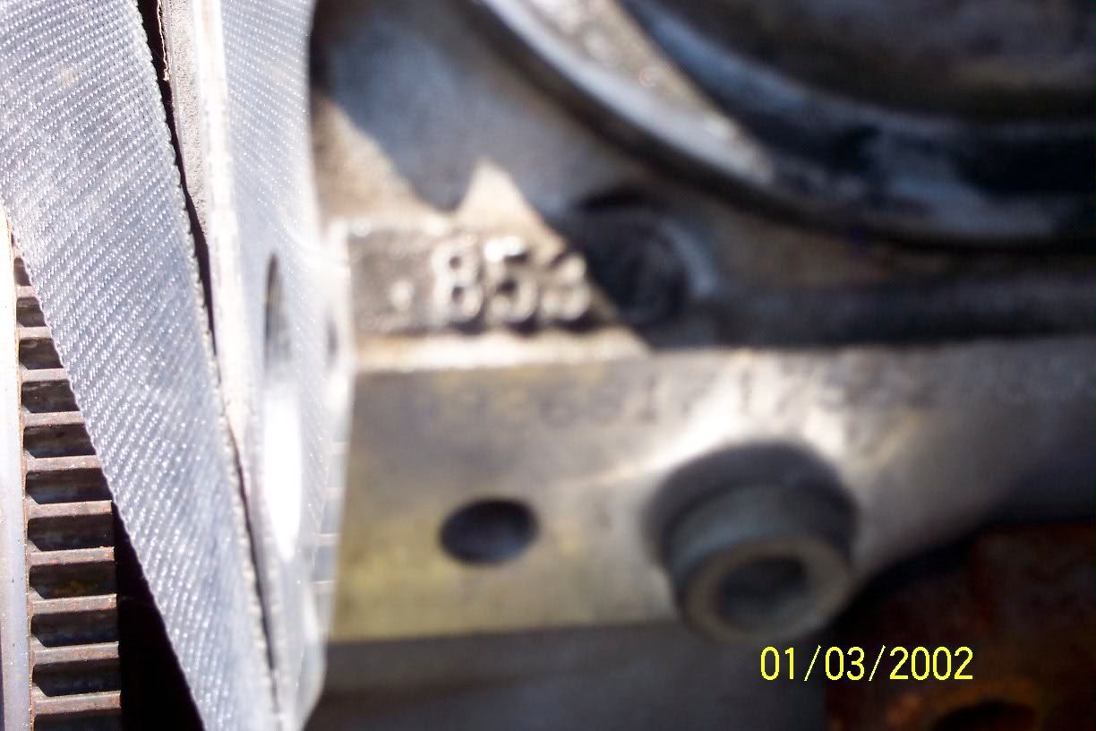

mas28O Posted April 19, 2006 Share Posted April 19, 2006 Your motor is a 99-00 ls1 not a 2001. Quote Link to comment Share on other sites More sharing options...
