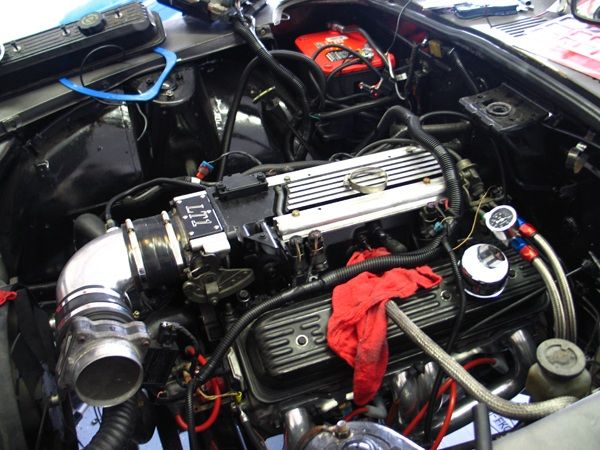

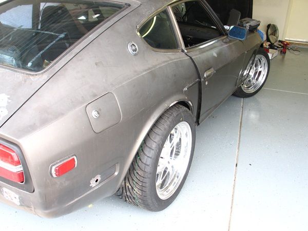

nazar Posted March 23, 2006 Author Share Posted March 23, 2006 its a bit cleaner now, the wiring, i also got heat wraps for the ends of the spark plug wires, some plug wire organizers, the ecu is mounted right next to the battery on the inner fender, etc i just hope the zg flares dont kill the look, i wish i could keep it like this, but i just have no tire clearance, ill cut the fenders out, put the zgs on and hopefuly be able to swallow the meats when i go over bumps Man i just wanna drive this thing, my goal is by next weekend to take it around the block After that start doin the little stuff...i need to stil get my driveshaft angles, i just put it where i think it looks good now, we'll see, i can adjust both the height of the front of the diff and the rear of the tranny to get the angle i need, so i should be able to get it just right Im still looking for a stock datsun clutch pedal, as my car didnt have one when i bought it, lol...the missing link:) Quote Link to comment Share on other sites More sharing options...

CruxGNZ Posted March 23, 2006 Share Posted March 23, 2006 I think my clutch pedal is still laying around here somewhere, since I switched to automatic. If you can't find one local to you, let me know. The ZG flares will look awsome! They will bring the look together in my opinion. I just can't get over the wide meats in the rear! Looks like something you don't want to mess with Quote Link to comment Share on other sites More sharing options...

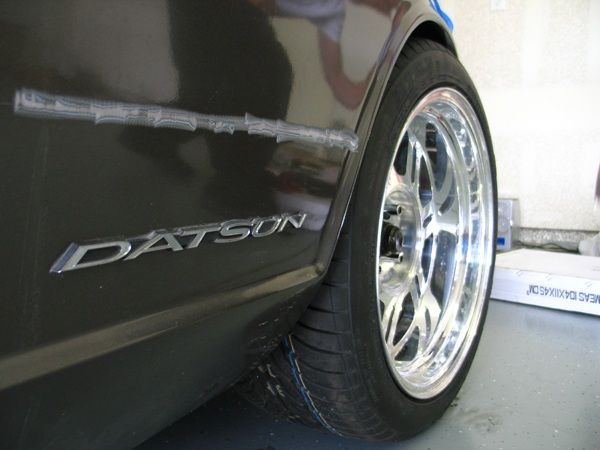

ULISES Posted March 23, 2006 Share Posted March 23, 2006 Look's good man! I like how the wheels look on your car, I have seen them on other cars and did not look that good. Quote Link to comment Share on other sites More sharing options...
nazar Posted March 23, 2006 Author Share Posted March 23, 2006 Look's good man! I like how the wheels look on your car' date=' I have seen them on other cars and did not look that good.[/quote'] i am a firm believer in backspacing and stances, i spent countless nights coming up with a wheel package that would compliment the car, thanks for the compliment as well:mrgreen: Now I just wanna drive it down the street, I remember when it was getting towed home from the shop, just on the back of the flat bed, i saw like 4 people pointing at it and smilling:flamedevi Quote Link to comment Share on other sites More sharing options...

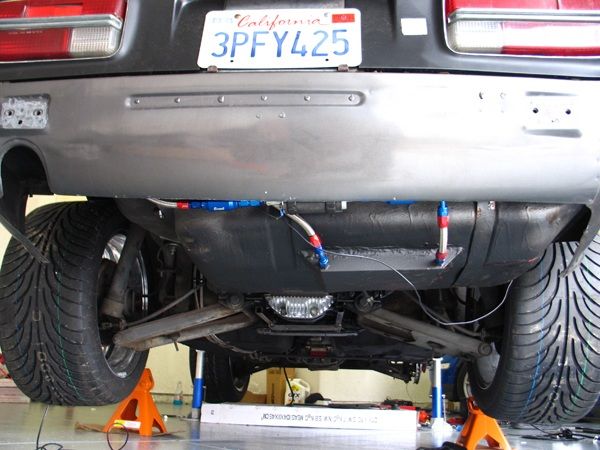

deja Posted March 23, 2006 Share Posted March 23, 2006 You said fuel tank installed, what did you use? I'm about to convert to TPI and was thinking swapping to a GM fuel tank might be the way to go. That stock 13 gallon tank doesn't last long! Quote Link to comment Share on other sites More sharing options...
Mike kZ Posted March 23, 2006 Share Posted March 23, 2006 You said fuel tank installed, what did you use? I'm about to convert to TPI and was thinking swapping to a GM fuel tank might be the way to go. That stock 13 gallon tank doesn't last long! The stock tank is 16 gals. Looks like he has a stock tank with a sump, that's what I have too. It works great with EFI, I have never had a problem. Quote Link to comment Share on other sites More sharing options...

Pop N Wood Posted March 23, 2006 Share Posted March 23, 2006 The stock tank is 16 gals. Looks like he has a stock tank with a sump, that's what I have too. It works great with EFI, I have never had a problem. What's it like welding on the stock tank? I once tried to fix a busted tank and had no luck getting a weld to stick. Any tricks? Use a MIG? Quote Link to comment Share on other sites More sharing options...

Mike kZ Posted March 23, 2006 Share Posted March 23, 2006 What's it like welding on the stock tank? I once tried to fix a busted tank and had no luck getting a weld to stick. Any tricks? Use a MIG? No tricks, just make sure tank is clean, lightly grind the area to be welded, make sure the heat is turned up enough to penetrate. I used a mig. Quote Link to comment Share on other sites More sharing options...
nazar Posted March 23, 2006 Author Share Posted March 23, 2006 i had a shop do it all, and there are no leaks, and it fits great 16 gallons? really? Thats awesome, plenty for me Quote Link to comment Share on other sites More sharing options...
