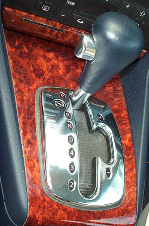

Oleh Posted April 17, 2006 Share Posted April 17, 2006 why not swap in a tip tronic ? this question was on my mind aswell. i figured with a tip tronic atleast i can change something... Quote Link to comment Share on other sites More sharing options...
MONGO510 Posted April 17, 2006 Share Posted April 17, 2006 Okay, I'll bite. What the heck is a Tip Tronic? Quote Link to comment Share on other sites More sharing options...
Sumo Posted April 17, 2006 Share Posted April 17, 2006 Tiptronic is used by Porsche also known as auto stick by Chrysler and known as other names in other brands. It's basically the ability to shift an automatic car manually + or -, up or down then just shift it back to "D" after your done playing. It's like a manual transmission with an automatic. Quote Link to comment Share on other sites More sharing options...
280zwitha383 Posted April 17, 2006 Share Posted April 17, 2006 Sounds like a new name for an old game (Ratchet Shifter). As for the question, both have their benefits. The auto is an easier swap and a built one can handle a lot more power than what you're proposing, but if you want a manual that bad do it! Quote Link to comment Share on other sites More sharing options...
getZ Posted April 17, 2006 Share Posted April 17, 2006 It works about the same as a ratchet shifter. Except with electronic tranmissions you can also change how hard the system shifts. Where are you going to find an tiptronic tranmssion for a small block chevy? Quote Link to comment Share on other sites More sharing options...
