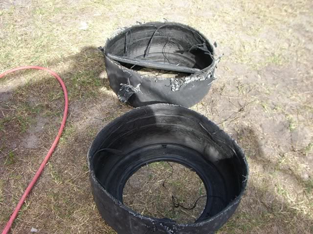

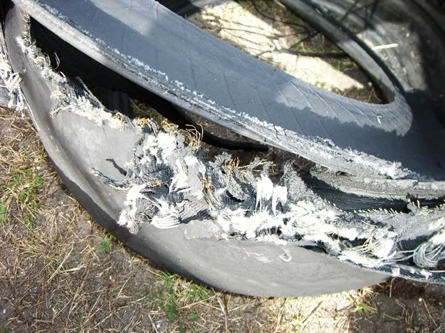

bjhines Posted May 22, 2006 Share Posted May 22, 2006 About those Hoosier failures... These were beaten hard in rental cars and failed quite spectacularly.....My understanding is that too little camber combined with too much heat is what causes this... I would not put Hoosier to blame on this failure.. they are race tires... they grip like hell.. and they can overheat and go to pieces... these tires were run in a 6 hour enduro.. the drivers and crew took a chance and lost.... I balanced his tires and a bunch of others at Sebring during the Jan06 PBOC winterfest.... ME at the balancer.... I really needed sunglasses.... Money shot... Quote Link to comment Share on other sites More sharing options...
