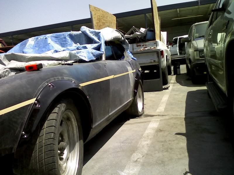

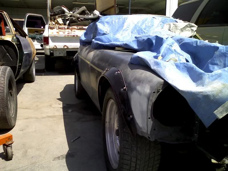

Thanh Posted April 11, 2007 Share Posted April 11, 2007 Thanks for replying Toecutter. I have an idea now. So the fatter part of the flare is suppose to face forward not back. Dam that motorsport guy really confused me. Telling me to put the thin flares in front. Ill post pictures so you can take a look and tell me if it looks right. Link to comment Share on other sites More sharing options...
Thanh Posted April 21, 2007 Share Posted April 21, 2007 How does it look too low? too high? One side is 1/4 higher than the other. Thanks for Austin for sending me a kit . Link to comment Share on other sites More sharing options...

Thanh Posted April 26, 2007 Share Posted April 26, 2007 any reason why you didnt use rivets other than you possibly want to take off the flare later? I think that austins idea of the Bolts and nut inserts is pretty smart. I got my kit from him. It takes alittle more work, but Just incase if I mess up, I can always take it out no problem and re adjust the flares. Rivets its kinda a pain and yes doesnt have a finish look. I did mess up though so that wasn't a joke lol. I mounted the front flares too high causing my rear not to match with the front. I was like Blahh!!! O_O. Made it lower in the front to match with the rear. I have extra holes to weld up. I guess the good thing about the bolts is, once you mount on the flares, You measure how much you want to cut and then you can take it off. With rivets its either on or its off. The pain starts tmr with the cutting and the welding. There was a guy with a white 240z who used rivets and it didn't give it the finish look. Take a look back a few pages. I believe it was on this thread. Link to comment Share on other sites More sharing options...
