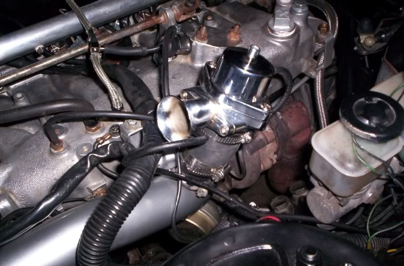

BleachZee Posted October 17, 2006 Share Posted October 17, 2006 Awesome! Good job on finding that leak. You also went from an auto to 5-speed swap in this process, right? So that alone will yield some better acceleration. I'm glad you're happy with it. so that BOV is working good for you? Quote Link to comment Share on other sites More sharing options...
AE2ZX Posted October 17, 2006 Author Share Posted October 17, 2006 Ya super stoked on it ...The bov sounds great ..I can hear it realy good . The turbo spool sound is even better ..Sounds like iam holding a crazy laser gun when i step down on her ....Then when i let off i here shshshsshsh .. Its not a loud shshshsshshsh more of a soft sound with hardness to it .... She is very consistent... I have driven her everywhere .I even went for a drive last night a 3:15am ... On waRM up even during hard driving , she does the same things Every time! Even air fuel stays very consistant ...Realy iam super happy with her .I cant beleave how fast she is .For sure shifting though the gears makes it alot faster ..I think this turbo garrett t3/t4 hybrid realy pushes her well very little to 0 lag if any at all , bam to 6psi if i push it all the way it jumps to 7 like it was already there , with intercooler on and 10psi . two words .GETTING SOME ! Iam beeming , so happy Thank U so much Bleach for helping me out .Your a true Player i was looking for info on my turbo i found this link . mines not red but that is it . http://www.saabperformanceparts.com/item111.htm Quote Link to comment Share on other sites More sharing options...
