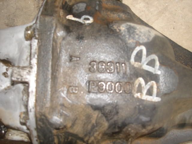

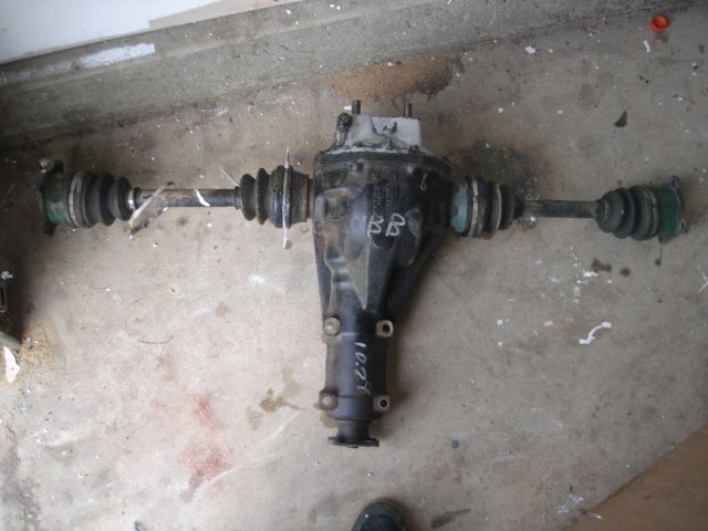

whoknowZ Posted February 20, 2009 Share Posted February 20, 2009 Ok fellas this differential is out of a late model 85 300zx turbo, with manual trans. Ive looked around and cant seem to find the gear ratio. any info if this will fit into a sieries 1 (s30) datsun z chassis? This image has been resized. Click this bar to view the full image. The original image is sized 640x480 and weights 153KB. This image has been resized. Click this bar to view the full image. The original image is sized 640x480 and weights 148KB. Link to comment Share on other sites More sharing options...
JMortensen Posted February 20, 2009 Author Share Posted February 20, 2009 Should be 3.70. You can pull the cover and check the ring gear if you want to be sure. It will say 37:10 somewhere on it. Link to comment Share on other sites More sharing options...
mcx Posted February 20, 2009 Share Posted February 20, 2009 i believe its a 3.55 open rear. Link to comment Share on other sites More sharing options...
reddzx Posted February 21, 2009 Share Posted February 21, 2009 http://www.az-zbum.com/information.differential.shtml 84-87 NA = 3.7:1 open 88-89 NA = 3.9:1 open 84-86 T = 3.54:1 open 87-89 T = 3.7:1 * clutch LSD 88 SS = 3.7:1 * viscous LSD Link to comment Share on other sites More sharing options...
