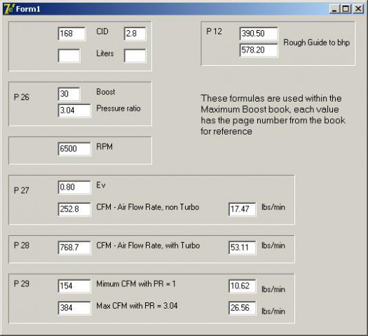

Noddle Posted October 17, 2006 Share Posted October 17, 2006 looks like the formulas are straight out of "Maximum Boost" book, I wrote this to help me do the same thing, pic included. added lbs/min Quote Link to comment Share on other sites More sharing options...

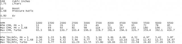

Noddle Posted October 24, 2006 Share Posted October 24, 2006 That page has misapplied those formulas for the reason Clifton hinted at. He has mapped a straight line from 20% at 1:1 PR, increasing in pressure ratio linearly to his `knee-point' where full boost is reached. It doesn't happen that way. Show me a T61-1 equipped L28 that will make positive manifold pressure at ~1300rpm (~20% redline) and 20psi by 3250. My GT35R (ball bearing, and smaller than a T61) has only JUST gone positive pressure by 3250 and 20psi isn't seen until 4500 or later. And, the increase in boost/PR with revs is not likely to be that linear. In short, a highly simplistic view of things, and not worth the electrons that were used to deliver it to you. Dave Is this what you are saying ?, not sure of the numbers though, since im new to turbos, i'm trying to get my head around it, I ploted the lines (roughtly) from these figures, (not sure if the will line up in here) 168 Cubic Inches 2.75 Liters 10 Boost 1.68 Pressure Ratio 0.80 Ev -------- 1000 1500 2000 2500 3000 3500 4000 4500 5000 5500 6000 6500 RPM 0.90 1.35 1.81 2.26 2.71 3.16 3.61 4.06 4.52 4.97 5.42 5.87 Mim lbs/min, PR = 1 2.26 3.39 4.52 5.64 6.77 7.90 9.03 10.16 11.29 12.42 13.55 14.67 Max lbs/min, PR = 1.68 4.52 6.77 9.03 11.29 13.55 15.80 18.06 20.32 22.58 24.83 27.09 29.35 Max lbs/min, Turbo Is this what you mean ?, that the turbo will not spool at the lower revs ? Quote Link to comment Share on other sites More sharing options...
