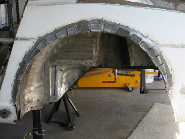

mclark999 Posted February 1, 2008 Share Posted February 1, 2008 Dan - Are you the one that wrote the thread on cutting out the fenders so you can put the wide body on without welding up the mess left behind? See the pictures below. Most people weld these, but either you or another experienced builder on this site gave a complete method for taping/bonding the fender back together. Quote Link to comment Share on other sites More sharing options...
Dan Juday Posted February 1, 2008 Share Posted February 1, 2008 It may have been me. That's how my car is done and I've done write-ups on that method here on hybrid before. There was a a nice long one that went into great detail and included pics but it was lost in the site change-over. That car in the pic you posted is not mine though. The way he did it he will not have the maximum tire clearance possible. I can tell this because the gaps in his tabs are too small. To get the maximum possible tire clearance you end up with pie shaped gaps between each tab that need to filled in later. Each wheel house consists of an inner and outer section spot welded together on a flange. To achive the maximum tire clearance the outer fender skin must be cut to a radius that matches the wheel house radius at that flanged seam. Then each slice of the outer wheel house must go almost to that seam, within a 1/4". Bend each "tab" out and fold it over the fender skin. Trim each tab so there is about a 1/2" overlap (like in the pic) and screw it to the fender skin with drill point sheet metal screws, two or three in each tab. What you have done is changed the shape of the outer section of the wheel house from a somewhat spherical shape to a cylindrical shape. Seal up the slots and gaps with foil backed butyl tape you get at the HVAC supply house. This stuff is pricy, about $25 a roll and you'll use nearly a whole roll on each side. Here is a pic of my cars fender after it was sealed up with the butyl tape. http://www.zparts.com/showcase/djudayv8proj/shoot2/pages/14DJ_R2_.htm About your hood breaking loose from the hinge. If it were me I'd use 3M's product for bonding steel to fiberglass first and then epoxy and glass mat over the top. To secure it while the stuff dries I'd run screws through the hood and into the steel hinge. This is the only way I see of getting a good fit without voids in the bond. After you're done bonding the hinge back on remove the screws and and fill and finish. JMHO Quote Link to comment Share on other sites More sharing options...

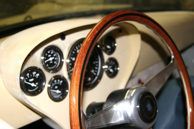

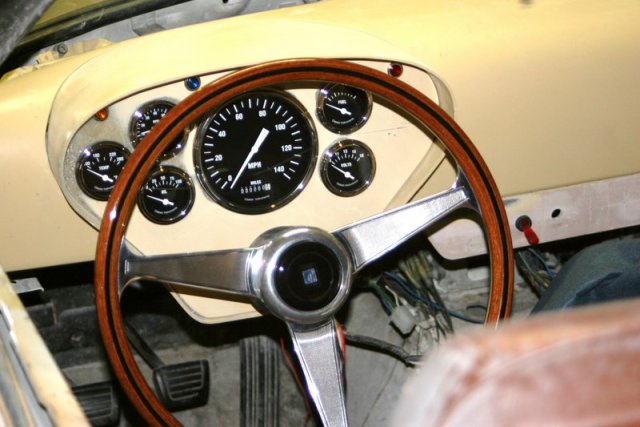

espeery Posted February 11, 2008 Share Posted February 11, 2008 I have been looking around for the right gauges that have the vintage race feel as well as gauges that resemble the original six gauge layout - one large gauge in the center and five smaller gauges. I decided to go with a 5" speedo in the center as opposed to the tach and five 2.25" smaller gauges. I drilled the holes and mounted the gauges in the removable Nacelle. Its taken me a lot of time to finalize the dash and gauge setup but I am happy with the results. Here are some preliminary photos of the fiberglass dash, gauges and Nardi steering wheel. I will be painting the dash crinkle coat black. I will also have a switch panel as seen in the pics which hangs from the dash. This panel will have the key ignition and various toggle switches. The only column switch will be the turn signal. The next step is to finalize the heater/fresh air dash vents. I took the car for spin the other day. That LS1 really moves! Quote Link to comment Share on other sites More sharing options...
Zerrari GTO Posted February 11, 2008 Share Posted February 11, 2008 espeery said: I have been looking around for the right gauges that have the vintage race feel as well as gauges that resemble the original six gauge layout - one large gauge in the center and five smaller gauges. I decided to go with a 5" speedo in the center as opposed to the tach and five 2.25" smaller gauges. I drilled the holes and mounted the gauges in the removable Nacelle. Its taken me a lot of time to finalize the dash and gauge setup but I am happy with the results. Here are some preliminary photos of the fiberglass dash, gauges and Nardi steering wheel. I will be painting the dash crinkle coat black. I will also have a switch panel as seen in the pics which hangs from the dash. This panel will have the key ignition and various toggle switches. The only column switch will be the turn signal. The next step is to finalize the heater/fresh air dash vents. I took the car for spin the other day. That LS1 really moves! That looks great! Thanks for the pics and please keep them coming as you progress. Quote Link to comment Share on other sites More sharing options...
