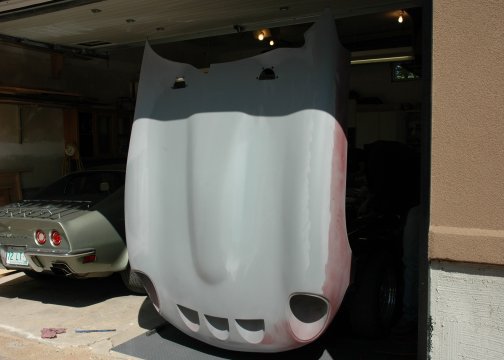

Con Brio Posted February 22, 2008 Share Posted February 22, 2008 Mudjr & Zerrari GTO, Thank you for the positive feedback. My apologies for not attaching more pics to my replies (there are a few more in my album). Once the hood is painted it will be complete. Then I'll work on getting more posted. On the topic of the hood (Vela Rossa style)...I sent an e-mail to John Washington re: "The hood hinge that seperated". An inspection of mine does not show any signs of seperation or fatigue and John has re-assured me it appears to be an isolated incident. Quote Link to comment Share on other sites More sharing options...

Zerrari GTO Posted March 23, 2008 Share Posted March 23, 2008 We had a couple of warm days here in Oswego, NY. Got the itch to start working on the VR again. I am too the point where I am ready to put the latches in the hood, I have Chrome pin latches, but they don't pull the sides of the hood close to car. I see that the old GTO's used straps, anyone got any ideas?? TIA. DJ Have you had any progress fitting the bonnet on your car? It looks as though mine will need some work too. The sides are sticking out a bit and it looks as though some work will be needed to make it fit properly -every F#@&*'in panel on my kit except the windshield cap has needed to be cut and refit so far . I started with a nice straight donner so I've been pretty disapointed with how the parts have lined up. If I can't get things the way I want them, I may consider a front end from one of the other GTO kits. Quote Link to comment Share on other sites More sharing options...
Con Brio Posted March 24, 2008 Share Posted March 24, 2008 Mine was bad too guys. I purchased the car already complete and the bonnet alone has without a doubt received the most attention during the rebuild (My car is a cross between an old Alpha kit and a newer VR front end). It's the only part of the car that is not finished. Still need to do final fit and then paint. I've had to modify the hood bracket. The "H" design was too weak and had too much flex for my liking. I re-designed it to be an "X". Offering much more strength. The back edge along the winsheild varied in thickness and needed to be trimmed then contoured to better fit the shape of the car. The underside just in front of the wheels also required trimming to avoid contact between the tires and just match up the two sides (a cardboard template worked great). And then I filled and block sanded, again and again and again... Other modifications, but not neccesary, include "D" holes for airscoops, raised centre to accommidate a higher intake madifold (Edelbrock Pro Flo EFI), mounting brackets for the hood latches (KingAir engine cowl latches). I also cleaned up the underside with two coats of undercoating and an aluminum heat shield for the engine compartment (too prevent the heat from warping the fiber glass and damaging the paint). Quote Link to comment Share on other sites More sharing options...
Zerrari GTO Posted March 26, 2008 Share Posted March 26, 2008 Mine was bad too guys. I purchased the car already complete and the bonnet alone has without a doubt received the most attention during the rebuild (My car is a cross between an old Alpha kit and a newer VR front end). It's the only part of the car that is not finished. Still need to do final fit and then paint. I've had to modify the hood bracket. The "H" design was too weak and had too much flex for my liking. I re-designed it to be an "X". Offering much more strength. The back edge along the winsheild varied in thickness and needed to be trimmed then contoured to better fit the shape of the car. The underside just in front of the wheels also required trimming to avoid contact between the tires and just match up the two sides (a cardboard template worked great). And then I filled and block sanded, again and again and again... Other modifications, but not neccesary, include "D" holes for airscoops, raised centre to accommidate a higher intake madifold (Edelbrock Pro Flo EFI), mounting brackets for the hood latches (KingAir engine cowl latches). I also cleaned up the underside with two coats of undercoating and an aluminum heat shield for the engine compartment (too prevent the heat from warping the fiber glass and damaging the paint). Thanks for the feedback and the pics. I need all the inspiration I can get...been getting a bit frustrated at my lack of progress lately. Quote Link to comment Share on other sites More sharing options...

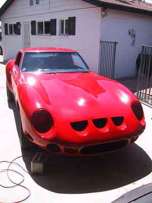

Duke Posted April 2, 2008 Author Share Posted April 2, 2008 Hello All, Been a while. Just finished the suspension and coil-overs on my car. Also have the rims and Hoosier tires mounted. Unfortunately (fortunately?) I have several other project cars competing for attention, hence the slow progress. Here's a preview... including my planned paint scheme. Quote Link to comment Share on other sites More sharing options...
Boy from Oz Posted April 2, 2008 Share Posted April 2, 2008 I have put the following together from a bit of research on the web. The text is mostly as stated on the web sites referenced and I cannot vouch for its accuracy. If people would like to add or correct any of the contents please feel free to do so: In 1978, Eagle Manufacturing Corp was established by Barry Goldstein (nee Merlin Coffano) to produce prototypes cars inspired by designs like the Ferrari Dino 246 GTS and later the Ferrari 250 GTO, Porsche Speedster, Cobra. Eagle’s first prototype (named Eagle GT1 then GT2) on a VW chassis was based on the Dino design and first sold to friends and associates and in 1980 Barry went public with the Eagle GT1. Over a 3+ year span, Barry created as many as 6 sets of moulds with different variations for the Eagle GT1, GT2, and GT. Some of the variations included modified bumpers from a ’67 Corvette Coupe, windshield swap from a TR7, a convertible top from the TR7, and numerous nose and rear end changes. During this time, Eagle Company employed 3-7 employees, depending on winter or summer months and, according to Barry, Eagle Manufacturing produced between 35-40 cars a year. Eagle Manufacturing also created a prototype car inspired by the Ferrari 250 GTO on a Datsun 240/260 Z. As many as 7 cars were sold as Eagle GTOs from late 1982 to early 1983. Sometime in late 1983, Eagle dealer Joe Alphabet purchased from Eagle Manufacturing the moulds and marketing of the Eagle GTO. Alphabet was well known in Southern California as a dealer of used, exotic Italian machinery. Apparently due to pressure from Ferrari, he decided to sell his replica car business to stay in their good graces and maintain a good working relationship. Alpha Design & Engineering closed the doors on manufacturing the Alpha 1 in 1989. Alphabet sold his business to Tom McBurnie. McBurnie Coachcraft produced a Corvette-based Daytona Spyder replica and the McBurnie ‘California 250 GTO’ became a complimentary product. However, again legal troubles with Ferrari and other problems would eventually drive McBurnie out of business for a period of time. He now operates as Thunder Ranch. Jim Simpson, formerly of Blue Ray GT Engineering was the next builder of GTO replicas. In addition to his extensive experience with restoration of esoteric (I think the writer meant 'exotic') sports cars, Jim brought a keen eye for detail to the production of his Rhino GTs. However, his desire to do more original design work led him to sell his tooling to Bill Cummings at Stable Autoworks in Dallas, Texas. Bill called his version the F-250. He built several cars before suffering an untimely death in November 1999 at the age of 42. Jeff Krekeler purchased the assets of Stable and operated it out of Missouri. About the same time as Jim Simpson was beginning his stint with the Rhino, John Washington of VR Engineering (a division of John's company Reaction Research) in Phoenix, Arizona began producing the Velo Rossa Spyder. While none of the Z-based cars could be considered true replicas of the GTO, because of dimensional differences, the Velo Rossa was a radical departure and virtually an original design. It was a roadster, with a trunk and a one-piece tilt-up front end (bonnet). The removal of the roof eliminated one of the strong design clues that gave away the fact that the underlying chassis was that of a Z car. If Ferrari had followed the path of rival Jaguar and produced a roadster or convertible version of the GTO, this is what it might have looked like. Possibly the best kit was developed by Tom Edwards of Scorpion Z cars. In January 2003 the following was posted on the HybridZ website; “my name is tom today i was told that my SCORPION GTZ was a topic of some discussion among some of you gto enthusiast,i own the silver and red horn striped car that has been in a few articles on the web ,this car is not a Puckertt at all ,i custom built a one off car using the front nose of a RHINO GT and my own hand built backend ,a simpson design dash,the most accurate dash i will say ,and then when the car was finished i built molds so i can start my own company selling the bodies and all the accessories to build a awesome car . i 'am not trying to advertise my company i just want everyone to know the proper information about my car. it is a "SCORPIONZCARS GTZ" that i built on a 1974 260z,425 hp chevy motor,t-5 trany,almost everything in it has been cusomizedâ€. Production of Scorpion GTZ kits was taken over by Oliver Meulbrouck at OM Sportscars Ltd in England in 2006. There have been a number of "one-off" GTO replicas produced, mostly on Datsun Z platforms. There have also been a number of replicas built on tube frames (Marauder), one on a 944 Porsche, and a cottage industry existed for a time producing GTO replicas made from modified 250 GTs, i.e. real Ferrari's re-bodied as GTOs! There has even been one such re-bodied Ferrari built as a convertible. Regarding Puckett - “Charlie Puckett was at one time employed by Tom McBurnie.He ran a few ads and came to only one show (of which I am aware) with several unfinished cars. His kits required a frame stretch and were longer between the firewall and the front wheels to make up the difference in wheelbase between the Z and the original GTO. I think he has been out of business for many years. In fact, I think I saw recently on another Hybrid forum an phone number from a classified ad some member posted for tooling for sale that sounded suspiciously like the Puckett stuffâ€. (John Washington, HybridZ Jan 03 - Puckett GTO) The only USA kits I can find advertised these days are the Spyder from VR Engineering, with a suggestion that the coupe is also available, and the Thunder Ranch coupe. However I suspect that it's a bit like OZ, with quite a few pirated moulds lying around the place. Bibliography http://www.reactionresearch.com/gtorr/index.html http://www.eaglegt.com/index.php?section=eaglegto http://www.zparts.com/history/articles/kit_history/articles/ If anyone has any other links to information could you post them. Quote Link to comment Share on other sites More sharing options...
Duke Posted April 3, 2008 Author Share Posted April 3, 2008 Nice history Boy from Oz I've yet to determine who was the manufacturer of my kit. Can you identify it from the front end? Duke Quote Link to comment Share on other sites More sharing options...
