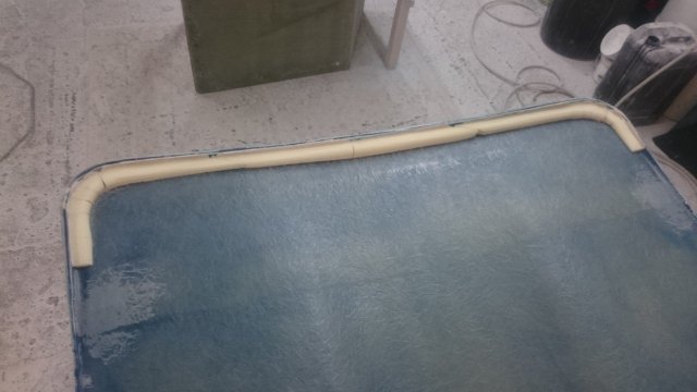

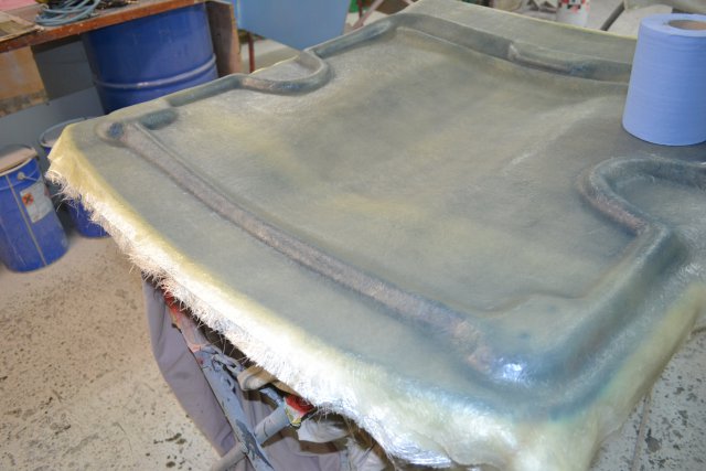

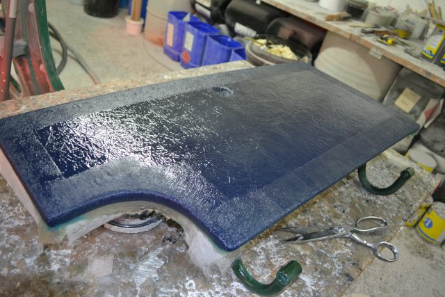

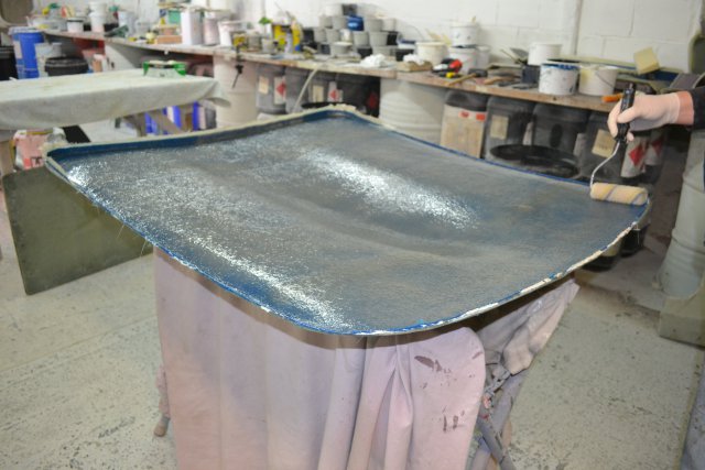

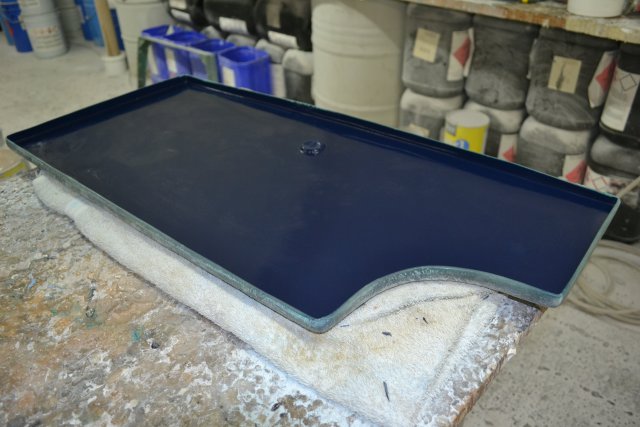

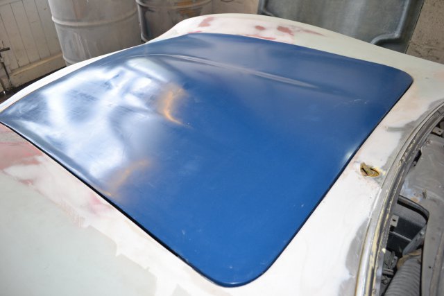

Jeff H Posted March 24, 2019 Share Posted March 24, 2019 We taped around the edges of the bonnet to stop the gel from creeping under and creating a mechanical lock, next we put what Lee called a skim coat of matting on, we also went round the edges with some tissue, this kept the edges from lifting. Quote Link to comment Share on other sites More sharing options...

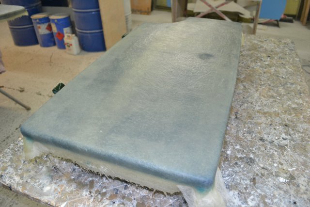

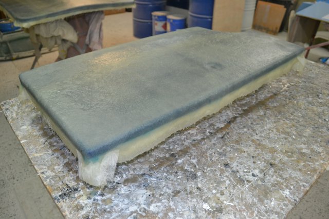

Jeff H Posted March 24, 2019 Share Posted March 24, 2019 This was left to dry for a couple of hours and we then put a further two coats of heavy matt on, 600 grams or 2 ounce . this is it once dry. Quote Link to comment Share on other sites More sharing options...

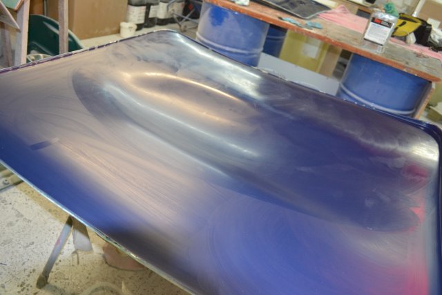

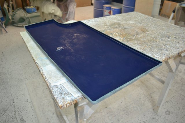

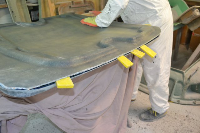

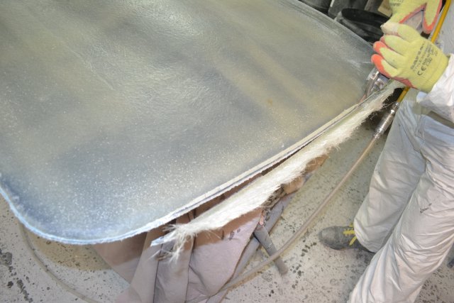

Jeff H Posted March 24, 2019 Share Posted March 24, 2019 Then the edges were trimmed back and the boot lid was pulled from the mould, we left the outer skin on the bonnet to keep some strength in it as we had to turn it over to take a mould from the inside of the bonnet. Quote Link to comment Share on other sites More sharing options...

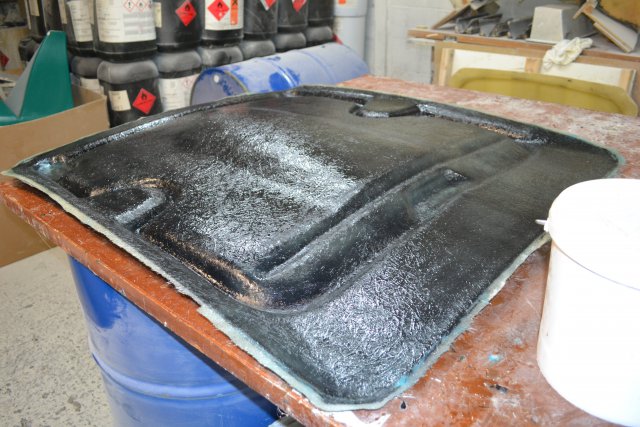

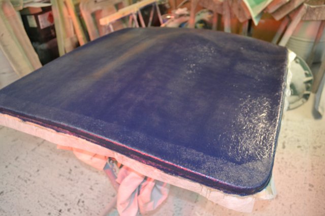

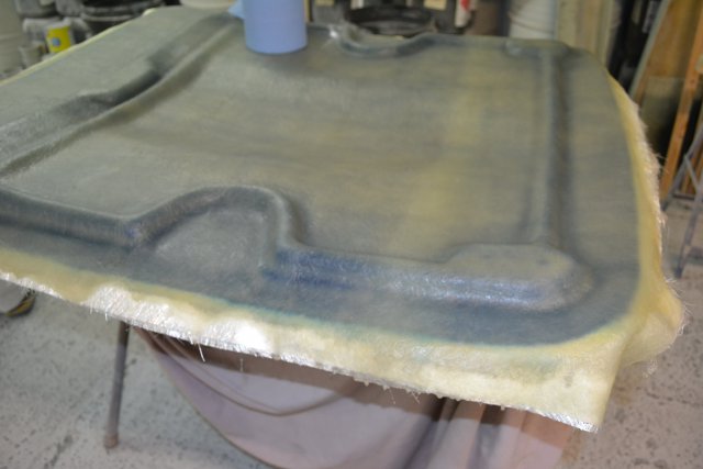

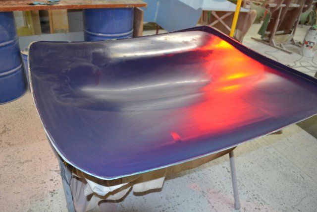

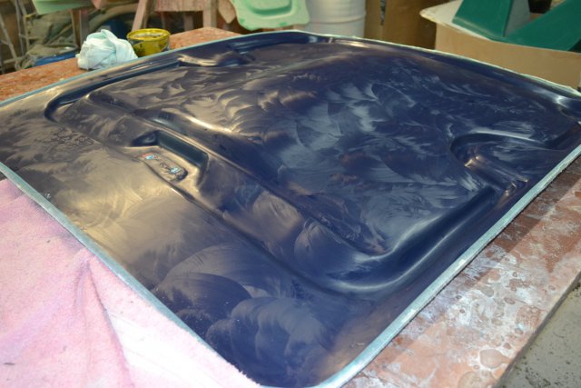

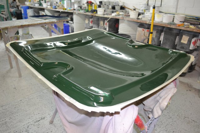

Jeff H Posted March 24, 2019 Share Posted March 24, 2019 We then moved on to the inside of the bonnet, it was of coursed waxed with the release mould wax, then gelled up, a skim coat of matt was applied and once dry a further two coats of heavy matt were applied. I missed the pics of the wax and gel process on these ones. Quote Link to comment Share on other sites More sharing options...

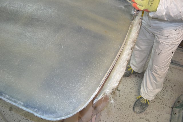

Jeff H Posted March 24, 2019 Share Posted March 24, 2019 We then cut around the edges to get both parts of the mould apart. we did use tape around the edge to stop a mechanical lock of the two moulds. Quote Link to comment Share on other sites More sharing options...

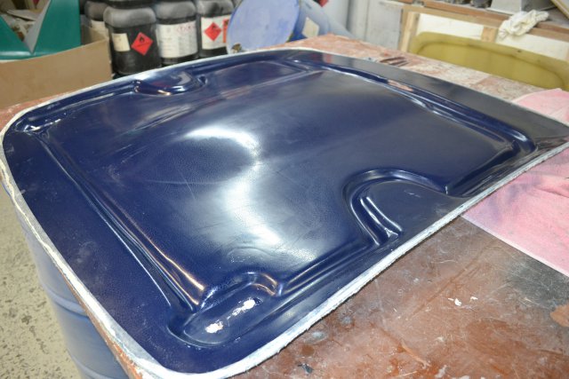

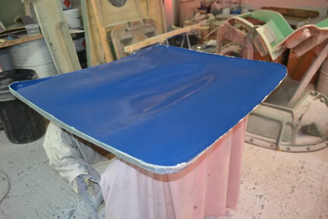

Jeff H Posted March 24, 2019 Share Posted March 24, 2019 (edited) So we now have three moulds ready for prepping to produce the new items. Edited March 24, 2019 by Jeff H Wrong pics Quote Link to comment Share on other sites More sharing options...

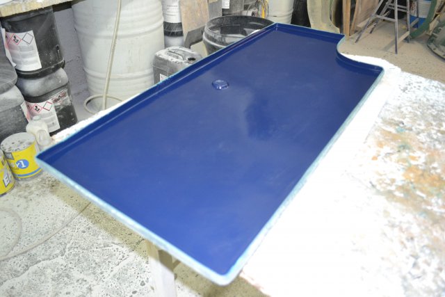

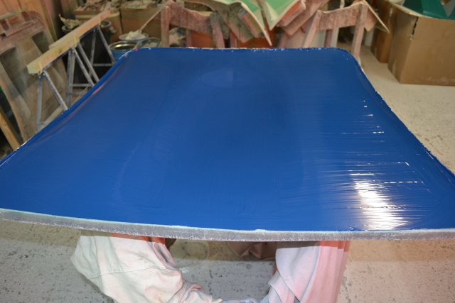

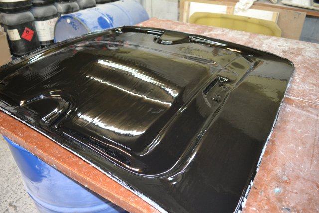

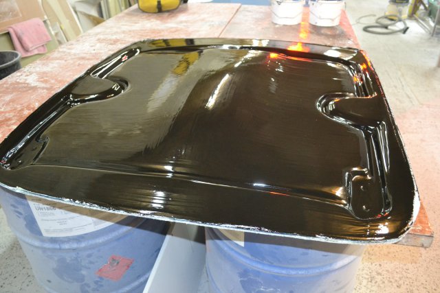

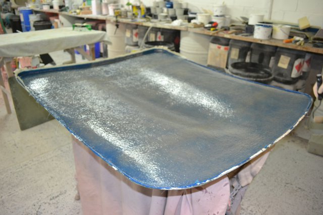

Jeff H Posted March 24, 2019 Share Posted March 24, 2019 These were de nibbed where necessary and waxed once again before being gelled and layed up, the inner bonnet only had one coat of heavy 600 gram matting, Lee thought this was ok as once bonded to the outer skin formed a nice light but strong finished piece. The outer bonnet and boot was layed up with two coats of the 600 matt. these pics are the inner skin. Quote Link to comment Share on other sites More sharing options...
Jeff H Posted March 24, 2019 Share Posted March 24, 2019 Same process for the outer skin, wax, gell and matting. Quote Link to comment Share on other sites More sharing options...

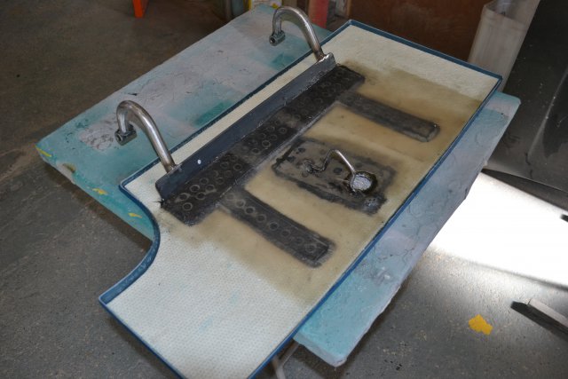

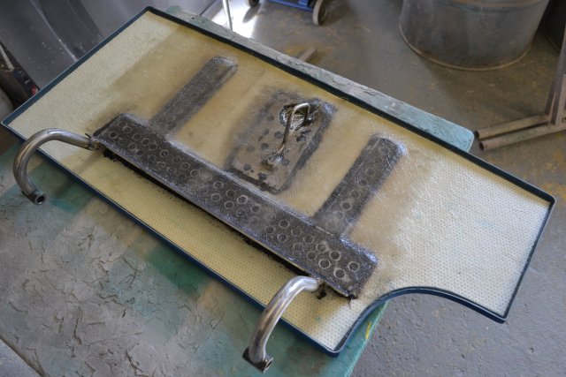

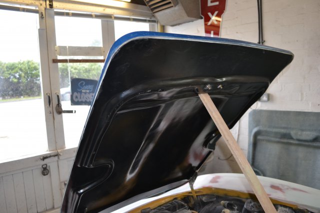

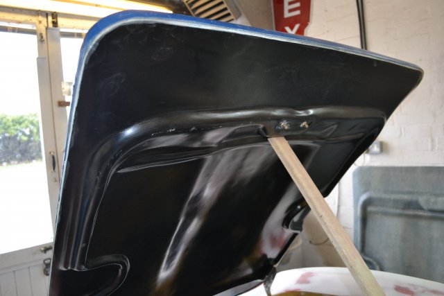

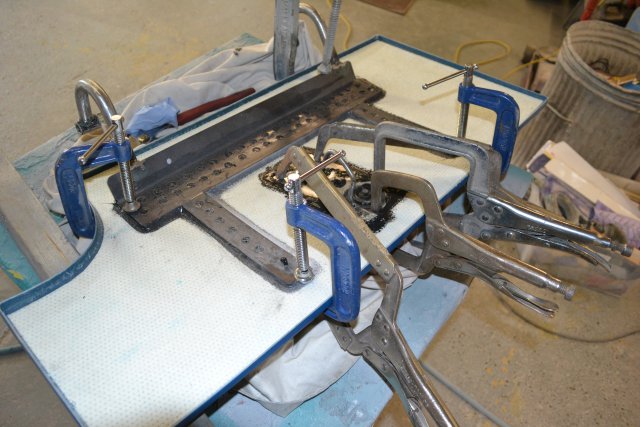

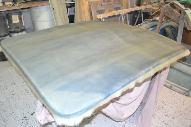

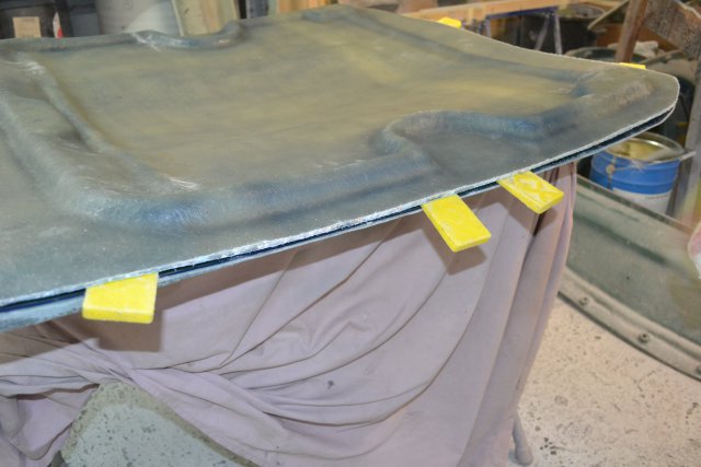

Jeff H Posted March 24, 2019 Share Posted March 24, 2019 I wasn't there when Lee released the bonnet from the mould, he sent me some pics of how he used some foam in between the two skins to stop it drumming, I also had some new stainless mounts made for the hinges and bonnet catch which Lee bonded in before bonding the two skins together for me. Quote Link to comment Share on other sites More sharing options...

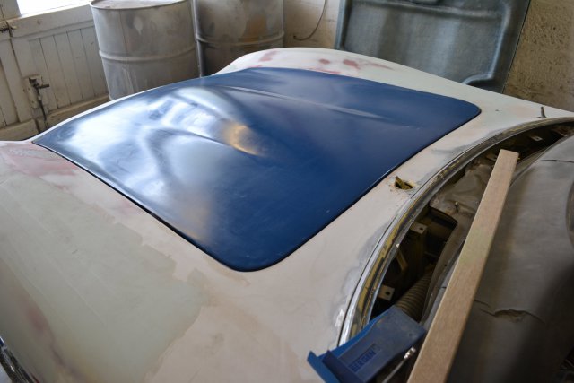

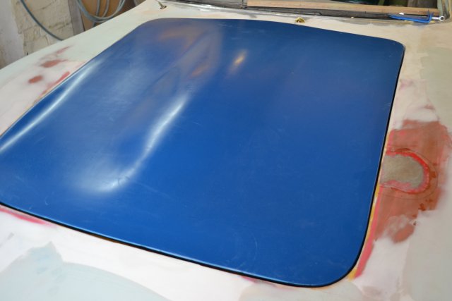

Jeff H Posted March 24, 2019 Share Posted March 24, 2019 This is the bonnet fitted to the car, the inner skin is not the greatest as the buck was pretty crap to be honest so it has a few ripples in it, I am very pleased with the outer bonnet, it fits well to the car and will only need a small amount of prep before painting. Quote Link to comment Share on other sites More sharing options...

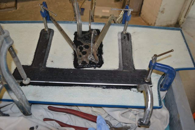

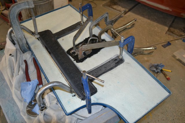

Jeff H Posted March 24, 2019 Share Posted March 24, 2019 On to the bootlid, I had another mate fold me up a bracket that I could bond and glass in to to the back of it, it is a bit heavier than I would of liked but I don't think it is going to come apart. Quote Link to comment Share on other sites More sharing options...
