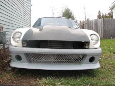

I just installed a new fiberglass airdam from Motorsport Auto (see link) on my 240Z. They recommend using a grille from a 260Z so that OEM T/S can be used. That's all well and good, but- I thought that this would be a great time to upgrade to something a little more in tune with the mod- maybe sequential LED's or something. I'm just having trouble finding anything.

this is what I did. I got some led turn signals from somewhere on line, but I don't remember where. Just some small amber LED lights. I covered the stock grill with the same type of wire mesh that is on the airdam. The lights are small enough to fit between the slats on the stock grill, and I covered them with tinted vinyl, to hide them (although it does cut down on their brightness quite a bit). I cut mounting holes in the mesh wire and bolted them onto the wire grill that overlays the stock grill.
(contrast and brightness added so you can see them)
