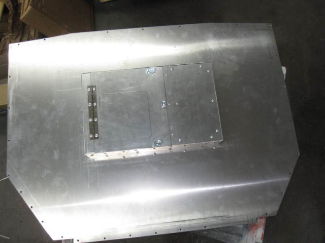

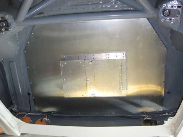

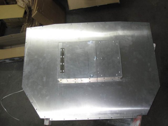

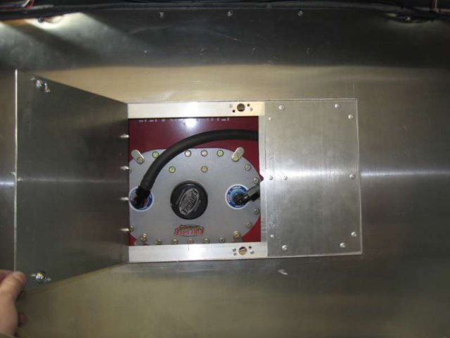

speed42 Posted February 26, 2007 Share Posted February 26, 2007 Jon - New to the site and to Z's. It has been a wealth of information. I went down a similar but slightly different path. I'm using the same fuel cell, but chose to mount it so that I could adjust the height and angle. I spent some time with the SCCA GCR and our local Midwest Council rules. 6 inches of clearence from the ground at ride height is required. Since I didn't have a lot of experience with these cars I thought adjustable was the best. I agree that getting hit in the rear would be an issue with this design. Just hoping that doesn't happen. I did add bracing at the lower edge of the rear valance and added a jack point for the rear of the car. Thanks for all the great posts and info. Don Quote Link to comment Share on other sites More sharing options...
JMortensen Posted February 27, 2007 Author Share Posted February 27, 2007 That's an interesting setup Don. Thanks for the pics, even if they're late for me they'll probably help someone else. Welcome to the site! Quote Link to comment Share on other sites More sharing options...
