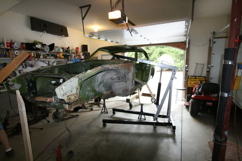

proxlamus© Posted May 4, 2011 Share Posted May 4, 2011 I used jack-stands.. a jack and 4x4 posts and a engine hoist I would lay a 4x4 post horizontally under the chassis (so drivers to passengers side) jack up the car, mount the stand. Lower the jack, insert another 4x4 post, raise the car, mount the stand, lower the jack, insert another 4x4.. etc. I used an engine hoist attached in the rear to support the car in the event of an emergency. Quote Link to comment Share on other sites More sharing options...
