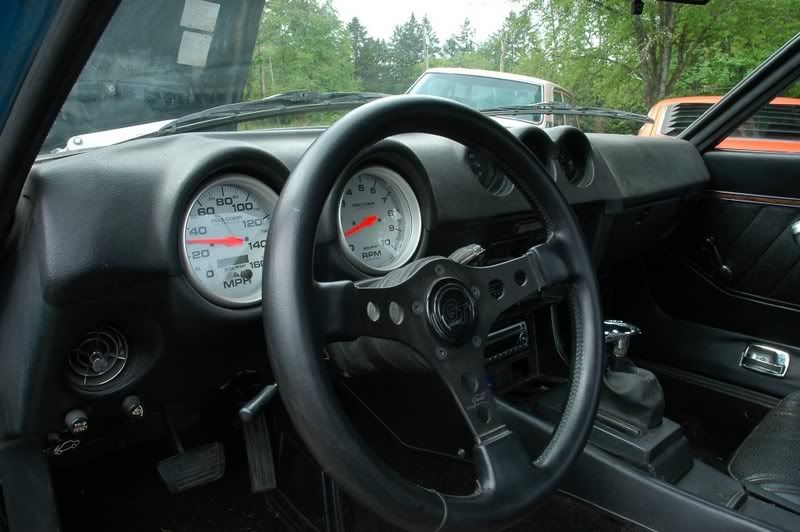

gretchen/jason Posted May 16, 2007 Share Posted May 16, 2007 Oh man i got the big tach 5 inch is it from autometer . So i took out the stock tach but left in the spacer/beauty ring the black plastic thing that spaces the tach back from the dash . So what i did is this is cheap duct tape the tach to this peice . It covered the face perfectly nobody noticed or could even see the tape . It even had the controlls for for setting rpm limits . Granted it set back about 1/2 inch further then the tach but still looked good it is a autometer sport tach large size . No pics sorry . Jason Quote Link to comment Share on other sites More sharing options...
Administrators RTz Posted May 16, 2007 Administrators Share Posted May 16, 2007 Autometer Sport-Comp and Pro-Comp should both 'fit'.... Quote Link to comment Share on other sites More sharing options...
HICKL Posted May 16, 2007 Author Share Posted May 16, 2007 Autometer Sport-Comp and Pro-Comp should both 'fit'.... Is that a 5"? Quote Link to comment Share on other sites More sharing options...
Administrators RTz Posted May 16, 2007 Administrators Share Posted May 16, 2007 Is that a 5"? Yup. Quote Link to comment Share on other sites More sharing options...
Teekass Posted May 17, 2007 Share Posted May 17, 2007 Autometer Sport-Comp and Pro-Comp should both 'fit'.... Wow, so the 5" gauges fit....they look great. Nice steering wheel too, btw. My car will be a straight line car, but it will still have a Momo steering wheel.....can't beat the way they feel, can ya? Quote Link to comment Share on other sites More sharing options...
Administrators RTz Posted May 19, 2007 Administrators Share Posted May 19, 2007 "BrianV8Z" stopped by a couple hours ago. He retro-fitted Pro-comp "Ultralights"... Quote Link to comment Share on other sites More sharing options...

IdfMF Posted May 22, 2007 Share Posted May 22, 2007 HICKL, I went with a Stewart Warner 3 3/8" Maxium Performance tach. I had to remove the clear plastic cover and fab a plastic ring which is glued to the stock bezel and holds the tach in place. I like the 3 3/8" guage because it puts the face of the gauge in the basically the stock position. I think the 5" gauge sits too close for my liking. PM me if you would like some photos. Tom Quote Link to comment Share on other sites More sharing options...
Bartman Posted May 22, 2007 Share Posted May 22, 2007 Autometer Ultra-lite 5" in-dash tach #4498 fits perfect. Quote Link to comment Share on other sites More sharing options...

Forces Posted May 24, 2007 Share Posted May 24, 2007 Bartman, I have seen that photo before, the gauge combo looks awsome, good work. Thanks for posting up the part number on those. Did you end up using the 'optional' LED lights on the speedo and tach? I too have wondered about turnsignal indicators.... Quote Link to comment Share on other sites More sharing options...
Bartman Posted May 24, 2007 Share Posted May 24, 2007 Bartman, I have seen that photo before, the gauge combo looks awsome, good work. Thanks for posting up the part number on those. Did you end up using the 'optional' LED lights on the speedo and tach? I too have wondered about turnsignal indicators.... The Autometer LED's are really expensive. I went with some that I got of eBay for about two bucks each and I think they are the same one's that Autometer sells for a lot more. I got a few small lights from Pep Boys that I installed in the dash between the Speedo and Tach for my brights and turn signals (you can't see them in the pic because it's dark and they're not lit). Hopefully I'm not over-posting the pic. Quote Link to comment Share on other sites More sharing options...
