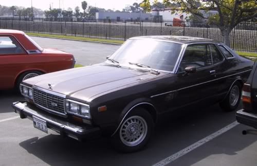

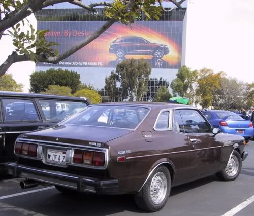

S30TRBO Posted June 16, 2007 Share Posted June 16, 2007 I have come to the realization that the 810 does not want to leave me or in other words I can't sell her because only I can appreciate her good looks. Anyway, so the girlfriend and I have been wrenching on her to get her road worthy and then she pipes in "let’s make it a sleeper". Why did you go and have to say that using my inside voice. It couldn’t have been blurted out at a worse time as my 240Z turbo is nearing motor completion. However, it’s always good timing because it's never too late to start planning for the “next†project. The Question: What motor will propel this “sleeper†down the road? Requirements: We want to have about 300-450rwhp. (Keep in mind the current L24E is front sump.) I have thought of the following: (couldn’t get the poll function to work) • L28ET • LS1/LS2 w/ 6 speed • RB2xDExx • 2JZ GTE • VH45DE • VK56DE • Any other Ideas I need some ideas please. What will get me to the HP goal with the least amount of dough spent, I know easier said then done. This is merely designed to brainstorm with my fellow Hybridzers and to shed some light and ideas on this! So far we are thinking: • Old school hot rod flat black paint job • Over fenders • 280ZX rear disc conversion (I need 280ZX complete rear suspension) Here are some pics of her: Quote Link to comment Share on other sites More sharing options...

S30TRBO Posted June 17, 2007 Author Share Posted June 17, 2007 What exactly does "sleeper" mean to you and your GF? Pass a cursory external inspection by someone who doesn't know what they are looking at anyway, pass a cursory external inspection by someone who DOES know what they are looking at? Pass both external and underhood inspection by someone who doesn't know what they are looking at, or pass an underhood inspection by someone who should know what they are looking at? I would have to say it will have a definite external visual inspection. By sleeper we mean to have something nasty under the hood with a classic hybrid hot rod look from the outside. IMHO the 810 is not that well known although it has an L24E in it, which is really a 240Z/280ZX on a hardtop body. I just want people to look at it and say "Wow! Look at that thing, all blacked out, lowered with this huge exhaust. WHAT IS IT?" When the die hard V-8 guys say “Look at that Ricer POS,†and the GF cracks into it so at the next light as they are picking their jaws up off the floor, we can look over and smile. Sleeper is one thing but we are building it for our enjoyment and others surprise. So your choices as I see them are Honda engine with a straight pipe (using the G-force tranny to convert a B-series honda motor to RWD configuration), possibly a toyota motor with a straight pipe (has the advantage of already being RWD in many applications), or you could do the ultimate: the Mazda rotary. I would have to disagree with a Honda motor, only because my first choice would be to use something from the Nissan/Infiniti family. Then once those are exhausted, go to something proven such as a Toyota or GM power plant of course not knocking Honda or the others. Funny you mentioned a Mazda Rotary. My buddy just bought a 1985 GSL-SE w/ 80K original 13B. He owned the similar car 10 years ago and bought from Mazda a brand new 13B. To this day it is still bagged up and he never put in his SA but sold it instead. This could be another possibility. rice-can clamped on at a jaunty angle being held up by a coat hanger would be perfect. Then you find some wider than stock steel wheels that you can put grippy tires on, and get like 3 of those chrome trim rings that simulate a polished lip but leave the fourth one off. Oh, and get a type-r badge for the back. Just make sure it's seriously fast before you do all that... I don’t think I would want to “rice†the 810 out in any aspects. Sleeper is one thing, ricing it out is a totally different bag of Uncle Ben’s. And THAT's how you build a sleeper. My definition and your definition of a sleeper have two different meanings. I still want mine to look cool, albeit with the Type R badge it would look even cooler. I would rather have people comment “Wow, whatever it is, it looks cool and shits and gets too.†I guess I could take it to the rice route and put some Pep Boys 14†spinners, Type R badge, “cold air†intake and a set of General tires. Not to mention loading the underside up with neon and capping it off with a F40 wing. Chances of this happening were better 18 years ago, today highly unlikely. lolol Quote Link to comment Share on other sites More sharing options...
