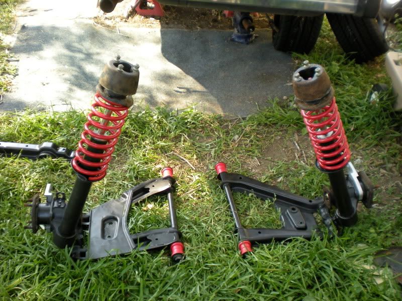

91_4x4runner Posted June 12, 2009 Author Share Posted June 12, 2009 I've passed one year and 8 months on my project now. A car that I bought for 800 bucks turned into a multi-thousand dollar project that will probably never end. The initial phase of "get back onto the ground with a few new things" is done. Summary: Suspension, brakes and drivetrain (including all mounts) have been stripped down to the metal and repainted with a bunch of parts replaced in-between. Issues: One of my bolts is broken that holds the rear A-arm to the chassis. I'm going to borrow a buddy's tap set today and fix that up since a screw extractor is nowhere near strong enough to get the job done. Here's a few more photos. It sure doesn't look like alots been done, but man I've poured some sweat and blood into this car's underbody... 17x8.5 Rota RB-R's with Yokohoma S.drive 225/45R17's Stuffing the tire with the floor jack to check clearances (looks like it clears by about a 1/2 inch) My enthusiasm in 100 degree weather... (The calipers were installed just after) Glamour shot: First time she's had a shoe on since I bought her... I'll take some photos of the drivetrain and suspension in a bit. The progress sure doesn't show from the outside of the vehicle Hope y'all like it... Quote Link to comment Share on other sites More sharing options...

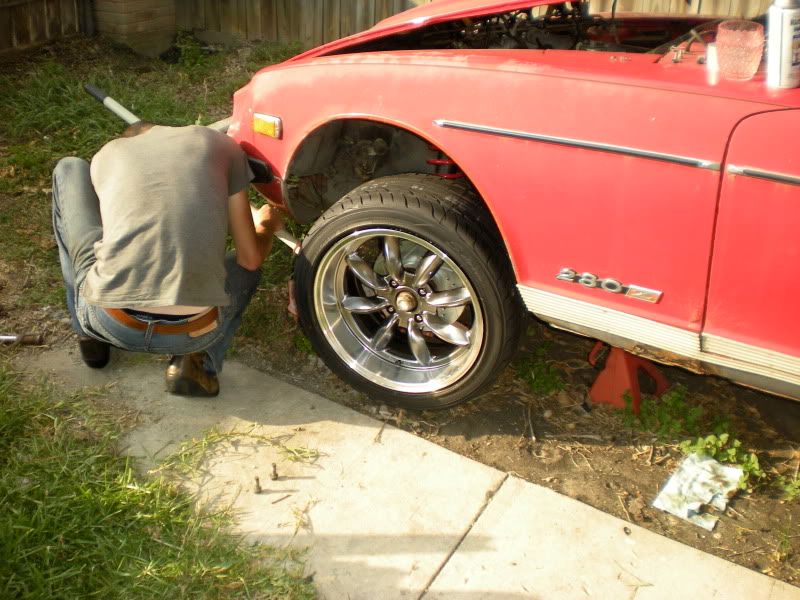

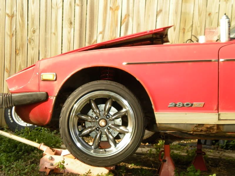

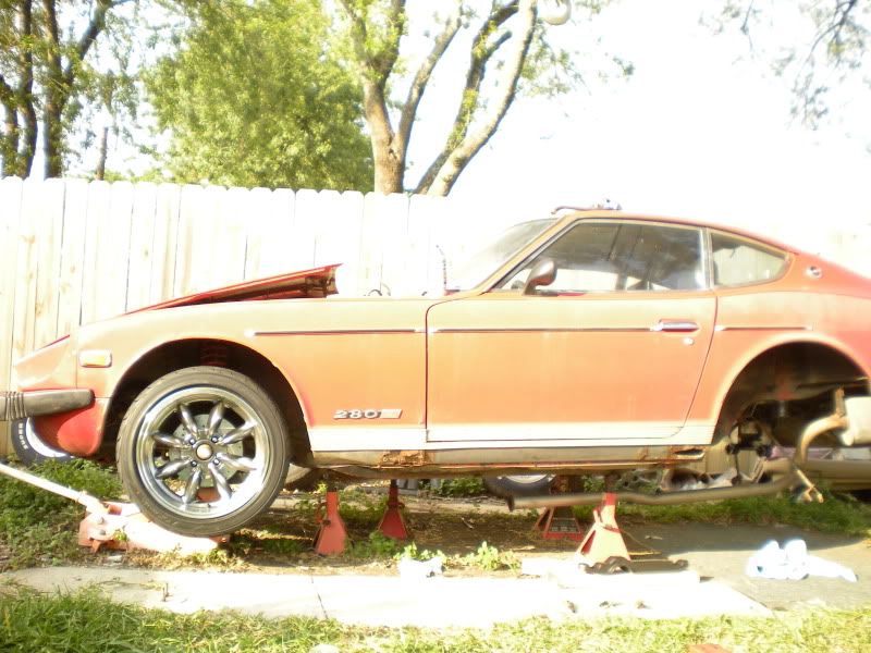

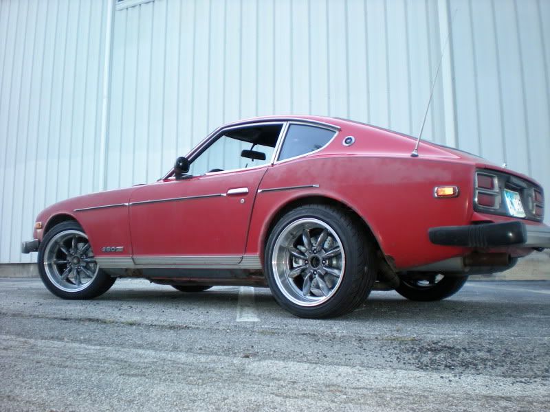

91_4x4runner Posted June 22, 2009 Author Share Posted June 22, 2009 Today has to be one of the best days I've had since I bought my car. For the first time, she got off the jackstands and stood on all fours. With her rebuilt suspension, new brakes and Yokohama shoes. There's still alot more to be done, even under the car, but man, I don't think she's ever looked better. Mmmmmmmmmmmm...... Pics to follow... Quote Link to comment Share on other sites More sharing options...

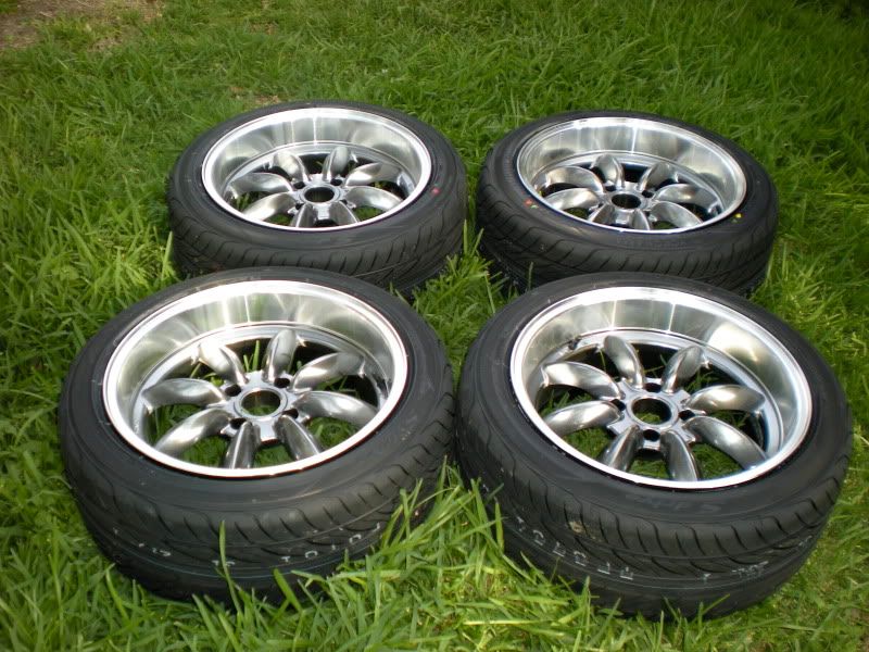

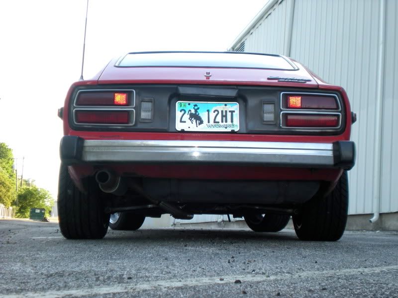

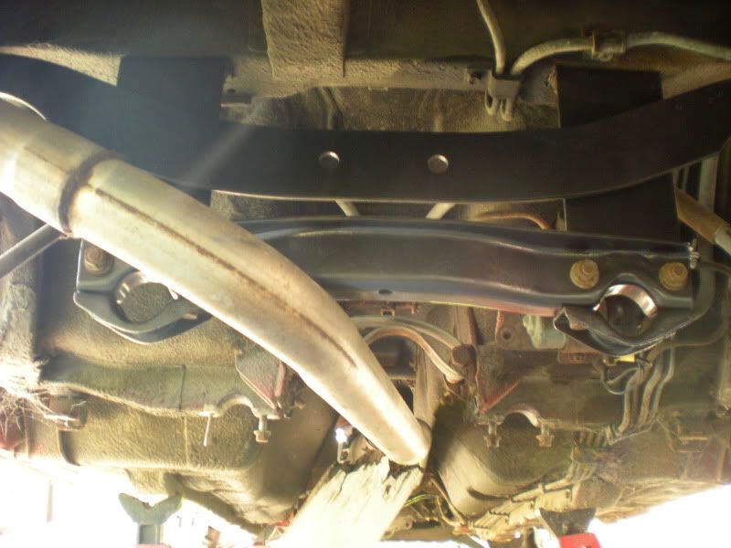

91_4x4runner Posted June 23, 2009 Author Share Posted June 23, 2009 The painted underside that nobody will ever see... The suspension that nobody will ever see... The view that everyone WILL see... Some guy with a huge damn grin.... Glamor shot... Highlight on the Rota's... Nice @ss... Hope y'all like 'em... Quote Link to comment Share on other sites More sharing options...
19762802+2 Posted June 23, 2009 Share Posted June 23, 2009 I think I'm going to buy those rims..someday haha, but those look amazing on there great choice! Quote Link to comment Share on other sites More sharing options...
srbigbutt Posted June 23, 2009 Share Posted June 23, 2009 Your Z is looking pretty good now. How is the fit on the Wheels? I know mine were a tight fit. But damn they look good!! Your pics make me want to go out in my garage and clean up all the brake dust on them right now!! haha. I see that view with a guy with a huge grin all the time. (When I pull up next to SUVs with shiney reflective paint, glass buildings, etc!!!) Quote Link to comment Share on other sites More sharing options...
91_4x4runner Posted June 23, 2009 Author Share Posted June 23, 2009 (edited) Thanks man... As it turns out, I do have a slight issue with rubbing the front lower valence panels when the wheels are turned. It doesn't seem like it'll take more than a half inch of grinding to fix, but its just another thing to do. I went with 225/45R17 tires with these rims. In retrospect, I would've almost rather had a little bit taller tire. These rims look mean with some real rubber around 'em. Regardless of the aforementioned, I almost couldn't be any happier with my suspension/brake/wheel rebuild.... EDIT: I should also mention that today marked the second time that I've ever sat in a Z that was on the ground (the previous being when I bought mine). It feels spectacular. I'm looking forward to my first time driving a Z more than ever. Edited June 23, 2009 by 91_4x4runner Addition Quote Link to comment Share on other sites More sharing options...
