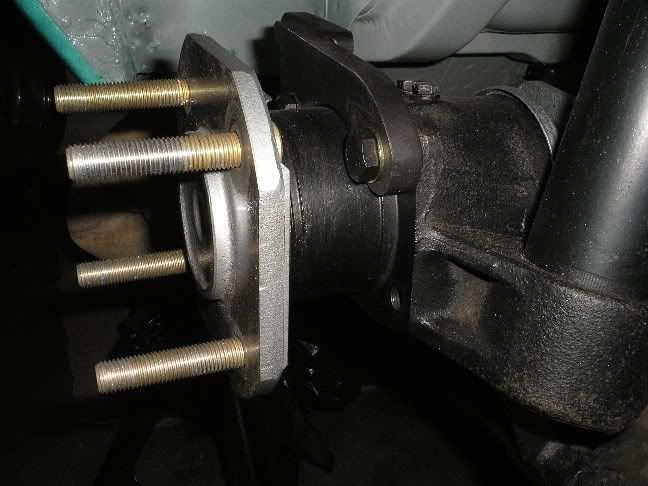

Dragonfly Posted July 24, 2007 Share Posted July 24, 2007 I had a caliper bracket like that on my Z, so I put my longer studs in when I swapped rear wheel bearings. The bracket doesn't need to attach to all 4 bolt holes like that though. If you look at Ross's brackets or AZC's brackets, they only attach to 2 or 3 holes. You can grind the bracket down for clearance (just do it opposite where the caliper is) or you can pull the stubs. The 12mm Camaro/RX7 studs fit the hubs without having to redrill or anything, so that part is as easy as it gets. Using the studs Jon is talking about (I used them on my car) you can since you have a disk brake set up (it is easier to pull the brake rotor) rotate the stub axle and there is a spot at about the 5 'O'clock position were the stud will just barely fit into the hole without having to pull the shaft. I then used a brass rod to tap each stud into place, then put the wheel on and tourque each lug nut take the car up and down the block jack it back up and re-torque each lugnut to insure all the studs are pulled up tight. One other thing to mention about the longer studs... you have to use open lug nuts with them, if your lugs have chrome caps or ends on them you will either mess up your lug nuts or not get them tightened properly (most likely). My studs stick out about 1/4" past the end of my long lug nuts (I chucked all my lug nuts up on a laithe and drilled out the ends so the studs go through). Here is a pic of mine with just the longer studs, I don't have any pics of the modified lug nuts. Dragonfly Quote Link to comment Share on other sites More sharing options...
Bartman Posted July 24, 2007 Author Share Posted July 24, 2007 Thanks for the pic Dragonfly. My brake caliper bracket goes all the way around the hub, but as Jon mentioned I can grind the bracket enough to allow access for installing the longer studs. I cancelled the order for the 15 mm spacer with the studs attached and placed a new order for longer studs, and I already have open ended lug nuts. Once the new studs arrive I can remove old one's, install the new one's, and play around with spacer thicknesses. I'll keep the spring off and use washers to determine the optimal thickness of spacer that will allow clearance throughout the wheels travel range. Quote Link to comment Share on other sites More sharing options...
