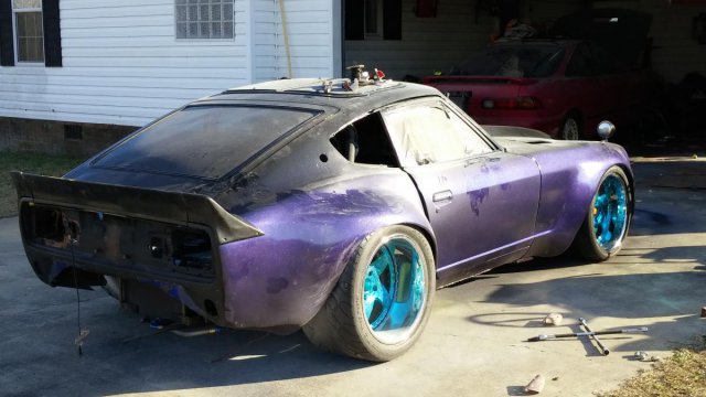

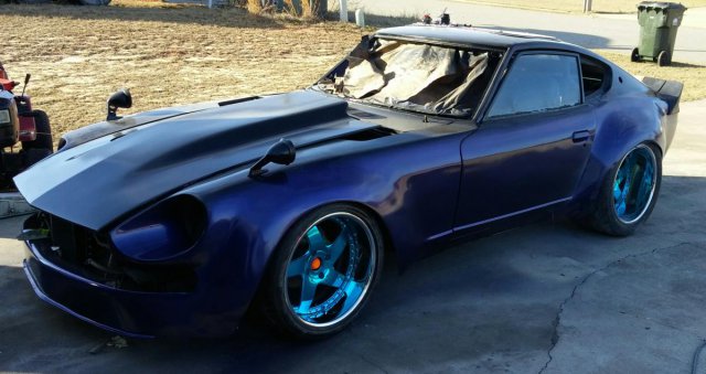

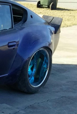

gunsaler111 Posted January 10, 2015 Share Posted January 10, 2015 Finally replaced the steelies.... 18x10/18x12. 4.5 backspace Quote Link to comment Share on other sites More sharing options...
Dat Z Sun Posted January 10, 2015 Share Posted January 10, 2015 Thanks for your help R3VO 3VOM. I'm working on trading a Power FC I Have for some 17x9 +12's. Hopefully he bites so I can post em up! Quote Link to comment Share on other sites More sharing options...
gunsaler111 Posted January 12, 2015 Share Posted January 12, 2015 Installed them today. 18x10 with 285/30 18x12 with 345/30 4.5 " backspace. Car has wide body and Ground control coil overs... Quote Link to comment Share on other sites More sharing options...
texis30O Posted January 12, 2015 Share Posted January 12, 2015 @ gunsaler111 Who did you order the wheels from? What motor mods? Quote Link to comment Share on other sites More sharing options...
gunsaler111 Posted January 12, 2015 Share Posted January 12, 2015 The wheels are by avant garde, model f233. It's a 400 block with a 327 crank. Solid roller setup,85 mm turbo with 100 shot... Quote Link to comment Share on other sites More sharing options...
