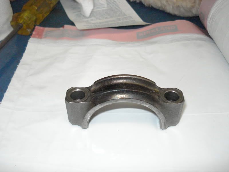

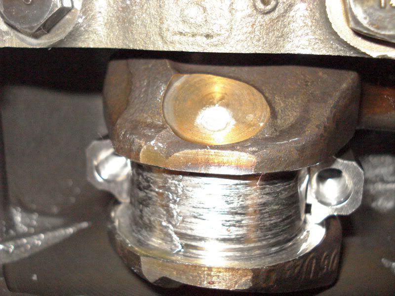

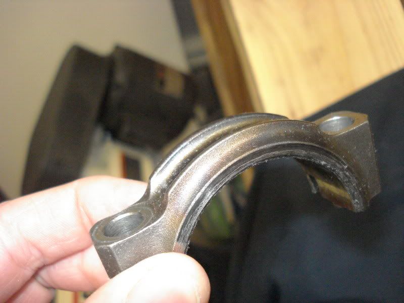

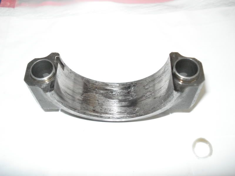

stony Posted April 23, 2008 Author Share Posted April 23, 2008 Well i was going to keep it quite but no use in that. We spun a rod bearing. I'm guessing the long downtime contributed to. Maybe on initial startup the bearing was damaged and it just started to deteriorate till it let go. SOOOOO the final run it made a hair over 600 again but that point is mute. Still no video ;< anyways... anyone have any experience with turning the rb26 crank or is one of those things were once it's hurt its done. Anyone have a r33 crank lying around they want to get rid of? check out the pics. everything else looked fine except the #1 crank journal and rod. The other thing was when the rod bearing came apart it clogged the filter and that caused the filter to collapsed on it self internally and bypassed all the oil back into the engine. So the engine basically has to be completely torn down And cleaned. Not exactly what i wanted to be showing off but here is the carnage. Quote Link to comment Share on other sites More sharing options...

RB26powered74zcar Posted April 23, 2008 Share Posted April 23, 2008 Wow Stony, that sure bites the big one... did it give any indication it was going south? Was it up on song when it let go? I know its like talking about a loved one dying right away, but can you give us some details please... I'd say that you will most definitly have to take every single piece and part apart, and clean/flush all the bearing material for those bad boy parts to be safe to reuse. Did it starve the top end at all? I really hate to see that your expensive Jun head, cam journals got buggered... I really really hate to hear/see this my friend.... Just keep your head up and get to fixing.... thats all we can do when crap like this kicks us in the knuts.... Quote Link to comment Share on other sites More sharing options...
dr_hunt Posted April 23, 2008 Share Posted April 23, 2008 Oh my friggin god!!!!!!!!!!!!!! spun a rod is an understatement! What were the bearing clearances anyway? Did any of the cylinders get scored? That crank might be saveable hard to tell without mic'ing it. IMO I'd get a new crank, new rod and start from scratch. Check the clearances or grind and set the clearances. Also, IMO if your going to resize one rod, might as well do them all so the center to center length stays the same for the set of rods. Quote Link to comment Share on other sites More sharing options...
fentin_fury Posted April 23, 2008 Share Posted April 23, 2008 I can't believe the lack of luck you have had! It doesn't look like it got hot - no indication of blue in the pics. I will make some calls on a crank. Q Quote Link to comment Share on other sites More sharing options...

stony Posted April 23, 2008 Author Share Posted April 23, 2008 fentin_fury said: I can't believe the lack of luck you have had! It doesn't look like it got hot - no indication of blue in the pics. I will make some calls on a crank. Q If you look right on the edges of the crank journals you can see some discoloration. Quote Link to comment Share on other sites More sharing options...
