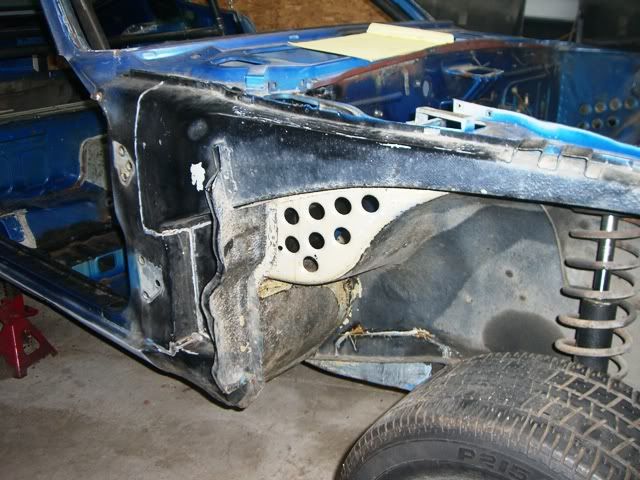

bjhines Posted November 15, 2007 Share Posted November 15, 2007 Im using 1970s Camaro fender vents on the fenders as well. I have not installed those yet, I am still open to other options. A recent pic of the punched and flared holes. Quote Link to comment Share on other sites More sharing options...

JMortensen Posted November 15, 2007 Share Posted November 15, 2007 Fender vents should be functional without a duct to the engine compartment. They'll vent pressure from inside the fender well. The vent would be better placed directly above the tire, but the way the Z fender is shaped they should still be functional where you have them. My take: vent the fenderwells out the fenders, vent the engine compartment out the hood. Limit the air going into the engine compartment, limit the air going under the car. Quote Link to comment Share on other sites More sharing options...
Challenger Posted November 15, 2007 Author Share Posted November 15, 2007 Well what my plans were is to block off the radiator opening, and then do the same thing Bjhines did. With the front blocked off will there be enough pressure in the engine bay to vent out the fenders? Or would it be best to mount vents on the top of the fenders similar to the Dodge Daytonas? The problem Im seeing is the inner fender plastic liners. Would you cut those? Quote Link to comment Share on other sites More sharing options...

MrFancypants Posted November 16, 2007 Share Posted November 16, 2007 Forgive a possibly noobish question, but what do you use to punch those holes? A hole saw? Seems they are recessed a little on one side. Dragonfly, your side vents look great! - Greg - Quote Link to comment Share on other sites More sharing options...

Dragonfly Posted November 16, 2007 Share Posted November 16, 2007 Forgive a possibly noobish question, but what do you use to punch those holes? A hole saw? Seems they are recessed a little on one side. Dragonfly, your side vents look great! - Greg - Thanks. I personaly used a 1" hole saw but what I wanted to use and would recomend is a hole punch (I think thats what it is called). A hole punch uses two pieces and a bolt, you drill a small hole that the bolt can fit through then you put the die piece on one side and the punch piece on the other side of the panel, put the bolt through the two pieces (and the hole you drilled for it in the panel) then tighten the bolt, it pulls the punch piece through the sheet metal and into the die piece cutting a perfect hole. The flaring of the hole is done in a similar process as above but the pieces create a flare rather than a hole, the flare increases the strength of the metal at the point were the hole is so that you have not degraded the strength of the part/panel. I should have probably mentioned that my vents orriginated on an 81 Camaro. Dragonfly Quote Link to comment Share on other sites More sharing options...
Challenger Posted November 16, 2007 Author Share Posted November 16, 2007 BJhines were did you buy your "hole punch"? Does anyone know the amount of space on a 280z behind the inner fenders? Is it enough for a vent? Quote Link to comment Share on other sites More sharing options...
