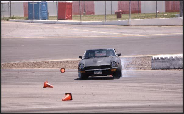

Tx1021 Posted December 7, 2007 Share Posted December 7, 2007 Theres a member on here, don't know his screen name though, that drifts his S30. Hopefully he will see this and chime in. Heres a pic from a drift event this summer. I'm riding shotgun Quote Link to comment Share on other sites More sharing options...

Tombarace14 Posted December 7, 2007 Share Posted December 7, 2007 I think youre talkin about driftz240 Im pretty sure he sold his Z and went semi-pro or pro. Quote Link to comment Share on other sites More sharing options...
