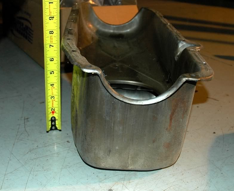

Searchy Posted January 31, 2008 Share Posted January 31, 2008 That crank pully at 11" is I believe about the same distance that a SBC has, Actually, a SBC is about 7 1/2". That hole is getting awfully deep Quote Link to comment Share on other sites More sharing options...
Six_Shooter Posted January 31, 2008 Share Posted January 31, 2008 Actually, a SBC is about 7 1/2". That hole is getting awfully deep So if that were true, which I think it is higher myself to the bottom of the sump, not just the front of the pan, that means the the Scooby engine is then mounted higher than the SBC, in relation to the crank center line, and having even less "lowering of the center of mass" It may even end up at the same hight as other engines. Quote Link to comment Share on other sites More sharing options...

Six_Shooter Posted January 31, 2008 Share Posted January 31, 2008 That is precisely the problem, Six... your statements are a bit empty. We'd all be happy to entertain your thoughts, but you need to give us some firm ground. Cool it's been a while since I've played with a SBC, and realize that I was thinking more of the deep sump pans than the stockers. But the fact still remains that the Scooby engine in question has 11" between the crank center line and the bottom of the stock oil pan. I don't know if the Scooby pan can use a short sump or not, if it can, then yes the center of mass could be lowered, if not that it would have to remain in this example 3 and a half inches higher than an L6 or SBC, due to ground clearance of the oil pan. I can see where you're coming from, as far as needing to back statements up, but this stuff isn't new, I've been reading and experiancing it for a number of years. If I wanted to I could go through a few books I have, and quote them, but most have either been borrowed books, magazines that have been long thrown out, or talking with people I know that are very into chassis design, besides the things I have tried, not all have worked, and have been told that some shouldn't work, but have worked for me. Like very stiff sway bars that I was told would make the car "skip" accross the road surface, when it actually made my car at the time, though still ill-handling (it was a FWD, I hate FWD) in my eyes much more predictable, and easier for ME to put through a corner. Now many people are actually making almost solid (as in very little twist) sway bars and anti-roll bars. I just find it very odd that people here have "experianced" or read differently. Quote Link to comment Share on other sites More sharing options...
