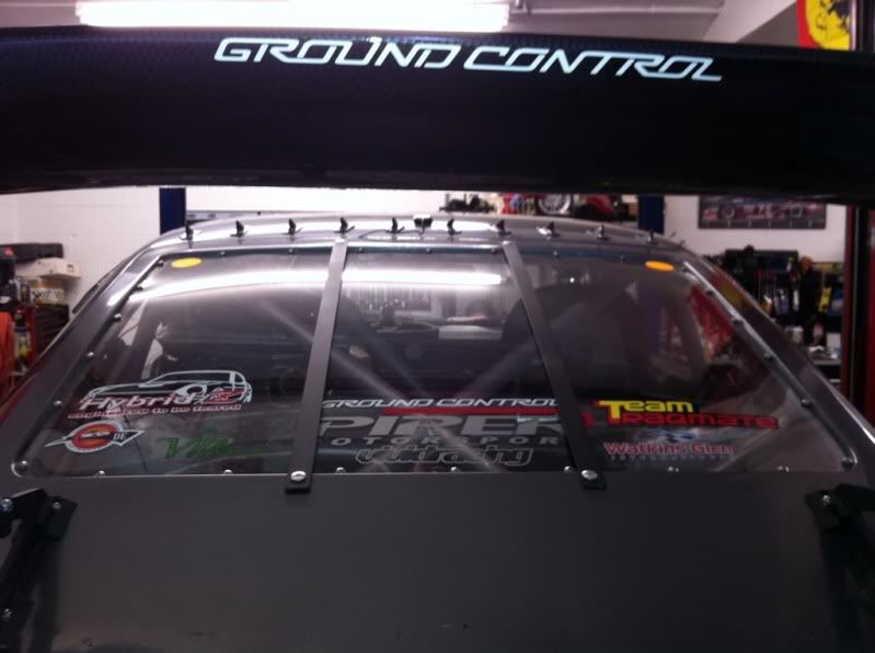

Mikelly Posted August 3, 2011 Author Share Posted August 3, 2011 This evening I installed the turn signal lights in the front MSA Type3 bumper, replaced the carbon fiber uprights with 1/8th inch aluminum T6061 versions that allow less (ie NO) movement of the rear wing. Also sorted the rear swaybar link hardware. Coleman racing has 7/16th endlinks that thread right into the female versions sent with the AZ Zcar control arms. So next I'm going to resolve the rear 1/4 window mounts and look at the height of the pins on the hood. Also plan to finish up a few more aero tricks on the car...Knocking the list down little by little... Mike Quote Link to comment Share on other sites More sharing options...

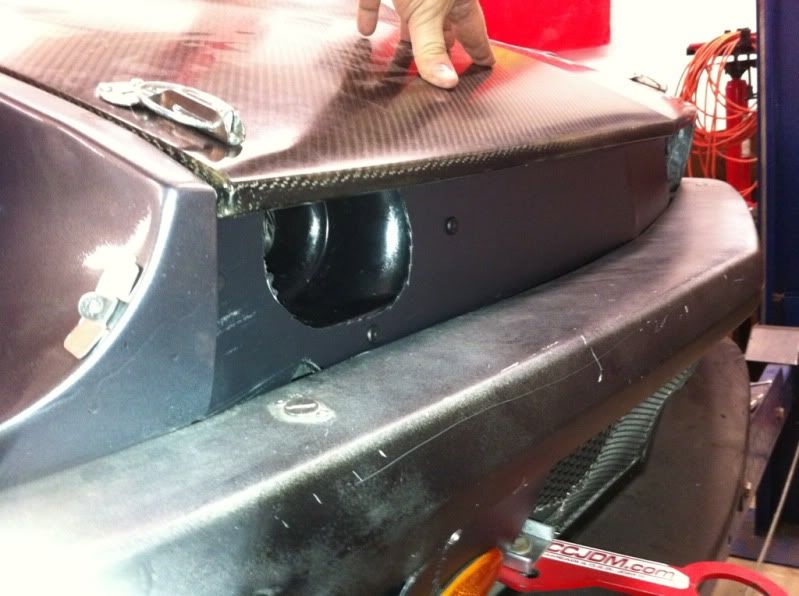

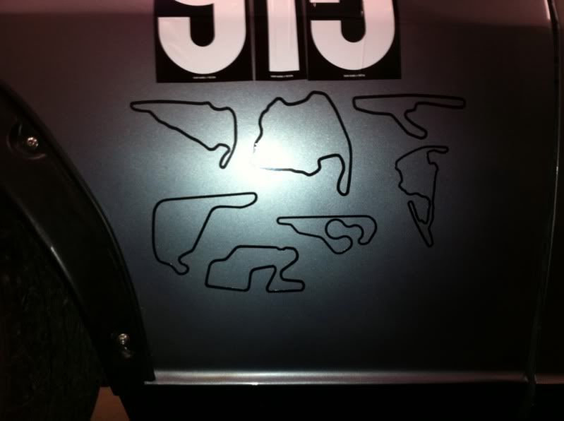

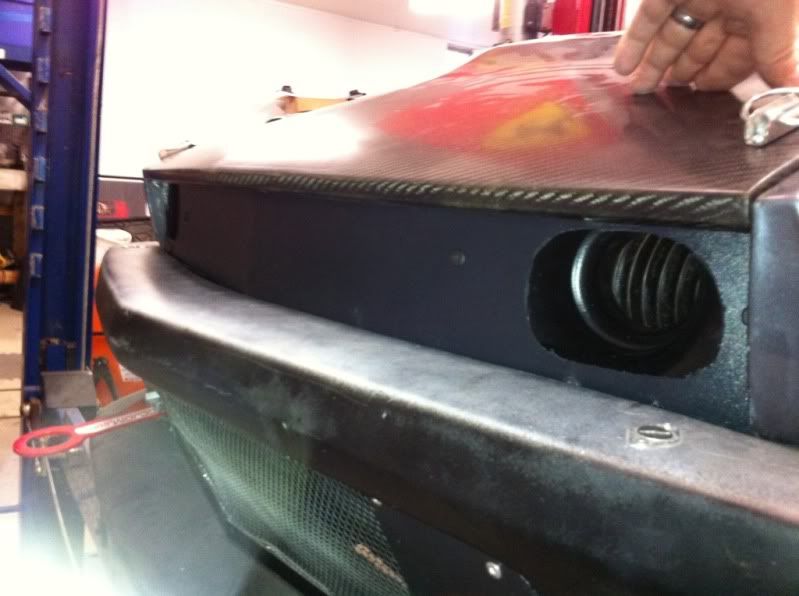

Mikelly Posted August 6, 2011 Author Share Posted August 6, 2011 So today I needed some distraction from the loss of my dad, and I ended up back in the shop tinkering, as he would've done. This panel will get cleaned up and wire mesh over the openings for the intake airbox ducts: I also dug out my decals/stickers and applied a few... Nipping away at the list of things left, slowly but surely... Mike Quote Link to comment Share on other sites More sharing options...

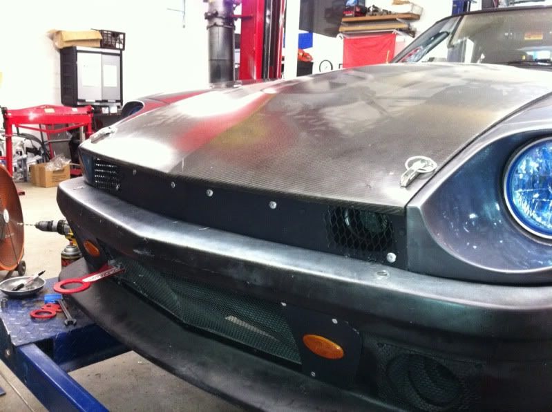

Mikelly Posted August 8, 2011 Author Share Posted August 8, 2011 Finished Product on the underhood blockoff/carb airducts: Pretty happy with it... Mike Quote Link to comment Share on other sites More sharing options...
Evan Purple240zt Posted August 8, 2011 Share Posted August 8, 2011 Mike, are those tow hooks removable and where did you get them? Sure would make life easy next time my heap breaks on the strip. Quote Link to comment Share on other sites More sharing options...
Mikelly Posted August 8, 2011 Author Share Posted August 8, 2011 Evan, I got them from ZCC! http://www.zccjdm.com/catalog.php?ref=azcarbum&recview=1&dt=93256&disp=name&per=10 Mike Quote Link to comment Share on other sites More sharing options...

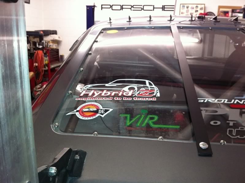

Mikelly Posted August 14, 2011 Author Share Posted August 14, 2011 So this afternoon I got a little bit more done on the car... I welded in an o2 bung for tuning. I'll be having a dyno/Tuning session on Friday. I also addressed a leak at the Speedo gear, which just cropped up during today's drive... strange... And I started fitting the lexan/naca ducts into the 1/4 windows. Still have a few more things to wrap up before the Glen. Must admit, it was a very cool drive today in the car... Mike Quote Link to comment Share on other sites More sharing options...
