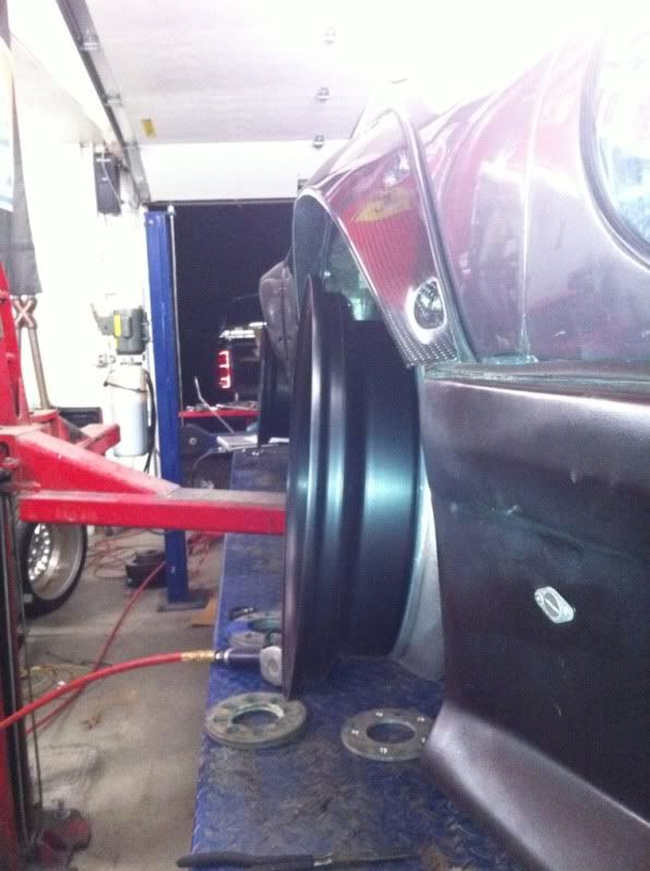

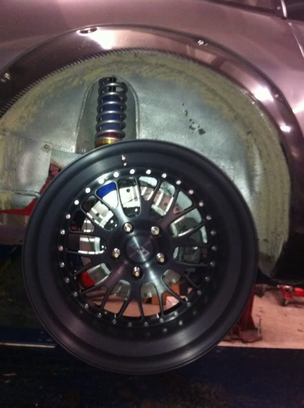

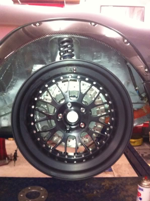

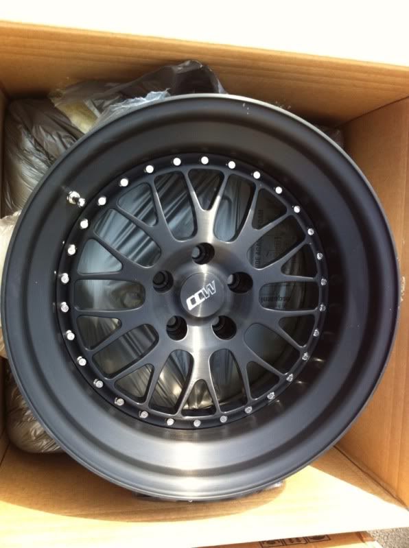

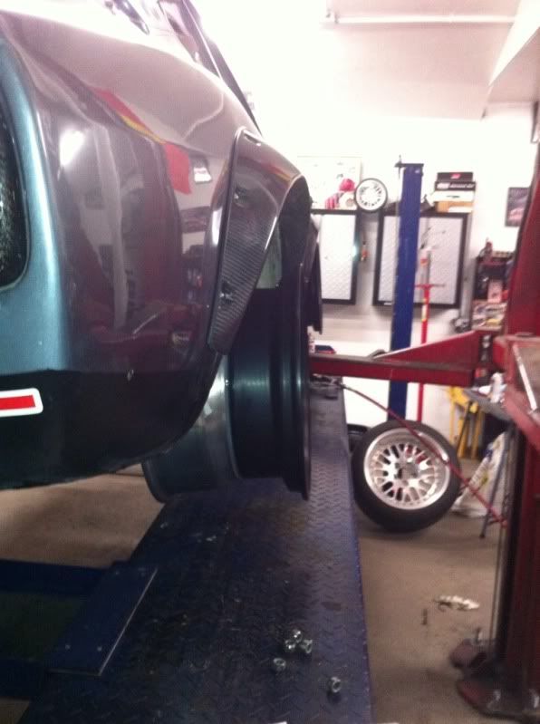

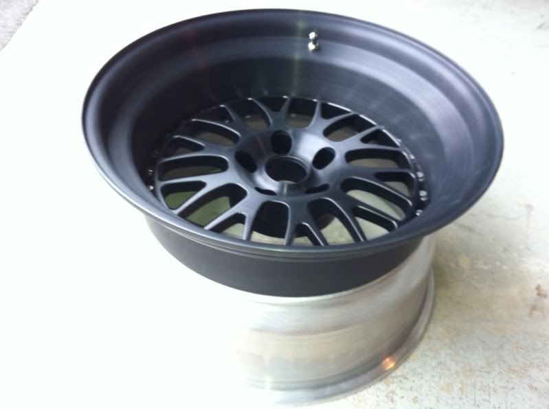

The anodized coating is amazingly durable... Love the look and can't wait to mount up my Hoosiers!!! And because I know some will ask.. 10X18 front and 11.5X18 rear...
From the rear
From the front
Rear Side View
Front Side View
Other shots
White specs on the pics are from the foam packing...
Edited by Mikelly
